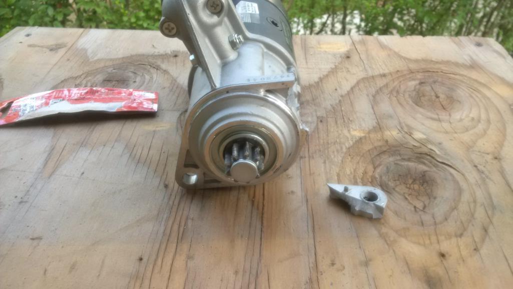

When we first energized the starter it would rotate the engine. Periodically there would be load CLANKS which would freeze the starter. The kind people in this forum suggested a new starter. NP, got a new one.
The second starter also CLANKED and then Broke! Ear came off of one of the mounts (see pic).

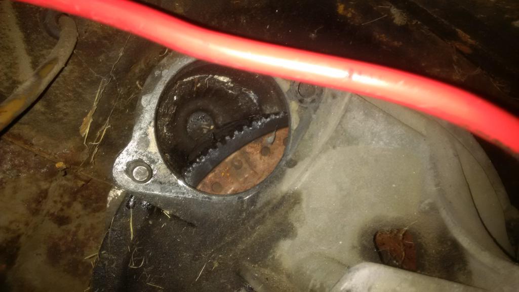

Pictures of the Broken Starter and the Flywheel teeth

It might just be your fuzzy pic, but that flywheel looks like someone took a grinder to it. Clear pic of the teeth please?

QUOTE(The Cabinetmaker @ Aug 18 2018, 02:41 PM) *
Will do - grease is in the teeth in the pic - all are in very good shap
76-914
post Aug 18 2018, 03:09 PM
Posts: 13,786
Joined: 23-January 09
From: Temecula, CA
Member No.: 9,964
QUOTE(The Cabinetmaker @ Aug 18 2018, 01:41 PM) *
Curt, left click on that pic and a duplicate will come up. Click on the "+" magnifying glass then you can expand greatly. (IMG:style_emoticons/default/beerchug.gif)
