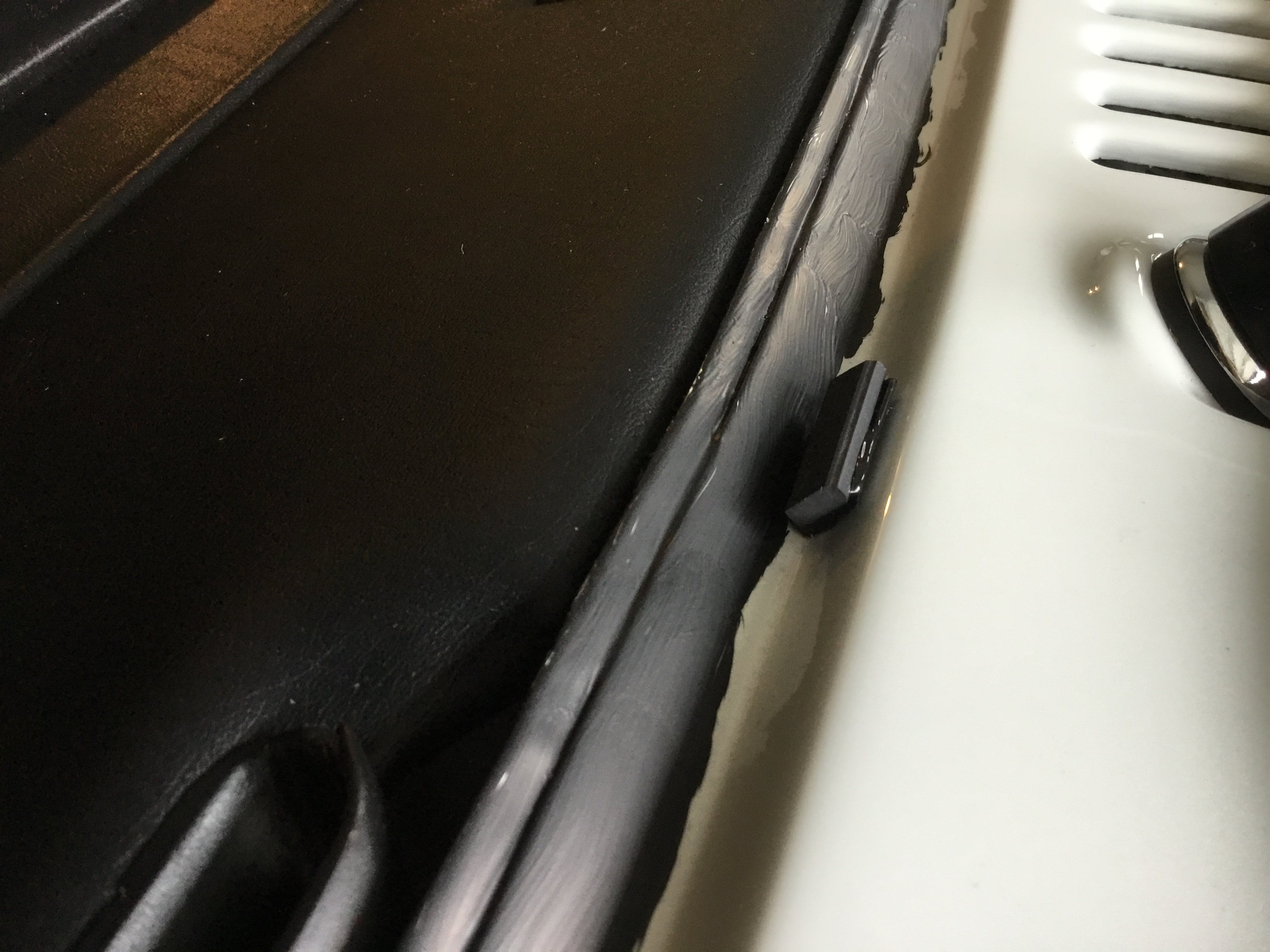

My solution to where to place the rubber standoff blocks is as follows.
I cut each my blocks into 3 similar length sections giving me 6 total.
Then I placed/glued them on top of the trim clips.
This will give me the exact standoff distance I needed, with the added bonus of not getting in the way of the windshield trim installation.
So there will be 6 of these small blocks sitting on top of the trim clips all along the bottom of the windshield.
More than enough to do their job.

I truly believe that windshield will keep you in the car....but I'll depend on my seatbelt to take care of that task.
The seal that goes between the windshield and the dashboard was easily pushed into place after the windshield was installed.
I didn't do it before the glass install as it seemed that it would make it harder to push the windshield down into the butyl on the lower edge of the glass.
