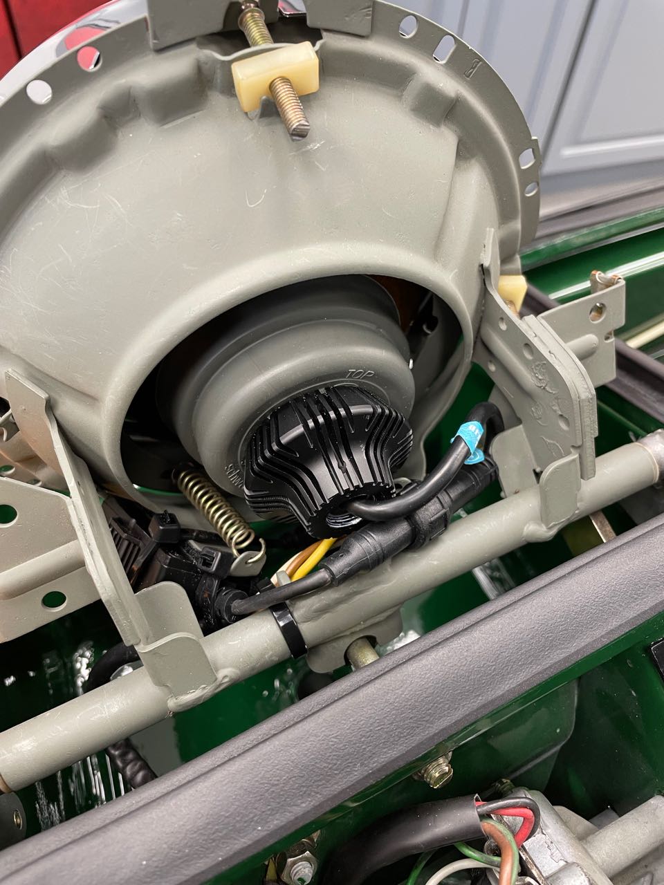

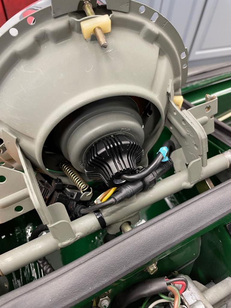

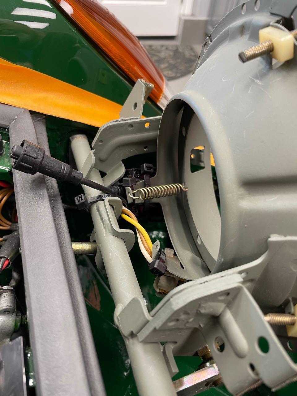

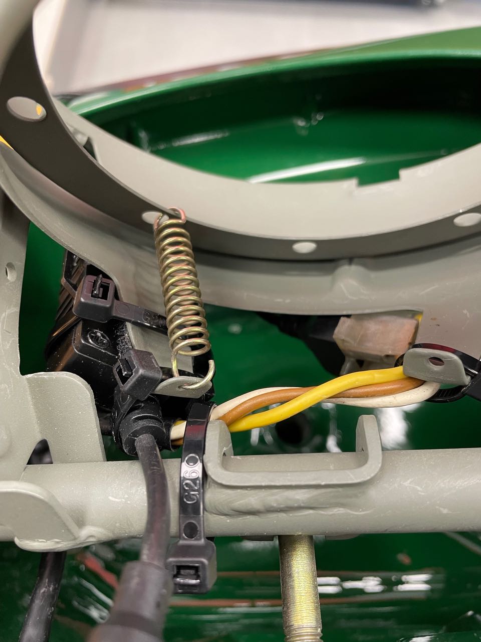

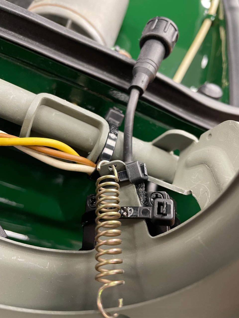

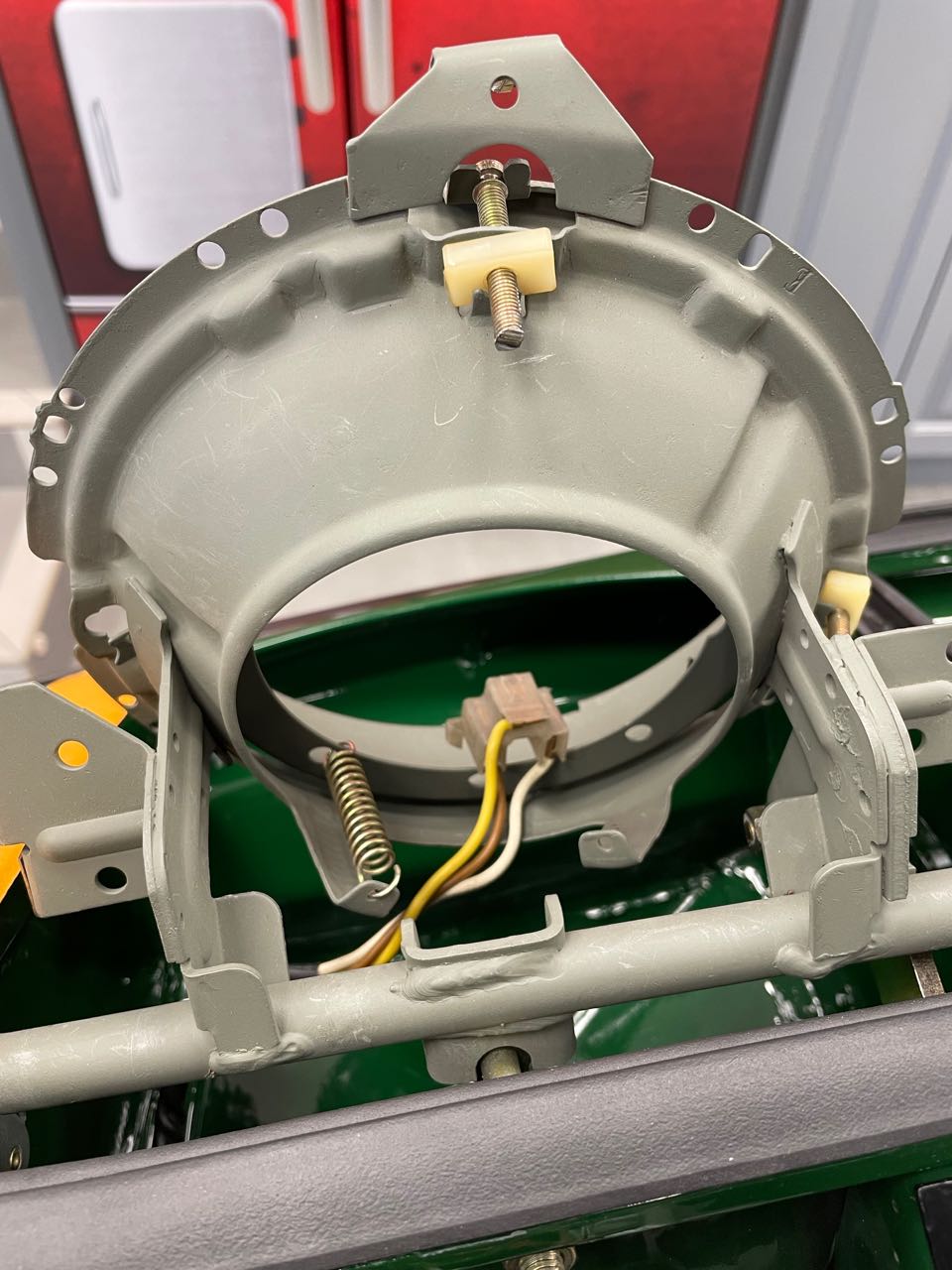

These lights are the second to highest in their product line. Chose them because they are preassembled into an H4 lens and do not use a fan.

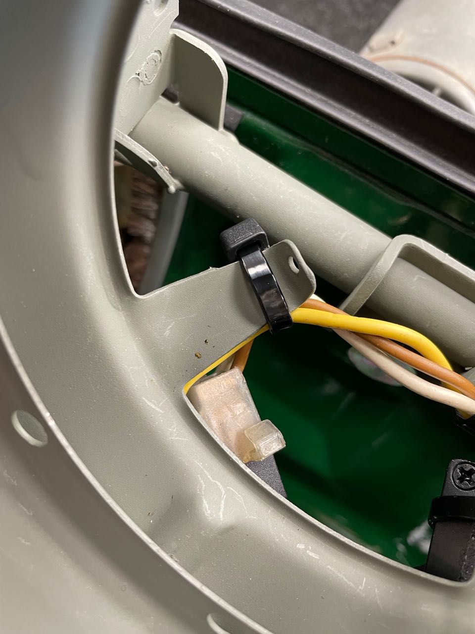

This started as a 1 hour project that as usual turned into a 4 hour thing. After fighting nearly 50 year old screws the biggest issue became where to mount the circuit board box that is part of the assembly. First impression is it should be easy, but there is really not that much room in the headlight bucket as the assembly rotates up and down and the placement is not inconsequential.
Not inconsequential because one placement caught my plastic trim bucket and caused a stress crack. Bummer as these are original white ones on my '70 car.
At any rate, I ended up wrap tying onto the bracket that holds the spring. This position is a good fit. and remains out of the way as the assembly moves through its motion. Pix below.
Maybe this will save someone else some time (and a cracked plastic trim bucket).
Warning: Many wrap ties died in the completion of this project.
Oh yea, great product, low beams project a very diffuse pattern that lights a big area in front of the car. High beams are very effective. Makes night driving a whole new and safer experience. NICE!!

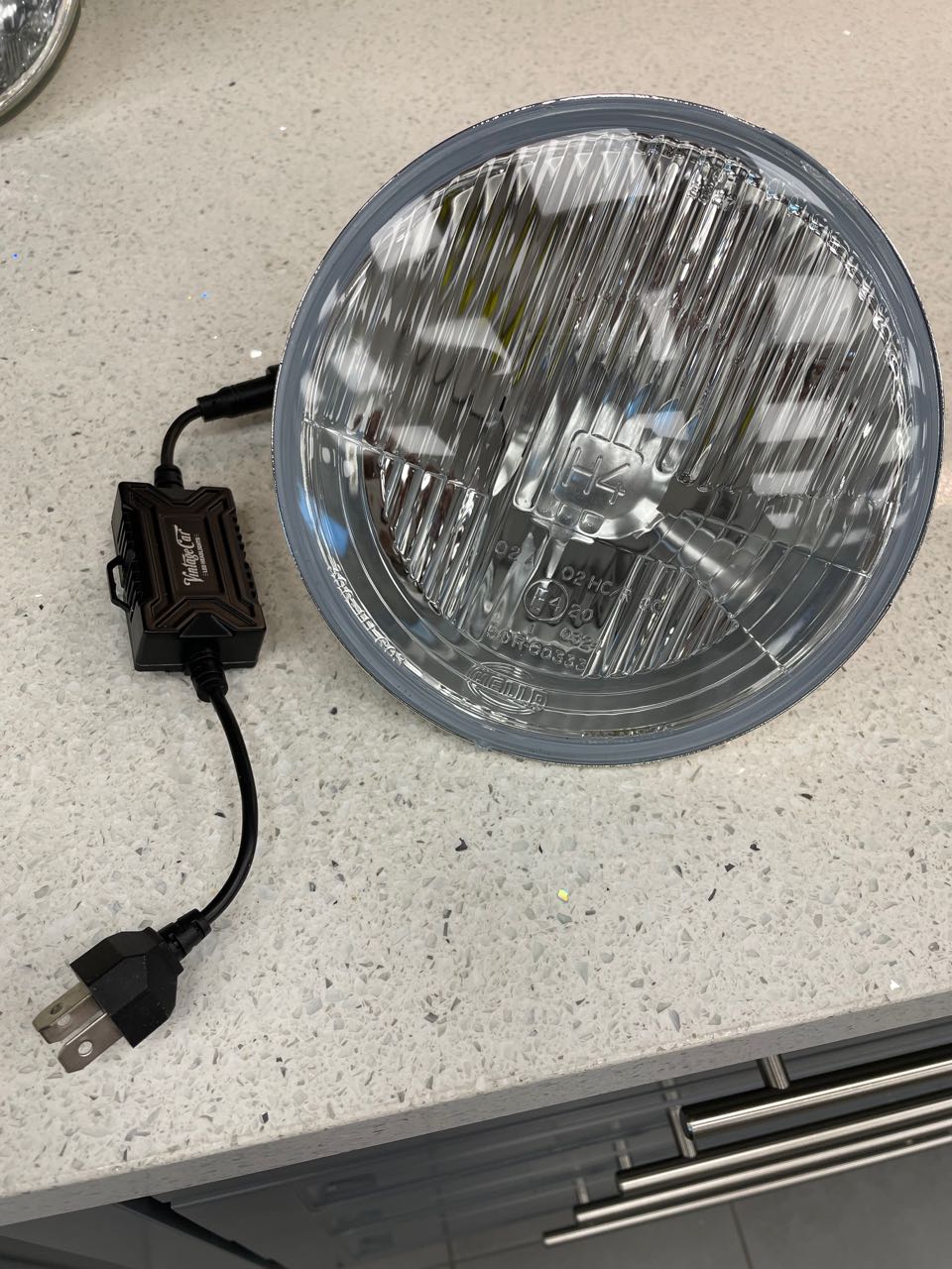

Another long lead time got me to wondering if the bulbs or housings are unique to the company. Eventually, I found these
For $29, curiosity got the better of me and they were delivered before the replacement 7-inch H4 units were. They sure looked like the same bulbs to me, so I returned the 7-inch units. I have yet to try the bulbs, as there's a lot of conflicting info out there re: LED bulbs in H4 housings. Also need to find some garage time, which is rarer than I'd like!

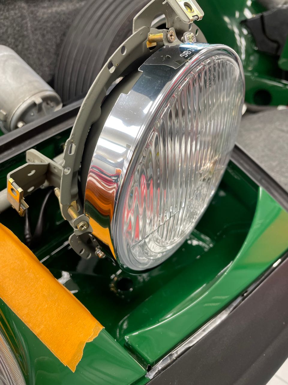

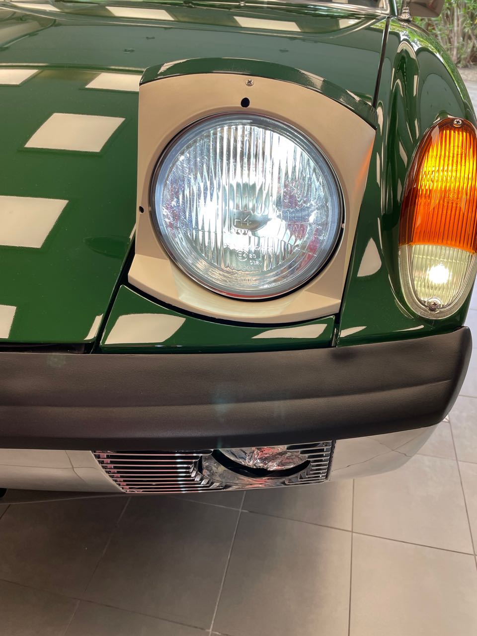

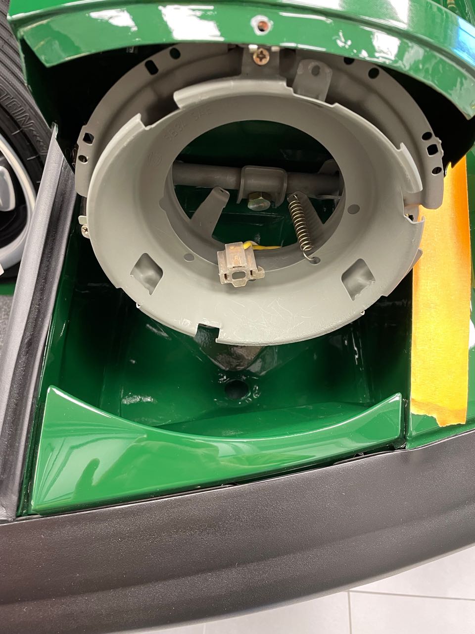

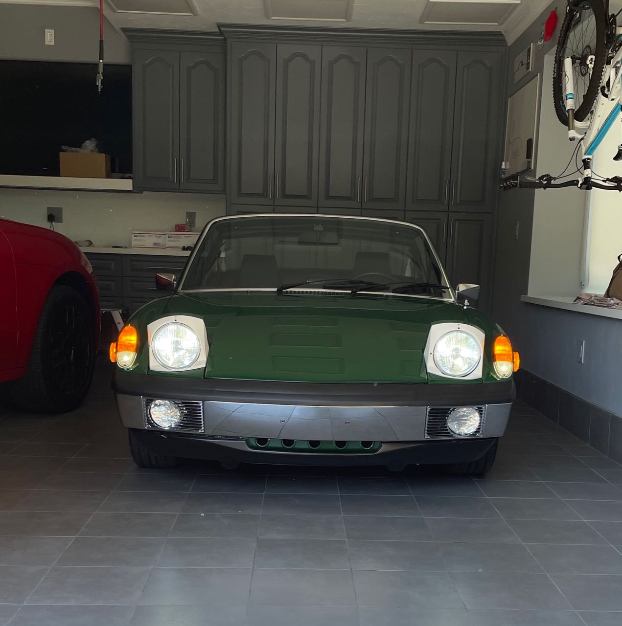

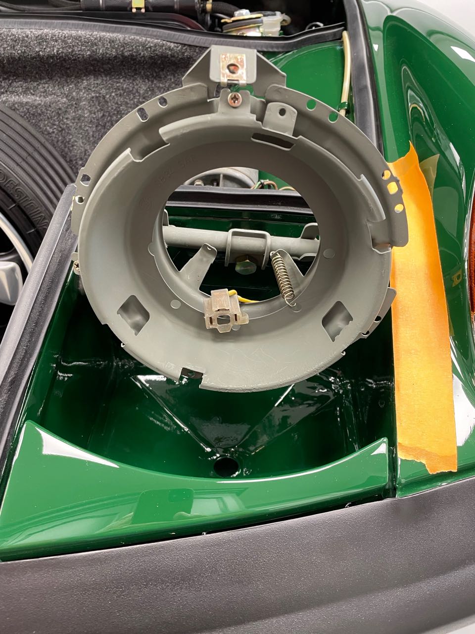

OK, so I tacked this today after reviewing @gereed75 pictures and posting. Very simple after that. Love that these lights look perfectly correct for the car.
Now I need to get a hold of Kent and see if he can re-adjust the eyebrows, etc. so the shut lines are prefect. Kent had to mess with the eyebrows and headlight doors when the other set of LED headlights were in the car as the stuck out about 3/8" beyond the bezel.
Oh, you can make fun of my driving lights. Mine are at Jerry's (Spokes) getting his new circular LEDs installed. I can't wait to get them back. I covered the buckets with tin foil 'cause I am weird like that.
Anyway here are some pictures:

Fit looks good, and your car's overall fit and finish continue to slay me. And you say you want to make it better? (IMG:style_emoticons/default/unsure.gif)
Very curious to hear your feedback on performance!

@horizontally-opposed So I got a chance to drive with these at 0500 today. They throw some great light. I would say they are at least as bright as the GE Nighthawks and may even be brighter. I did note they were a bit high so I will adjust them down. I do not want to offend on-coming drivers. (IMG:style_emoticons/default/sunglasses.gif)
@gereed75 Thanks so much for the help with this project. These lights look perfect in the car. I had them in my last 6, 30 years ago, but that was when you still had to run the 80/100 bulbs and a relay. Even then, they did not light like these. (IMG:style_emoticons/default/beerchug.gif)

I'm curious ... if I already have H4 globes ... could I simply drop in these bulbs from the same company?
https://vintagecarleds.com/shop/bulbs-only/vcm3-bulbs-only/

I suspect they drop in to “standard” H4’s. Do not think Vintagecarleds has special H4’s made just for them, but...
Just ask them, they are domestic and responsive

I heard back from them ... they are a direct fit for Hella H4 globes. I placed an order. Will share the results after I install them.
