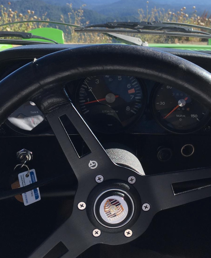

My little 2.2l six redlines at 6200, so I do see your practical point Mark! I run a modified 911 tach at the moment:
For me personally though, it's more getting the look to match the factory GT gauge set, as it seems most of them were fitted with 10K tachs (from trawling through the the PBase photos). And yes, I have to change the other gauges to match as well - but much like life, this car is a work in progress....
- Tony
