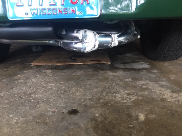

Here is a photo of the exhaust pipe with white residue and no paint left. I just realized that the residue may simply be leftover engine degreaser from when I cleaned up the engine a few days ago.
I will recheck the timing today, and try to go for a drive with the TPS disconnected to see if it makes any difference. I am more concerned about the backfiring, honestly.

QUOTE(JeffBowlsby @ Oct 8 2018, 11:54 PM) *
Fire coming outta the tailpipe usually means RICH. Hard starting could also mean RICH.
Have you checked your CSV to see if its leaking fuel into the air plenum (thats what you called the 'intake manifold' above), at any time other than cranking.
Checked your fuel injectors for leakage and even flow? Pull them and shoot them into cans or glass jars while cranking to test.
Does your MPS hold a steady vacuum or does it leak down under a vacuum?

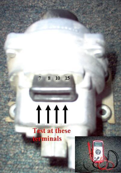

very rough idle when cold : check AAR valve. It doesn't change the mixture but should give a high idle when the engine is cold.
Timing: In depth write-up if you haven't already read it is here:
https://www.pelicanparts.com/techarticles/9.../914_timing.htm
MPS needs to hold vacuum.
get a mity-vac and pump it up to 15hg on the gauge and leave it for 5+ minutes to see if it leaks.
Also test pins # 7 to # 15 and the resistance should be 90 ohms. # 8 to #10 resistance should be 350 ohms.
