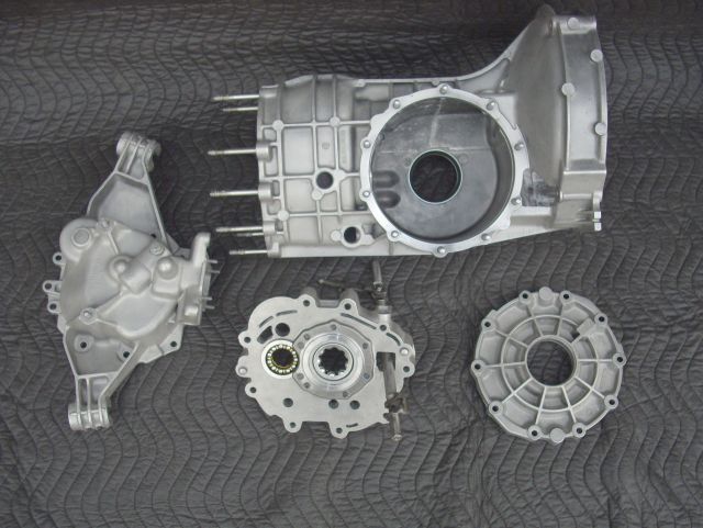

I wouldn't use sand. . I doubt that any tape or sealing will keep all
of the abrasive out. . I'd go with plastic beads if you can't do the soda or dry ice, which
would be my first choice for an assembled tranny. .
However, all of this is a substitute for doing it right. . pull the trans apart, blast it, then put in in a vibrator ceramic tumbler, and you'd have a perfect original finish . . .
This is bare Mag, no paint. . it was then coated with an Aerosapce metal protectant from Boeing called Boshield,T-9. It is similar to WD40, but dries to a waxy protectant finish that penetrates the pores of the mag. . I did mine 8 years ago and it looks the same today.

QUOTE(toolguy @ Nov 29 2018, 07:44 AM) *
Great input. (IMG:style_emoticons/default/agree.gif) Stay away from sand. I have no experience with plastic beads but sounds promising. Walnut shells is messy but works terrific. If and when I redo a trans, I'm trying Boshield T-9, if I can find it.

QUOTE(toolguy @ Nov 29 2018, 10:44 AM) *
This is the best response, but others hit the nail on the head with recommending not blasting it.
