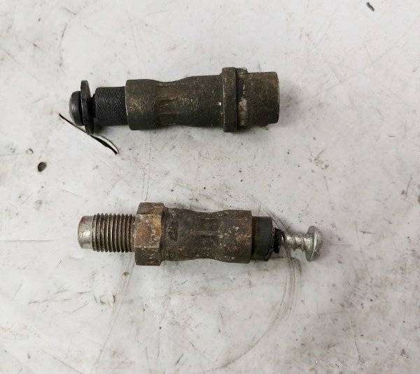

Over the years of going to junkyards for the various VAG cars I own, I have picked up a lot of old flex brake lines. One end is female and the brake caliper end is male. I cut the lines, just about 1/2 inch from the fitting. Then I a take a screw, usually from the car I go them from, and run the screw run it up in the cut off hose.
Then I can use the female end on the male fittings, and male end on the caliper. Never leaks.
Greg W.
