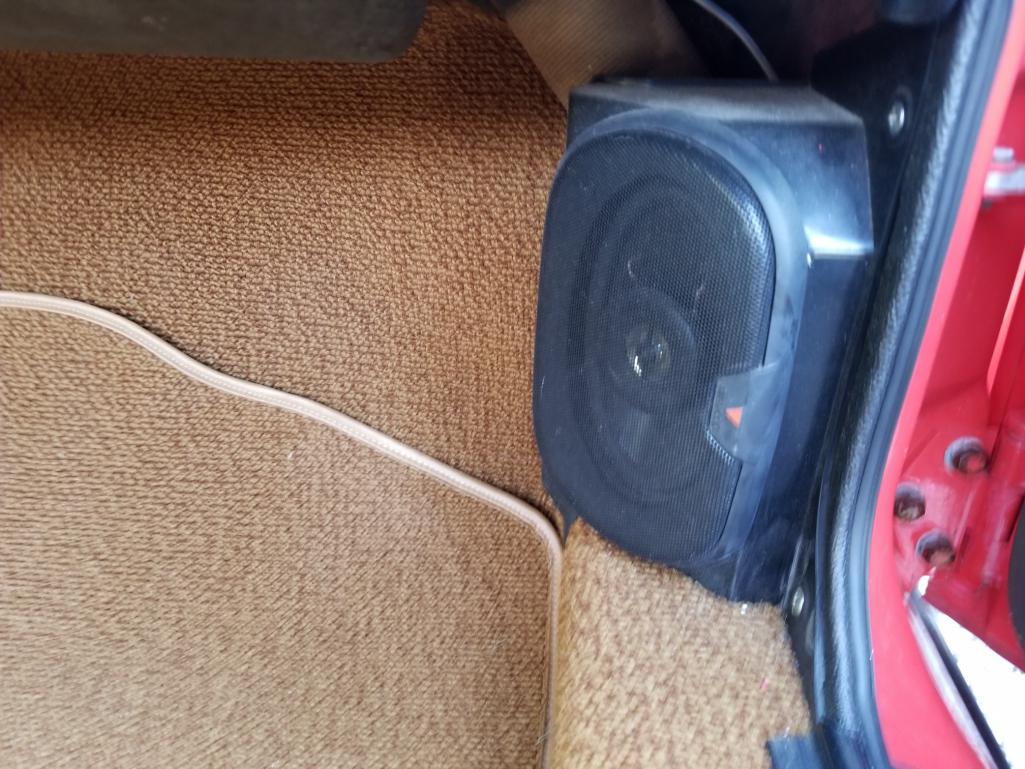

I cut the slats out of the stock housings and mounted new speakers on the outside for more clearance. Attached Image

QUOTE(BENBRO02 @ Dec 24 2018, 10:31 AM) *

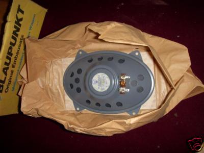

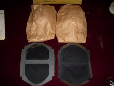

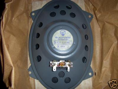

QUOTE(Mark Henry @ Dec 25 2018, 03:14 PM) *
QUOTE(914werke @ Dec 25 2018, 04:15 PM) *
Those have the small magnets and are shallow depth, all newer speakers seem to have great big magnets.
The magnets were probably smaller than today's speakers because the output wattage of the stock radios wasn't very high.
I have a pair of 4x6" speakers that came in a NOS OEM radio/speaker deal that I purchased several years ago.
(IMG:http://www.914world.com/bbs2/uploads/post-17415-1401310264.jpg)
I plan to install the radio (more for looks than anything else) but probably won't be using the speakers - I'll be installing a hidden, more modern audio system and a pair of Morph's (A&P) speaker pods with 6.5" Blaupunkt speakers.
(IMG:http://www.914world.com/bbs2/uploads/post-378-1340465380.jpg)
I'll be posting the OEM 914 speakers in the classifieds soon. They won't be too expensive, but they won't be real cheap either.
(IMG:http://www.914world.com/bbs2/uploads/post-17415-1401310335.jpg)
(IMG:http://www.914world.com/bbs2/uploads/post-17415-1401310414.jpg)

QUOTE(BENBRO02 @ Dec 24 2018, 09:31 AM) *
@benbro02
What size speakers are these? They actually look better than the aftermarket 6" round offerings.

(IMG:style_emoticons/default/agree.gif) That is a good solution for a better speaker if you have busted out grills they are all ready ruined, and well it is a simple to go back to stock mod.
Much better than cutting holes in the door panels. Both ascetically and for proper audio staging.
