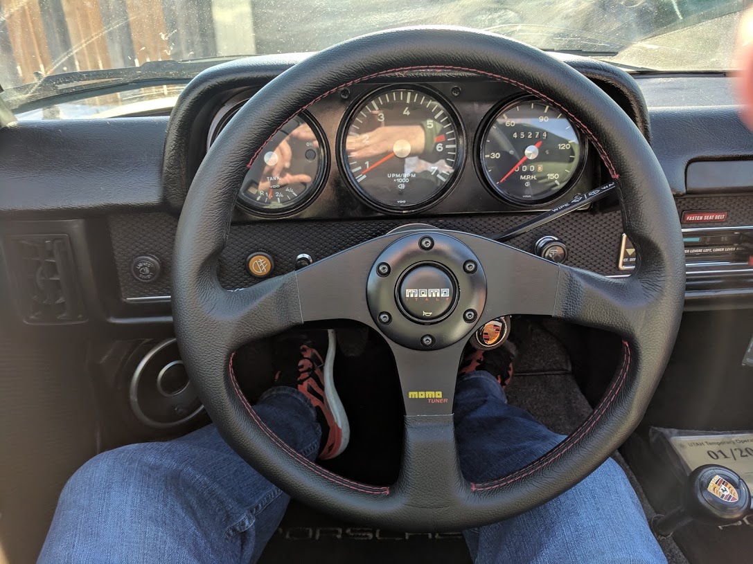

Does anyone have this Momo in their car? I'm curious what spacers are being used. The one that came with my car isn't long enough. My knuckles hit the windshield wiper lever.

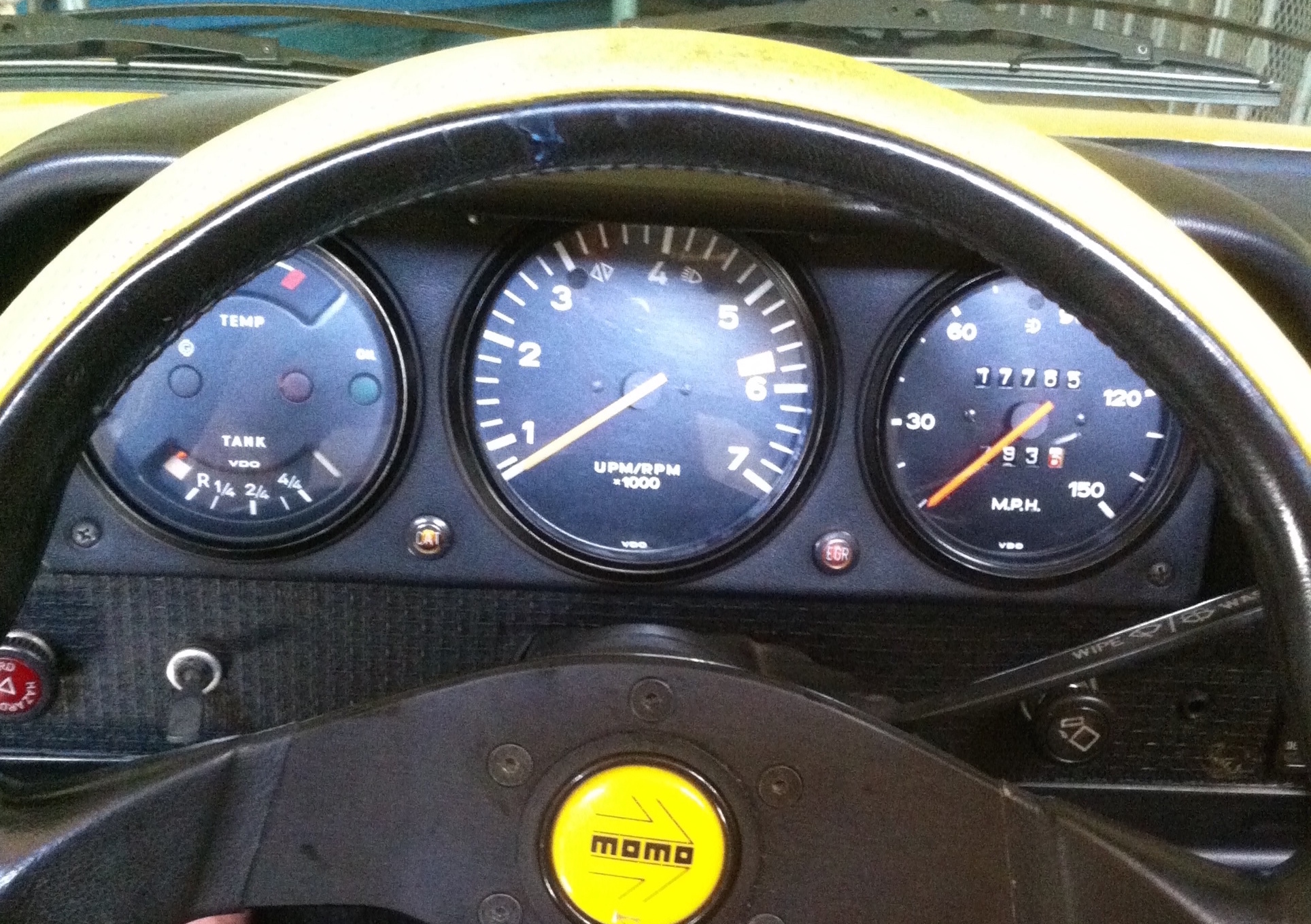

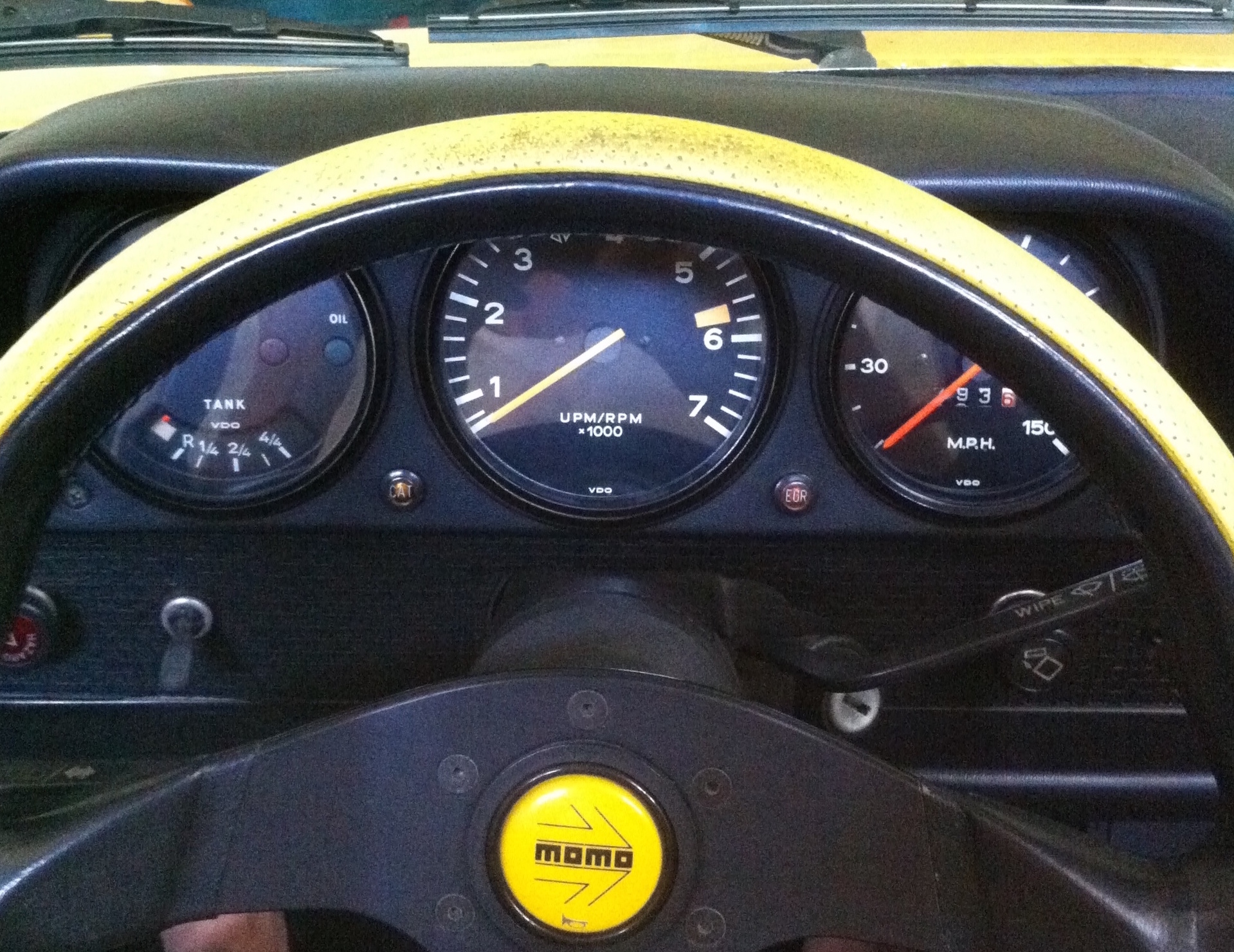

You may want to get a JSWest eccentric spacer. The spacer is about 3/4 of an inch thick and it also lifts the steering wheel about a half inch, giving you more legroom below and an improved view of your dash gauges. Here's the part website and before and after pics of dash view.
