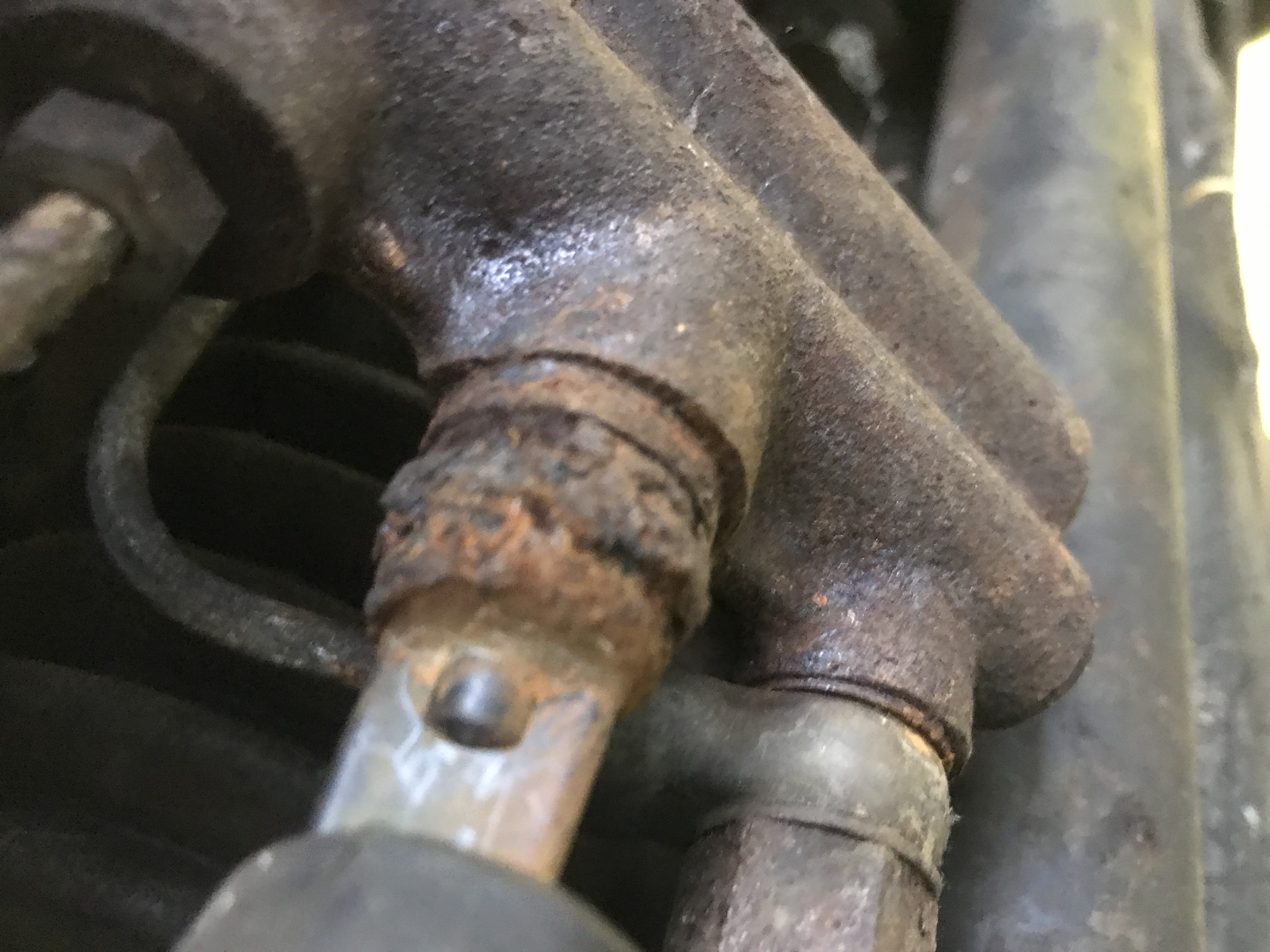

The large red brake warning light on the combo gauge is flashing. The emergency brake is disengaged. I checked the brake master cylinder and the one wire ( it only has one connection) that goes to it is attached. It appears I have some fluid leaking as the connection was wet with fluid. The car hasn't been driven in 12 years so I am sure many things could be wrong. What is the switch on the master cylinder sensing?

A failed MC. So it is probably rusted and the light is doing what it is supposed to.
Edit:
Or switch is rusted. You don't mention if the brakes work....have a peal and stop the car or not. Need lot's more info.

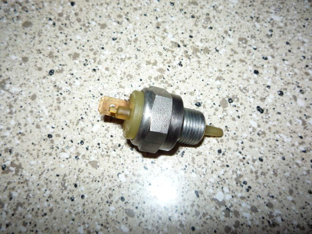

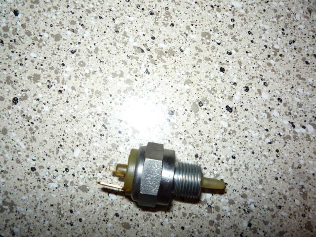

914Sixer
post Aug 13 2019, 10:27 AM
Posts: 9,563
Joined: 17-January 05
From: San Angelo Texas
Member No.: 3,457
Here you go, used but good condition. Reset button works. $20 shipped.
