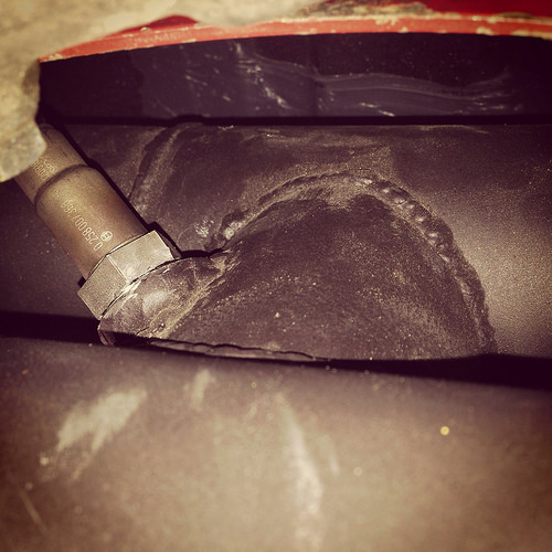

(IMG:http://www.914world.com/bbs2/uploads_offsite/c2.staticflickr.com-1435-1549379041.1.jpg)
I put mine on the up tube leading to the mufflers. Works great.

QUOTE(VaccaRabite @ Feb 5 2019, 09:04 AM) *
ZAch

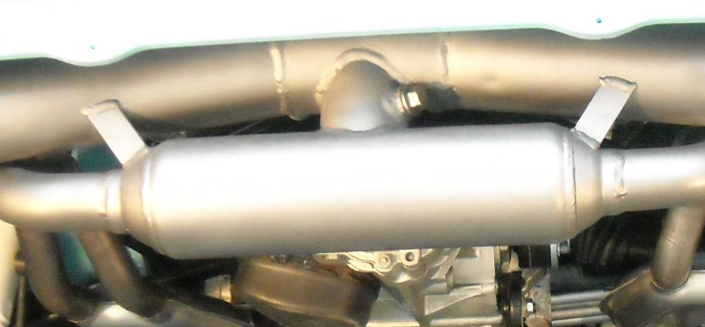

I don't have a triad, but here's a shot of mine installed right before the collector pipe enters the muffler.
What brand AFR did you go with?
I went with the PLX Bluetooth one so I could use my phone for monitoring readings rather than installing a gauge (wanted to keep the stock dash look).
