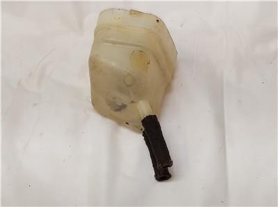

brake fluid reservoir vent tube installation on a 70/4...….

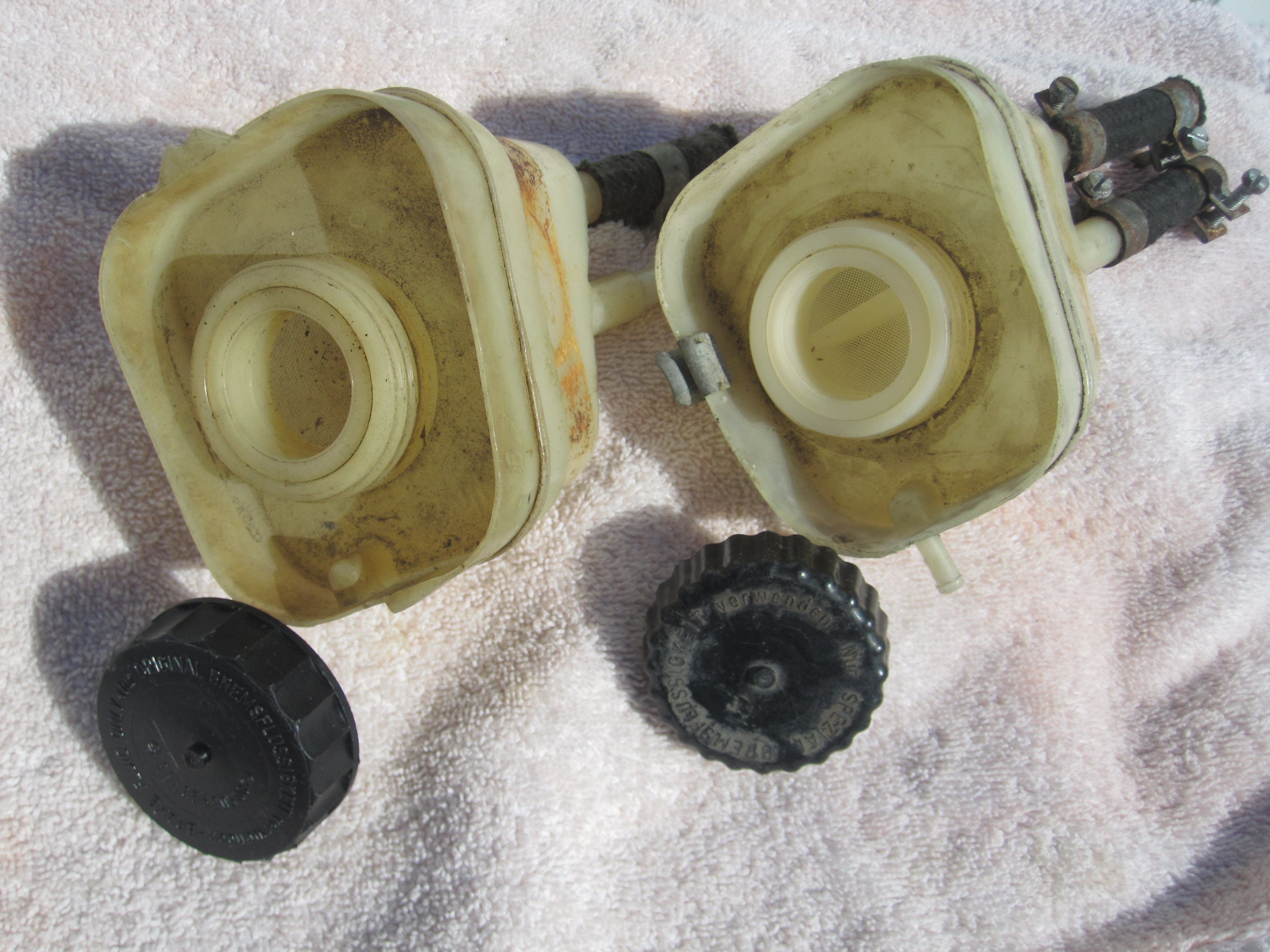

I have two early reservoirs with the drain tubes

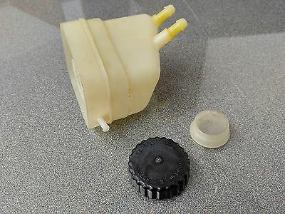

Follow up on this thread.
Be sure to use the correct cap with your resevoir.
Early res. with nipple ? use cap w/rounded shoulders and no vent hole in center.
Be sure to have proper drain tube !
Late res. without nipple ? Square shoulder cap w/vent hole in center.
