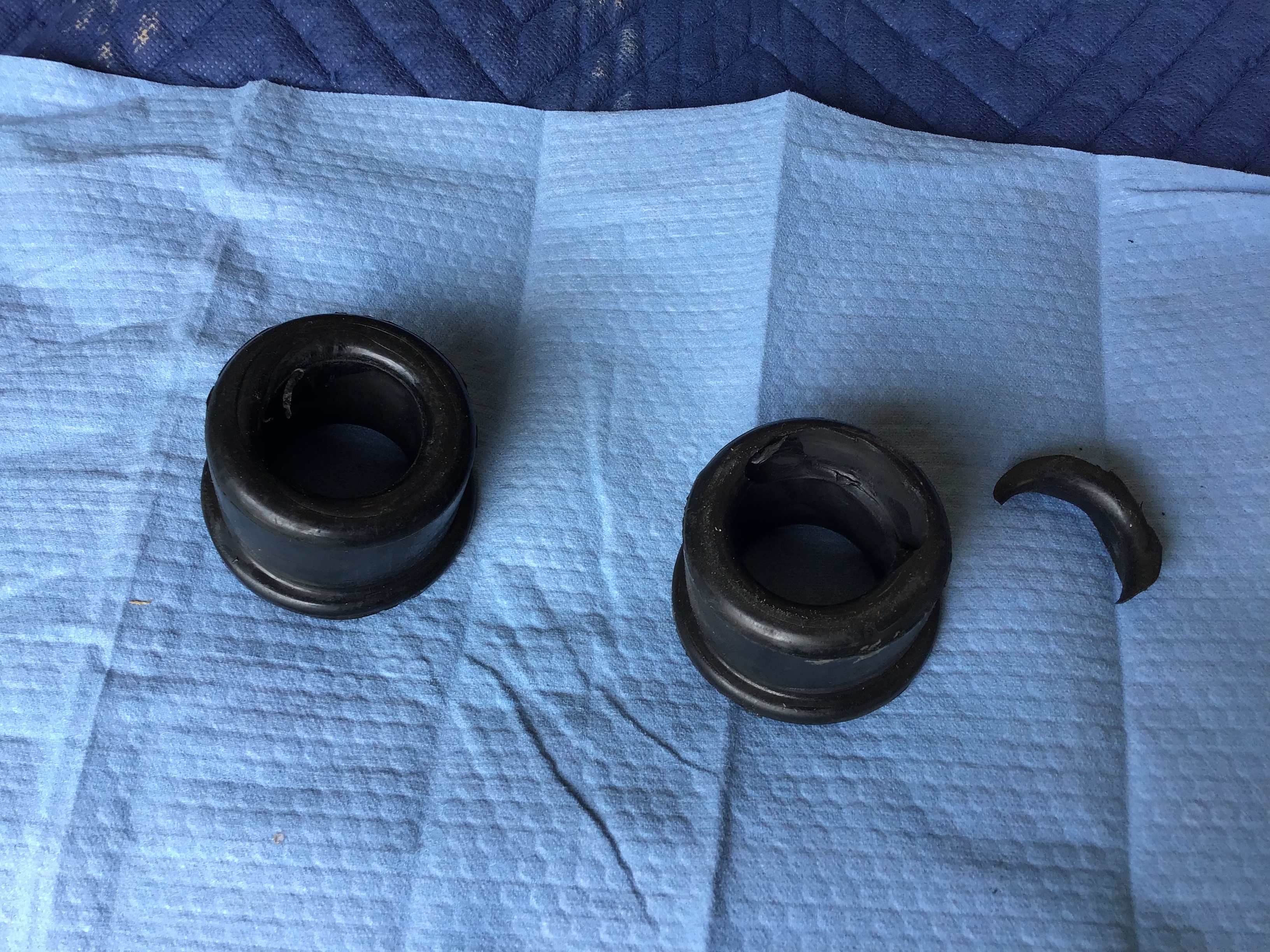

Marks point that boiling longer dose not raise the temp. The key to installing A arm bushings is heat, lube and alignment of the tools. I have installed senveral sets including Elephant, 914 Rubber and Uro.
Uro are to soft and easily distort while installing allowing the bushing to catch on a shoulder and tear as shown.
This can happen with any rubber bushing. Care must be used to see that they are puling on straight.
I found that the rubber needs to be at least 140-160F to pull on easily.

5. Powder coating the A arms and bearing brackets affects the installation. The added thickness of the powder coating causes the bushing to have to stretch longer and thinner. I found the 914 tool for the rear to have too long of a snout not allowing the bushing to be pulled on all the way. The longer snout bottoms out on the tool before it is all the way on. I modified the tool to work better.
6. Watch the angle of the bearing bracket as it pulls on. If it starts to go off - STOP. That is when they gouge. I have done this with several brands. The Uro were the most prone to gouging as they were so soft they do not pull through evenly. I scored two Uro in a row. Grabbed another Uro bushing and it was noticely harder than the first Uro bushings. Hmmmm. Uro claims to have a Sport hardness which sounds like a correction for the too soft originals. I stopped using Uro rubber bushings.
