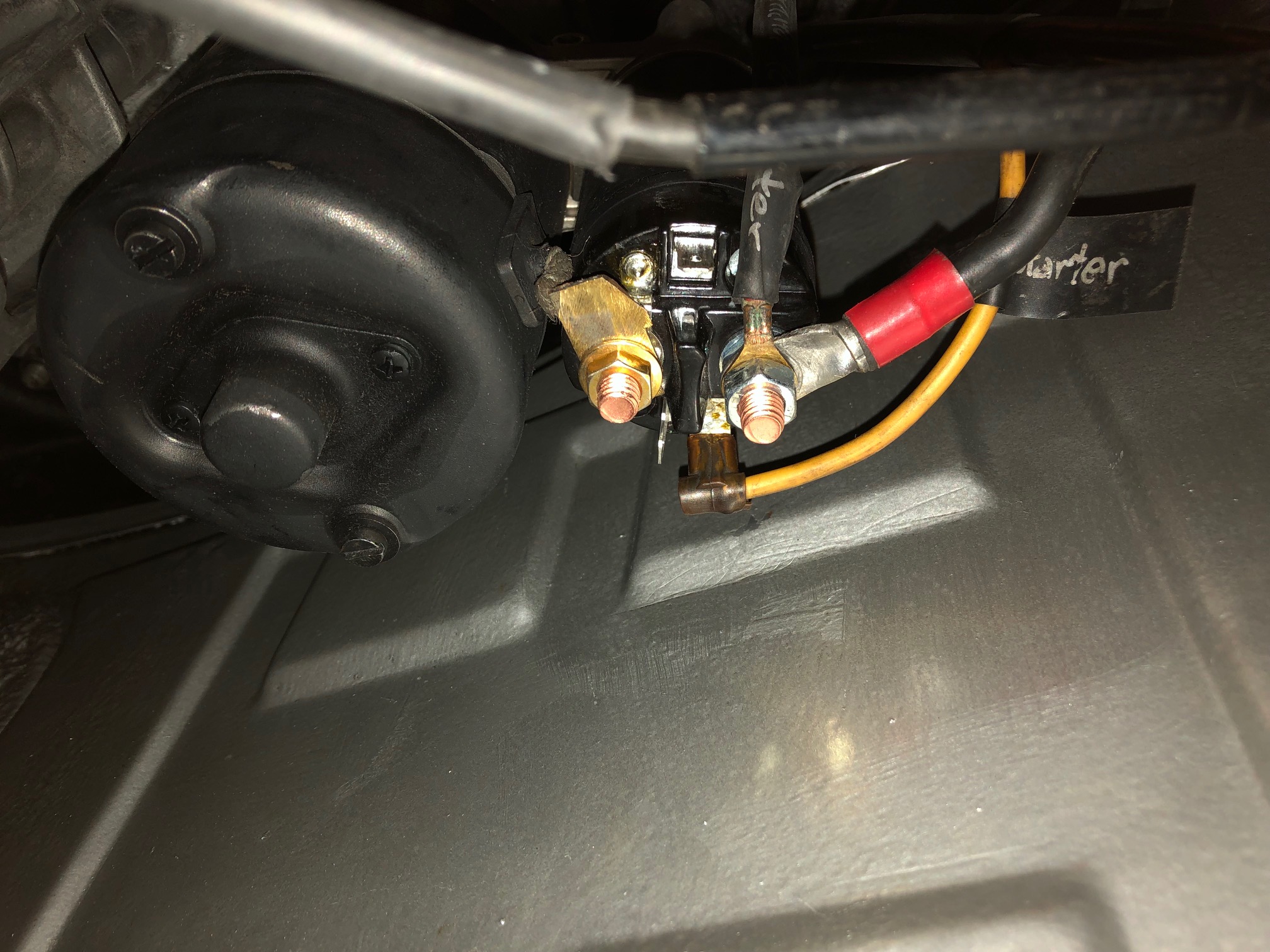

The starter spins when jumped but does not crank engine. Attached is a picture of starter connections.Attached Image

GregAmy
post Jun 3 2019, 02:21 PM
Posts: 2,505
Joined: 22-February 13
From: Middletown CT
Member No.: 15,565
The spade terminal, when energized, pulls up the solenoid and engages the "bendix". When it is fully pulled up, the bendix connects power between the two big lugs on the solenoid, allowing the starter to spin.
For a functional starter to engage and spin the engine, power has to be put to both the solenoid lug and to the spade terminal.
To test the starter, you can jump across the terminal where the battery wire is connected to the yellow wire spade. If that is only spinning the starter but not engaging the flywheel then you likely have a bad solenoid (or, less likely a bad solenoid gear and/or flywheel, both of which can be inspected with the starter removed).
If you just jump across the big lug terminals then the starter will not engage the flywheel and will only spin.
