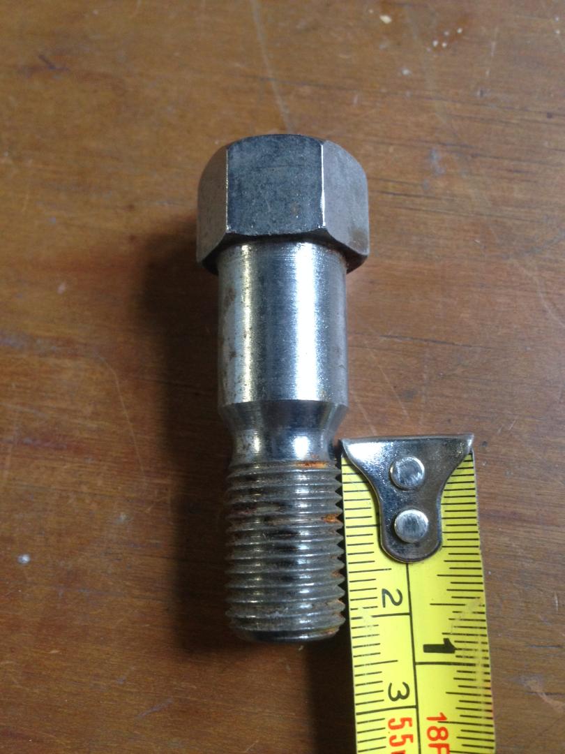

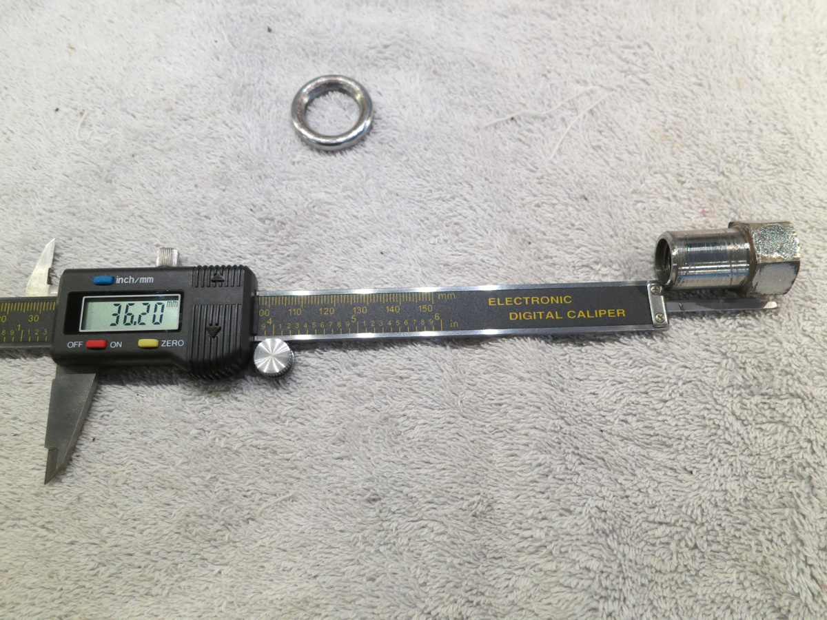

those pics will come in handy. I don't have stems to attach them to, but will get me half way there. I have one of these [attached] on the way in the mail. Looks like you have confirmed I am on the correct path. What I still don't know is if the inserts in my lug holes are stock to the minilite. They seem to possibly work with a conical washer on the nonminilite lugs I have....well 12 of the 14. the other 4 ball seats need to go i'm 99% certain. Attached Image Attached Image

this is what I have now, which is not working from 60-80 mph. 80-100 is fine though (IMG:style_emoticons/default/driving.gif) Attached ImageAttached Image

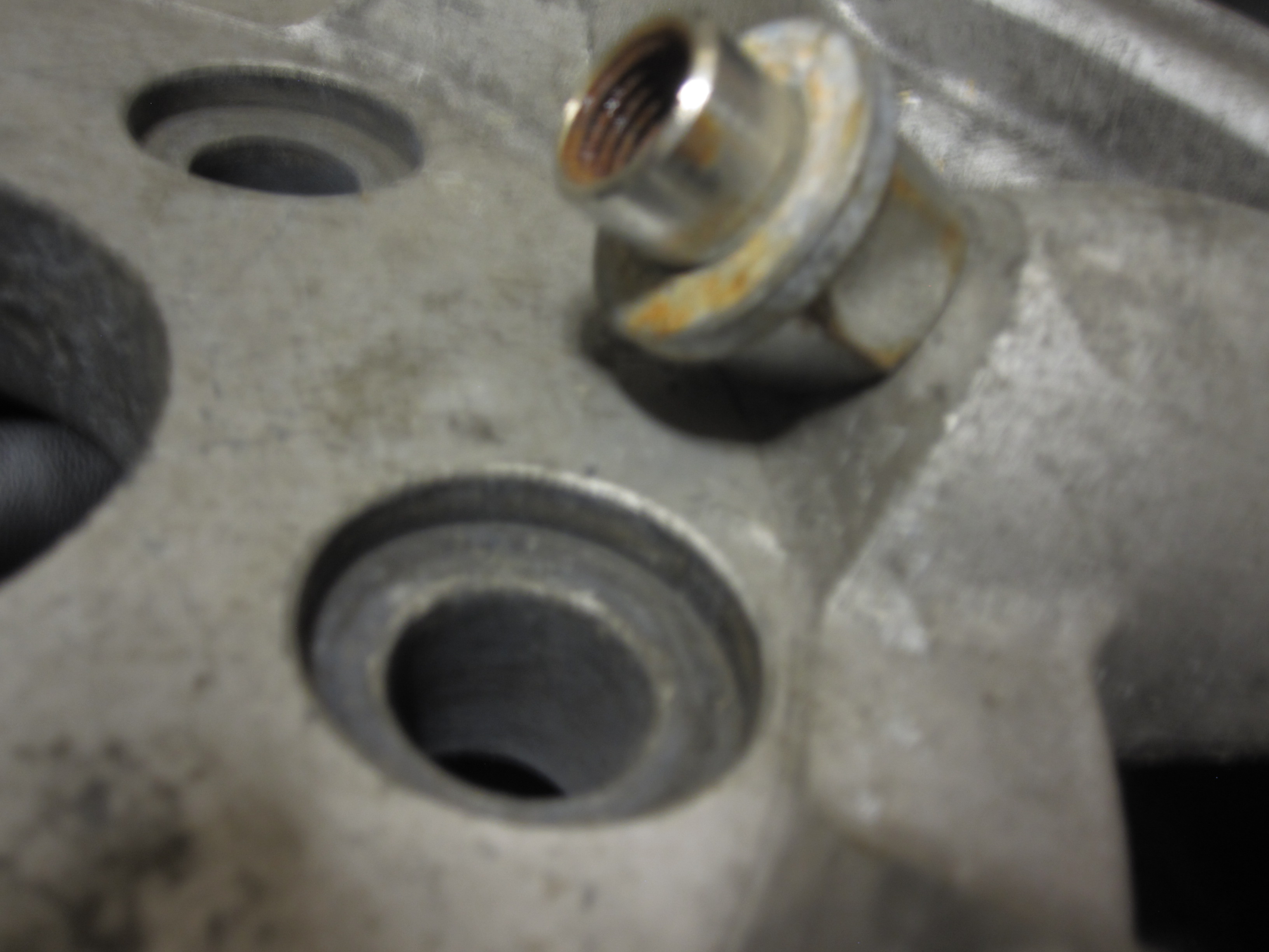

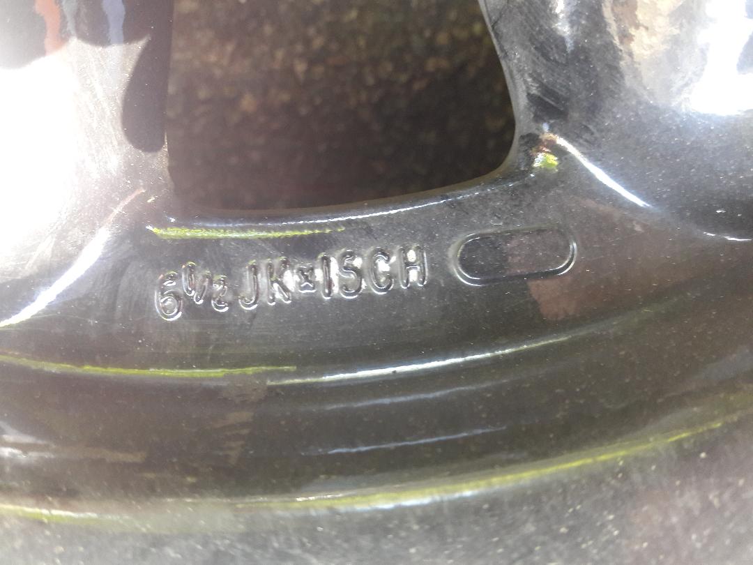

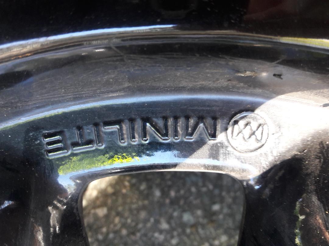

just adding some more pics and info to this thread.
pics of details of my minilites.
more I research i'm leaning towards concluding that I have some sort of this:
https://www.team-bhp.com/forum/tyre-alloy-w...us-reality.htmlAttached Image Attached ImageAttached ImageAttached Image

well someones been doing something to em..bummer, first holes look like tapered seat inserts, the one hole looks flat and not concentric to the insert..is that correct ??
fyi, wobble bolts only work for hub centric wheels..

QUOTE(sixnotfour @ Jun 13 2019, 12:22 PM) *
- deciphering just what is what this exercise has been all about (IMG:style_emoticons/default/av-943.gif)
I think what we see in the pic is one hole with a tapered insert, as exists in all holes. Then the pic with the bolt, has the conical washer removed [as some do, and other bolts are fixed conical shape under bolt head] from the bolt and sitting in one of the tapered inserts.
I think I will know the next step when the original style bolt arrives. but i'm nervous to remove inserts because I don't know how much the original diameter of the bolt holes have been monkeyed with.
thanks for the heads up on the wobblies - seeing how this is my first endeavor with both those, and lug centric wheels. compound issue for me figuring this out.
