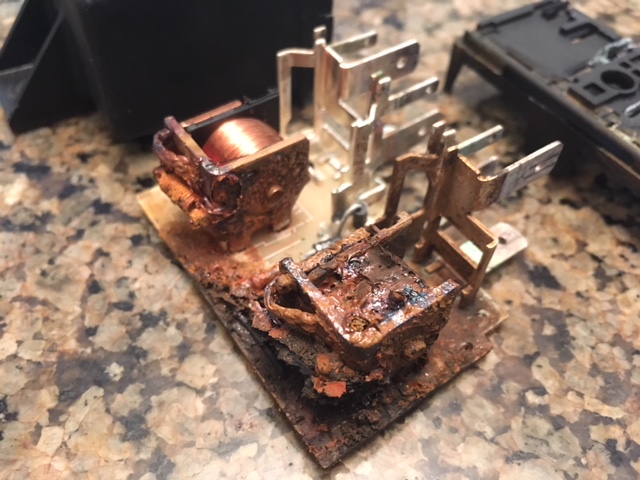

Yes, I understand that a broken wire at the pack can shut it down. I believe that the power is routed from the FI relay to the resistors then to the injectors. The other side of the injector goes to the module where a transistor grounds it to turn it on. Last night I put a scope on each side of one injector and found that I was intermittently losing power to the injector when cranking. When I placed a jumper from B+ to the main resistor pack feed the car fired up and ran. Woohoo! Later today I will place all four scope channels on the dual relay to determine the root cause. Thank you for your suggestions. I will let you know what I find.

Power to the injectors comes from the dual relay, then goes through the resistor pack, then to the injectors, and the ECU either provides the ground (which opens the injectors) or no connection (which lets the injectors close).
Suspect the dual relay and the wires going to it, as well as the stuff in the path of the power and ground that the dual relay uses. (E.g., ignition switch, relay board, etc.)

Thanks for the tech support. I put the 4 channel scope on the dual relay and saw a lot of bad behavior. Then I popped the relay open and found the corroded mess below. I bought the relay from CIP1 in early May so it was damaged before I received it. They obviously have a quality process problem. My refund request is in and a new one is on order fro AutoAtlanta. It is surprising that it ran the car at all. (I also had to pay $90 to get it towed home.)
