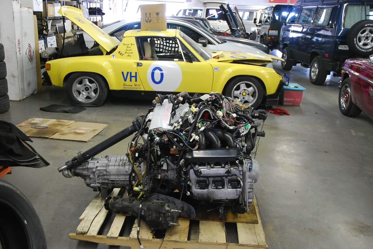

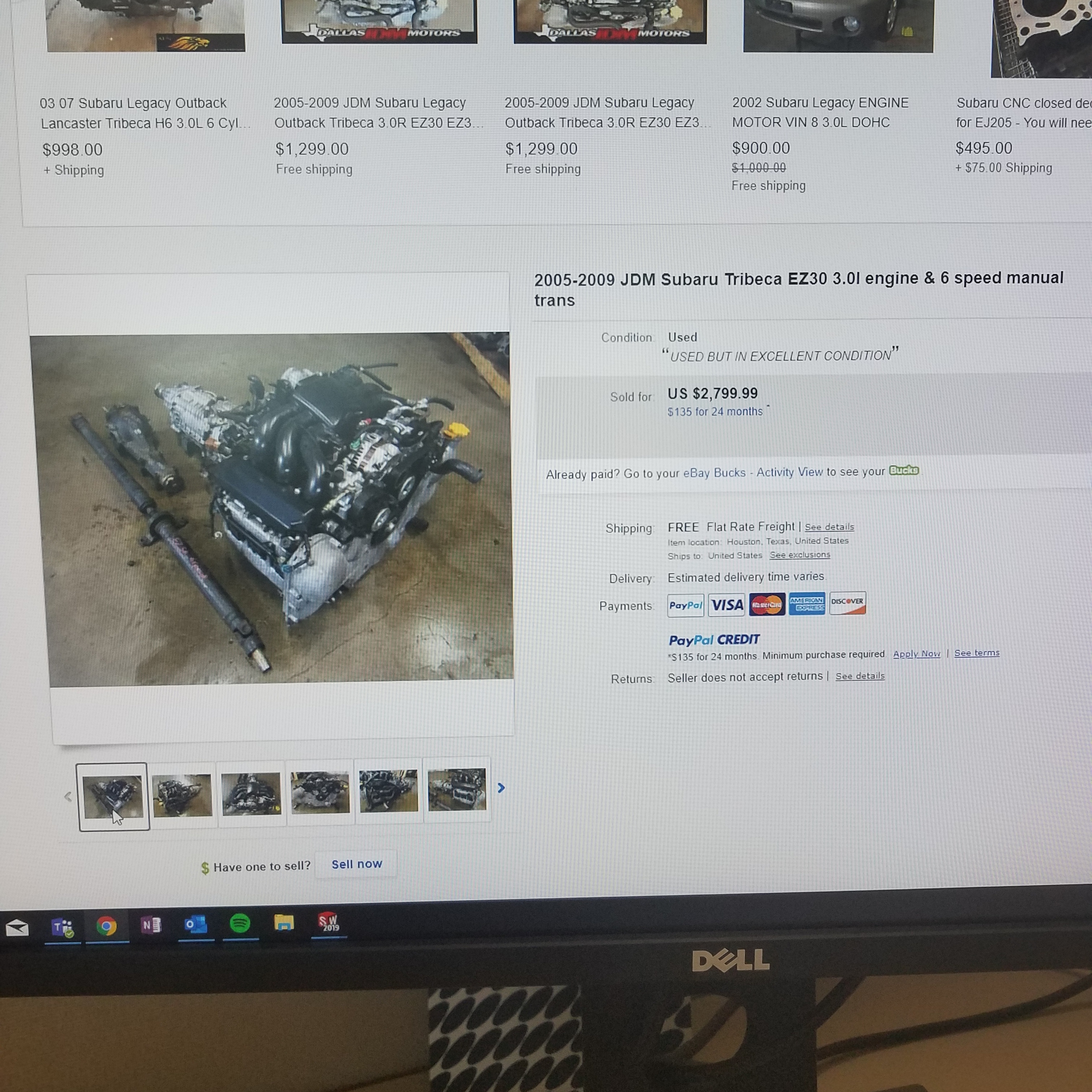

Well The motor and trans are here! Got a fantastic deal on a JDM EZ30/6speed combo Huge thanks to JDM of Houston! the motor and trans look to be in great shape, and it even came with a FULL wiring harness! (not to mention a drive shaft and a rear diff). I just recently got the type 4 motor and trans dropped, so now its time to start thinking about engine management, and an engine cradle.

Welcome to the EZ3*R swap club!
A few tips:
Your going to have to cut the center out of the trunk to fit a 6MT
It's an early 6mt so you're going to have to keep the center diff and weld it up to get fwd or buy one of the JDM drift couplers.
The ECU and harness are pretty much useless due to the immobilizer and no way to defeat it.
I would sell the 6MT and rear diff, there's no need for it in a light car. (STI drag guys love that box)
5MT uses 10% less power to turn them a 6MT.
5MT weighs 75lbs less
5MT clutch and flywheel are cheaper
JDM Spec B has the tallest gearing of any 6MT, not great for acceleration but awesome top end.
If you need any help with your swap feel free to PM me
