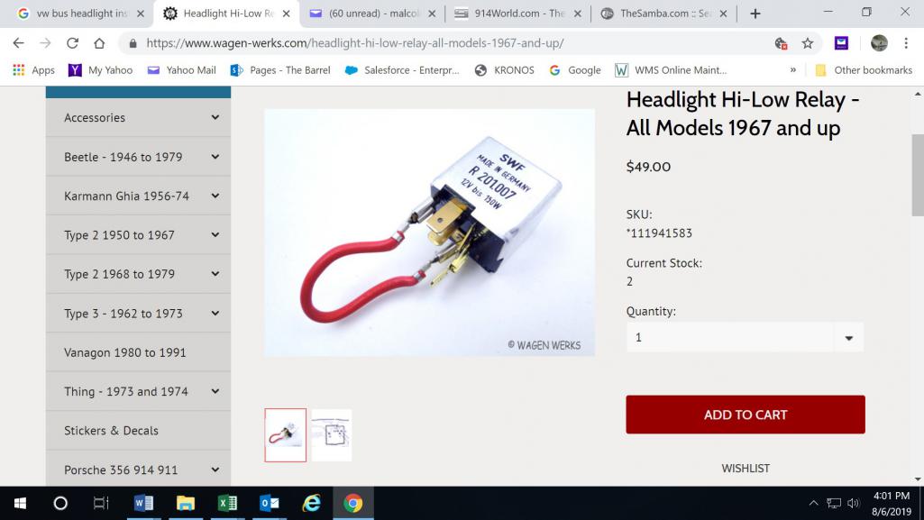

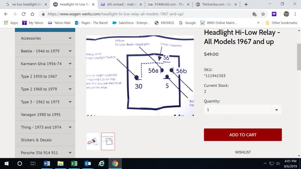

post Aug 6 2019, 03:08 PM
Posts: 2,749
Joined: 31-May 11
From: Nashville
Member No.: 13,139
UPDATE for future....
I found this picture and LINK from Wagen Werks.
THey have a good set up for the jumper. Zoom in to see the spade connectors. It looks like they supply the jumper. Not sure it works with the 914, but all the numbers are the same, so look into it.
