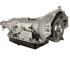

Would this tranny n transaxle be a great fit to go along with that 4.3l motor?

The picture you posted looks like a regular domestic type transmission, not a transaxle.
You do know the difference, don't you?

That transmission will not work. As Larmo says, you need a transaxle.
A Subaru WRX or STi trans with 4wd-delete might work - depends on being able to get the drive shafts in alignment with the rear wheels.
There will be lots of fabricating to get anything to work, though. Also, with the auto, I'm thinking the electronics will need to be configured to talk to each other.
