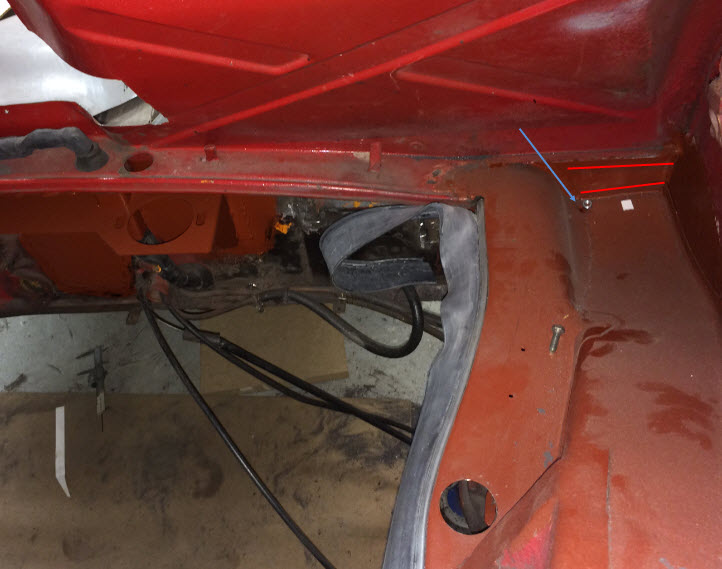

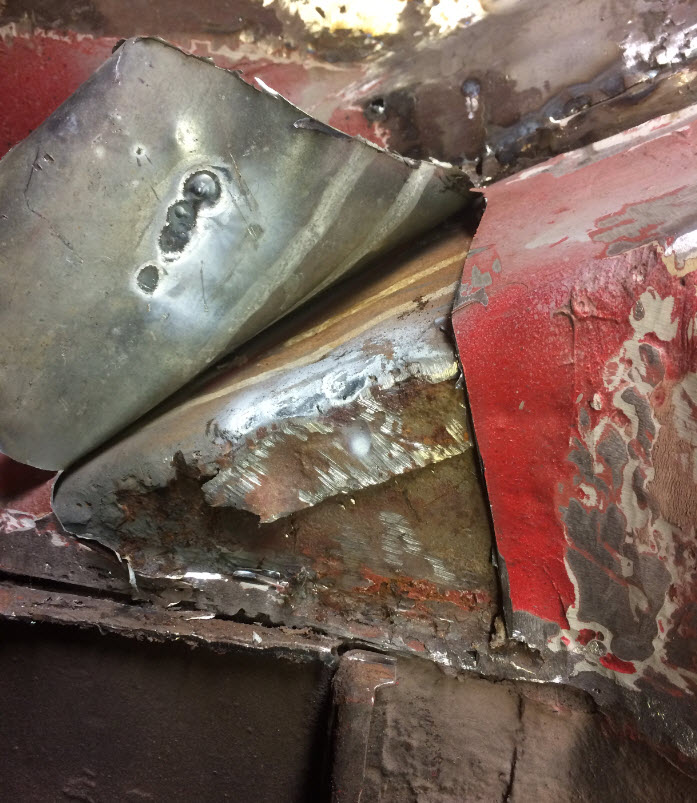

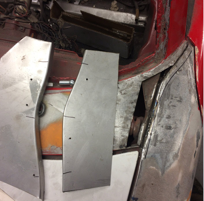

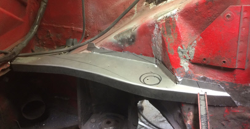

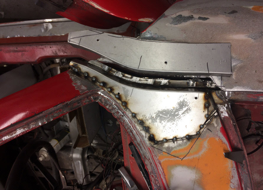

Ok, so the hell hole, turns out it was not rust free.. Hælveteshøl it would be called in Norwegian btw.
It seemed to be solid, but some closer investigation revealed sloppy previous rust repairs. (x2)
Not one, but two layers of new metal without removing the original disaster area.

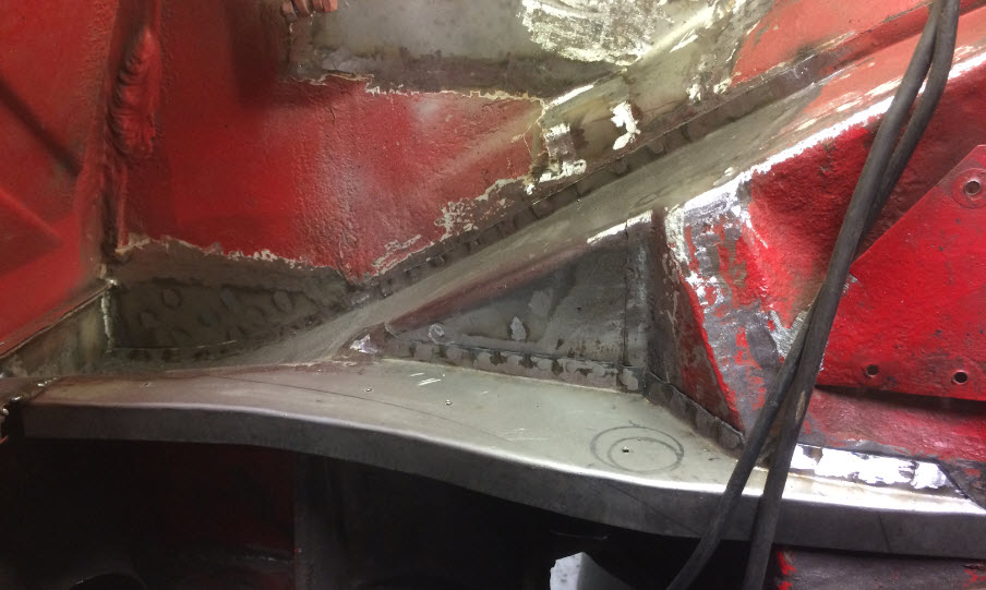

After removing the old crap I started fabricating the new parts. It is not really very complex geometry, and only two areas needed "special tooling".
This is the bottom of the hole, and the flange towards the side.
And the shelf.
I would not call it hell, but more like tedious and annoying-hole.

QUOTE(GTSandberg @ Aug 26 2019, 08:55 AM) *
That's about the cleanest looking HH repair I've seen, great job! Did you put a drain hole down towards the bottom of it, as stock?
GTSandberg
post Aug 27 2019, 06:59 AM
Posts: 63
Joined: 16-August 19
From: Drammen, Norway
Member No.: 23,373
Region Association: Europe
QUOTE(Literati914 @ Aug 26 2019, 04:00 PM) *

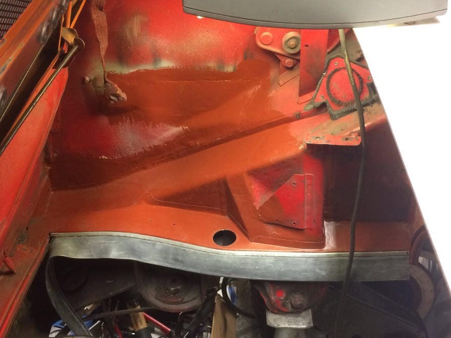

Thank you! Also a good point, The drain hole is in place, important to make it the lowest point, as indicated by the two red lines. As seen in the picture small parts tend to gather in the HH, neat.

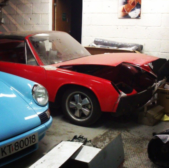

Here are two pictures of the car before I started cutting in it. Quite complete, but not pretty. Solid but a bit rough..

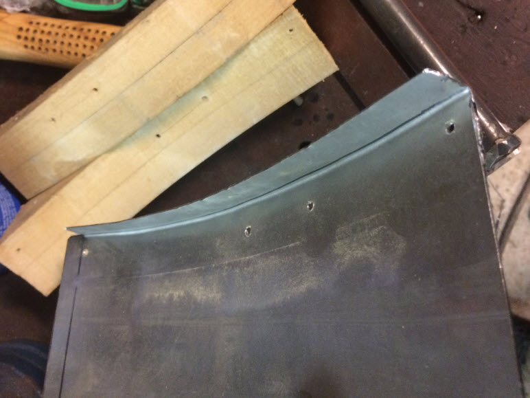

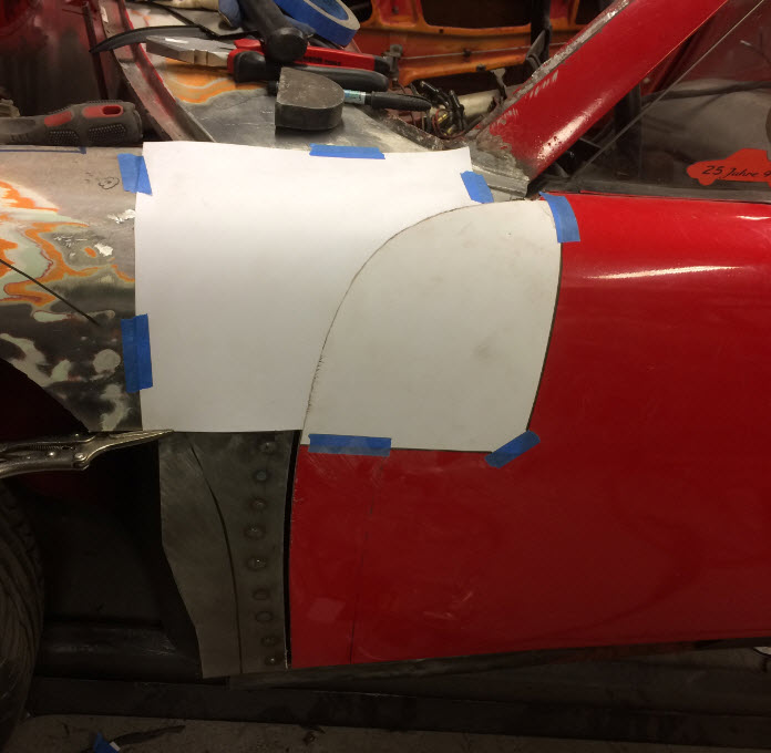

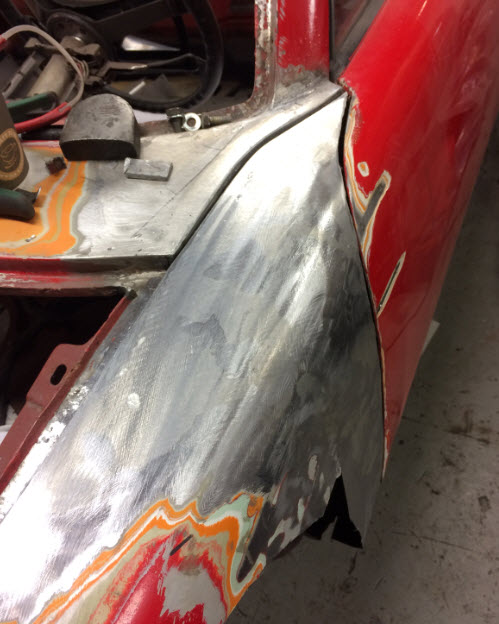

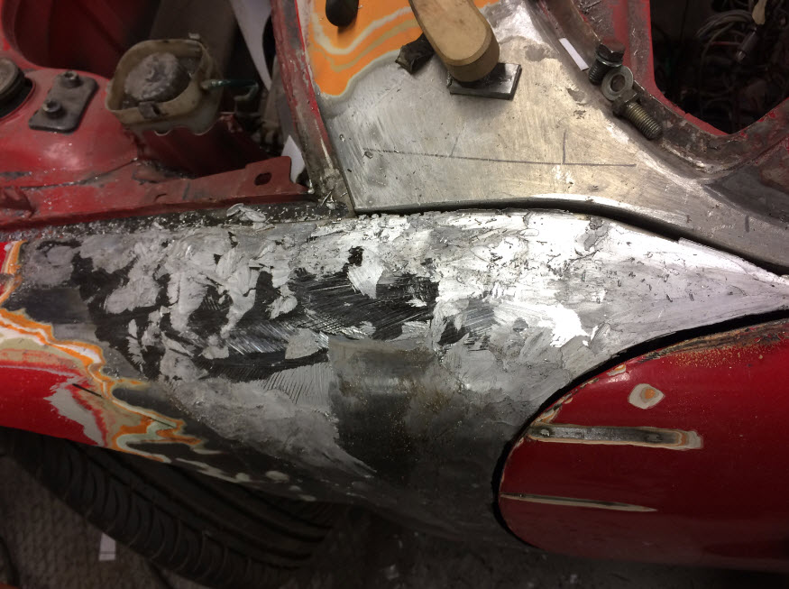

The front fenders has been a lot of work, 914s are not very common in Norway and spare parts are not easy to come by. There were some previous rust repairs that needed to be redone.
The gap between the fender and the part infront of the windshield was welded together, and was not straight. Here I am making the two parts to weld in.
There was also something odd with the door gap..
In progress..
Welded in place, and doing some body soldering with lead
More or less finished, how many layers of paint can you see? (IMG:style_emoticons/default/biggrin.gif)

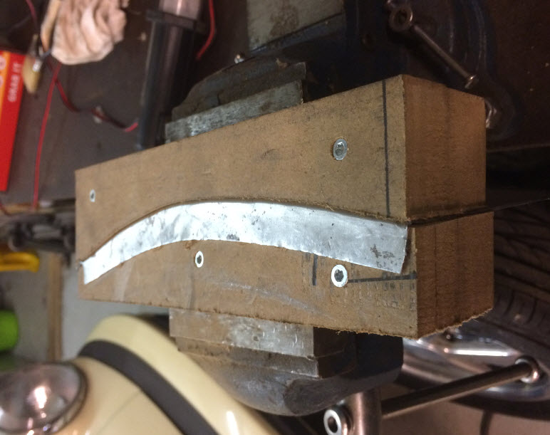

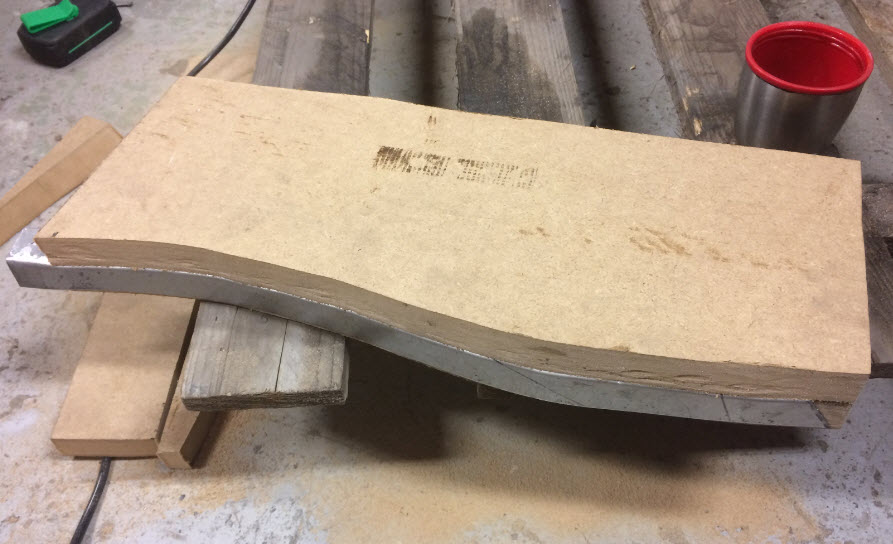

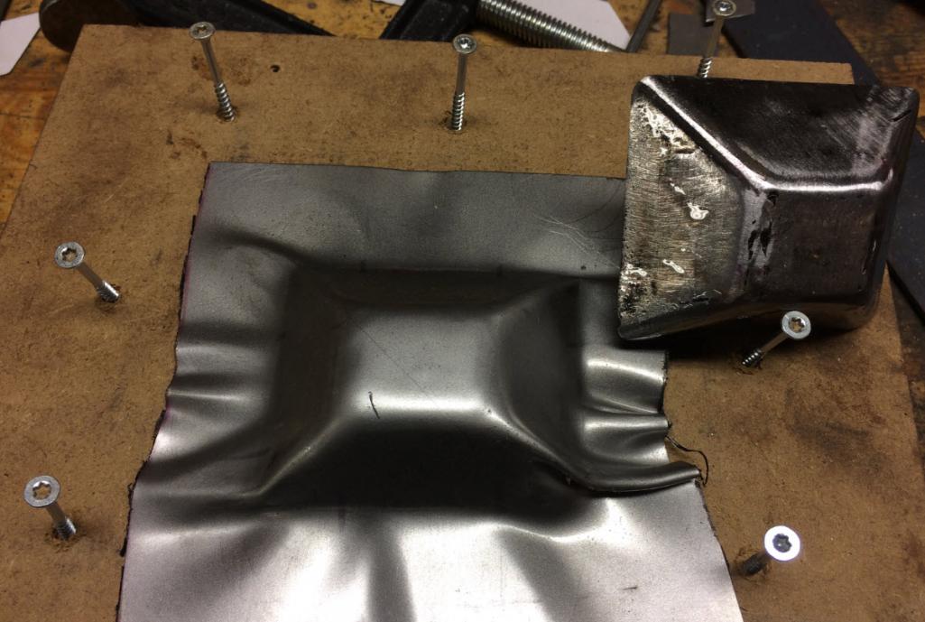

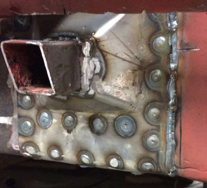

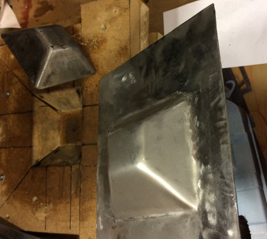

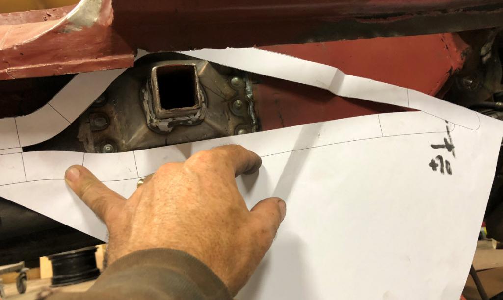

Here is a good example of doing things the hard way.. The goal is to modify the sheet metal structure around the jack mounts to make room for the GT-oil lines. To do this modification I would recomend the following. Buy the replacement sheet metal part, cut and weld. I choose to make a stamping tool (IMG:style_emoticons/default/screwy.gif)
One of the failed attemts and the male tool.
One of the almost good parts after some work, and the female tool.
Welding in the fabricated part.
Test fitting my brand new paper oil lines.

mb911
post Sep 5 2019, 02:15 PM
Posts: 7,809
Joined: 2-January 09
From: Burlington wi
Member No.: 9,892
Just a note as I have had made and sold 38 sets of GT hard lines the indent really is not required.. I had no issues fitting mine personally ..
