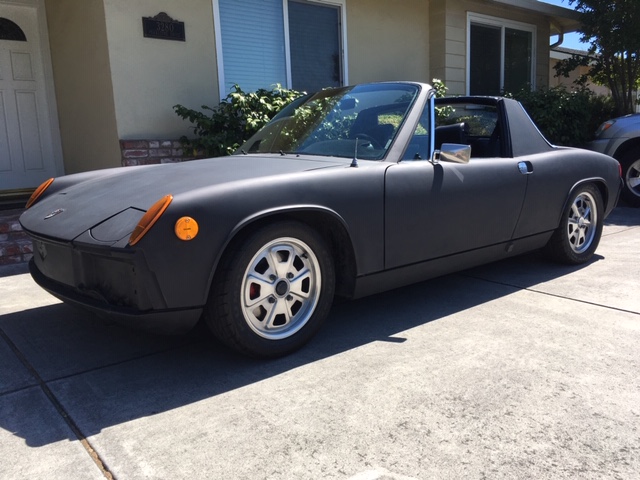

I just bout this 75 1.8 last week same problems. trying to sort out the grinding first and cant find fourth gear problem. new bushings and clutch cable adjustment to start. hopefully the cheep fix will do it.Attached Image
