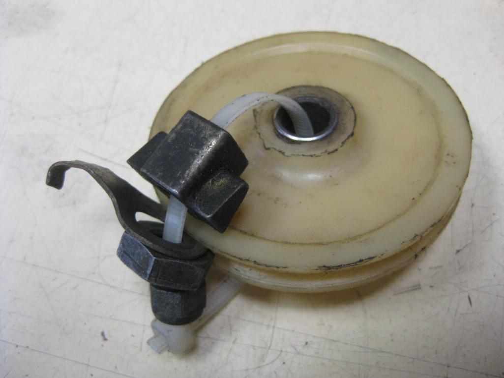

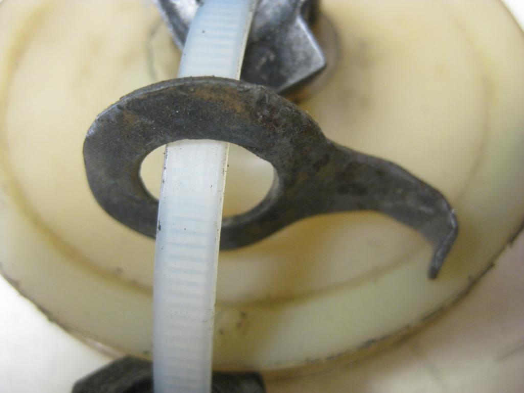

Here's what you need:
every 914 travelling kit should have this in it:

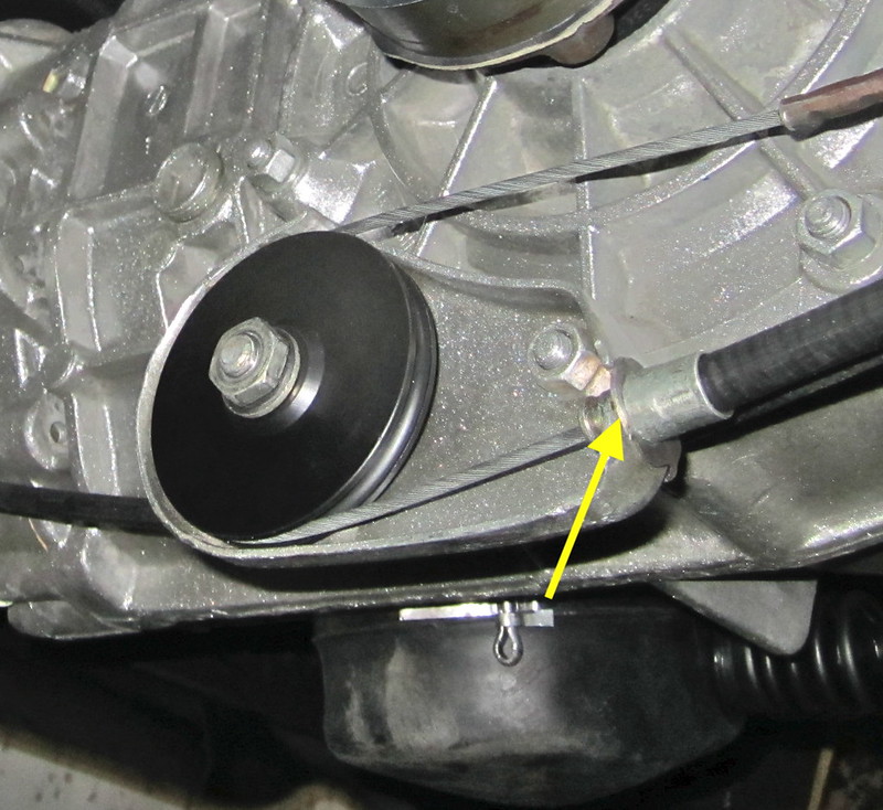

Can someone post a picture of the cable stop plate on the vehicle. Is it bolted on? Having a blonde moment.

QUOTE(RolinkHaus @ Sep 11 2019, 01:31 PM) *
Mine is missing also, but I found this pic on the net...
(IMG:http://www.914world.com/bbs2/uploads_offsite/live.staticflickr.com-20876-1568248481.1.jpg)
