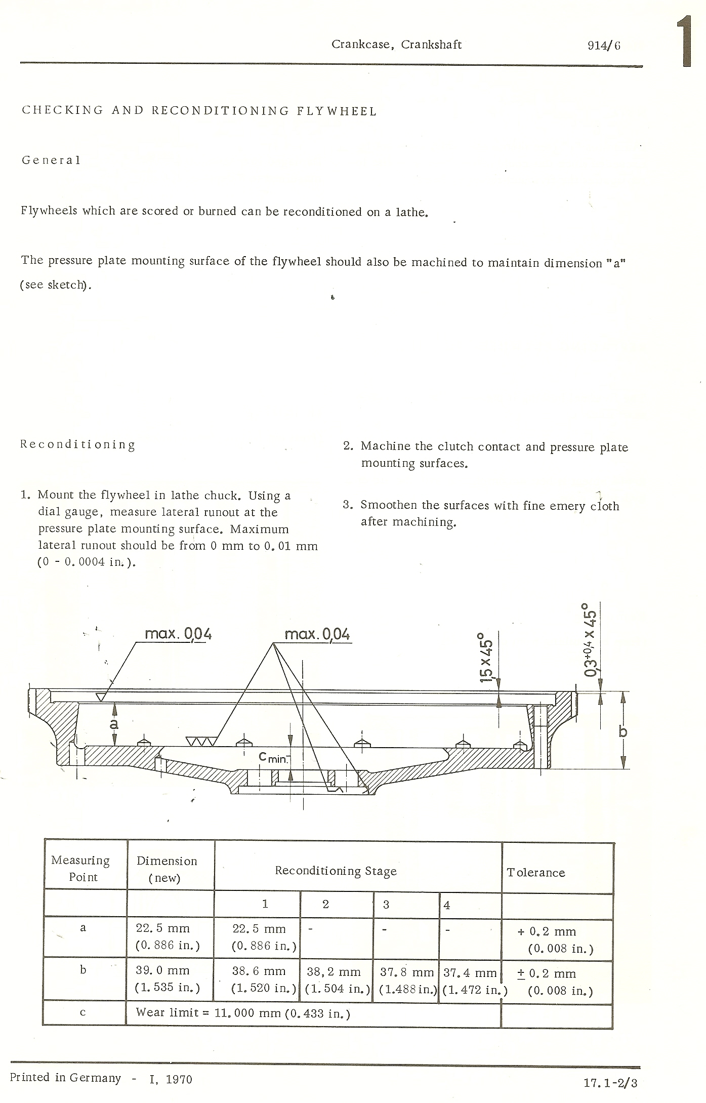

Resurface (assuming material is there to do so within factory spec) and move on.

As mentioned check flywheel for in spec measurements...if in should be fine..they are tough.
As for a lighter flywheel...there was a GT ones...here are pics.
