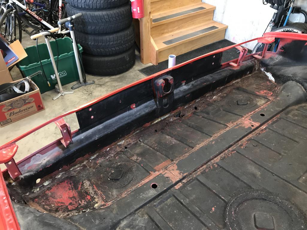

I realize most rebuilds go from the inside to the outside, but I am struck by how straight and clean the outer panels, including paint, look on my 73 2.0. And all the nasty stuff is hidden underneath--which I know is also not unusual.
Any way, I bought the car knowing most of what it was: a 2.0 with all the sport and appearance group equipment, including 5 good Fuchs, and the original fuel injection. The original engine is confirmed by a COA. In contrast to the exterior the interior was mixed at best, with some funky carpet. And the front and rear trunks (and engine compartment, and interior) had been sprayed with black undercoating.
So after a month, I have the car stripped to a bare shell, except for suspension and steering. I measured everything I could, and the body is very square and on spec. I need to patch some local rust spots, and replace the rear floor. And then do some minor straightening: right headlight bucket, front edge of right front fender, rear panel, etc.

bkrantz
post Oct 16 2019, 08:49 PM
Posts: 8,823
Joined: 3-August 19
From: SW Colorado
Member No.: 23,343
I forgot to mention that I will add some door braces before doing anything serious.

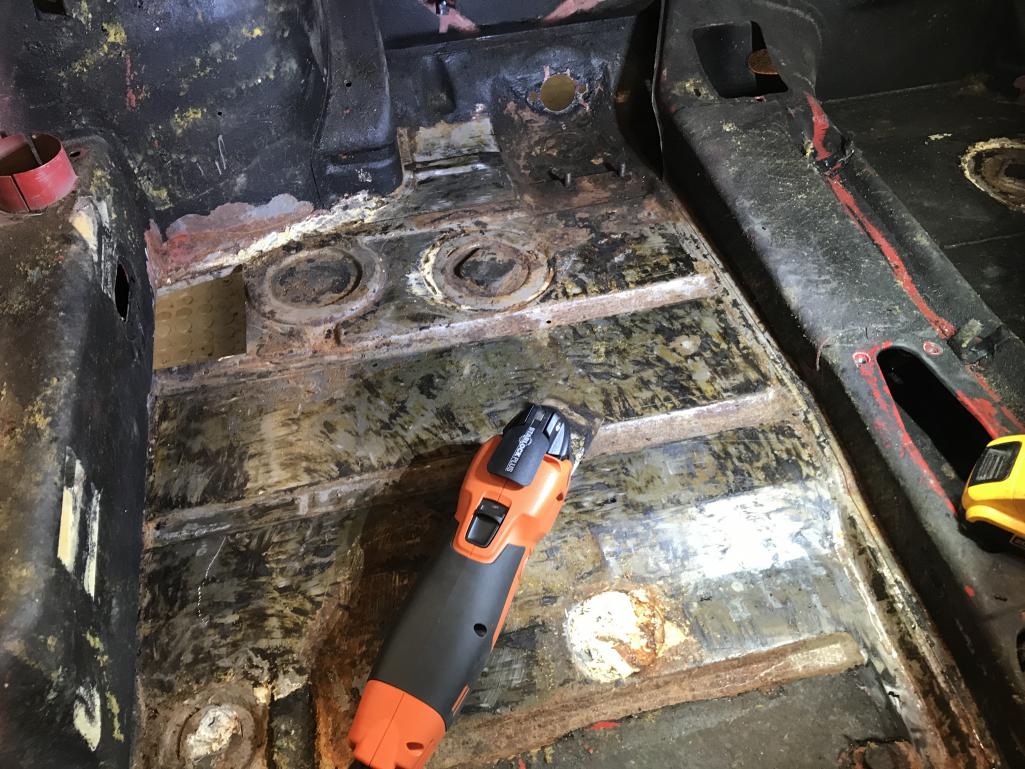

But I wanted to play with my new Fein tool. This thing is amazing for scraping off the floor tar mat: no effort at all to clear half the floor in about 20 minutes.

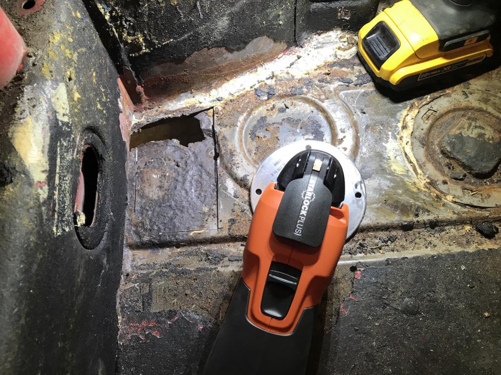

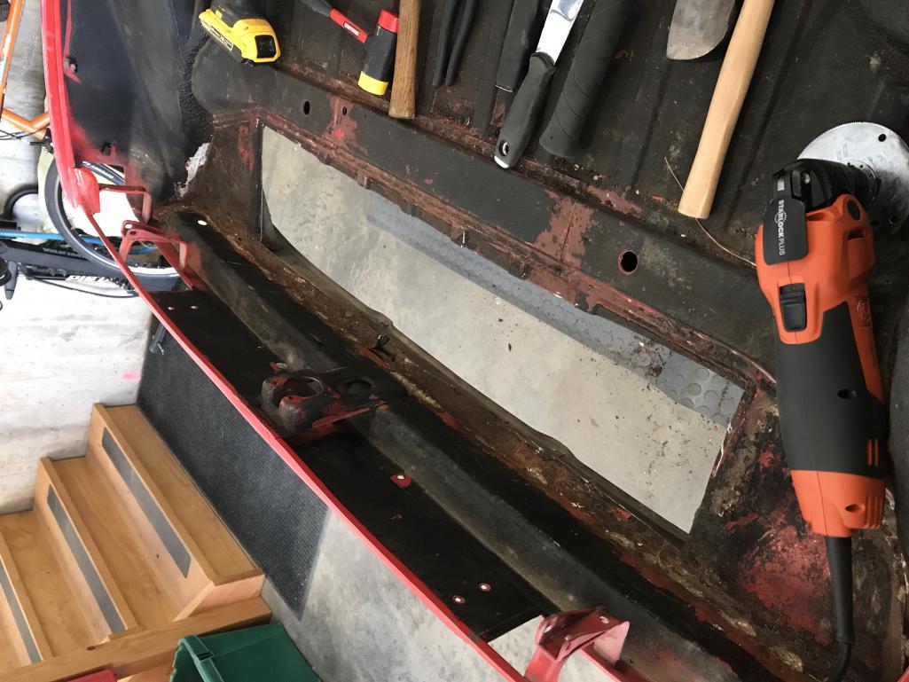

And I testing the Fein for cutting the floor sheet metal, using the round bimetal blade. This is a circle, but the blade does not rotate--it oscillates by about 5 degrees and cuts a straight, thin kerf very easily.
Mikey914
post Oct 16 2019, 09:31 PM
The rubber man
Posts: 12,786
Joined: 27-December 04
From: Hillsboro, OR
Member No.: 3,348
Use the dry ice method if you need to remove more tar. Works well to make an alcohol dry ice slurry and chip it off in large chunks.

pploco
post Oct 21 2019, 08:31 AM
Chief Toilet Flusher
Posts: 105
Joined: 15-June 18
From: boise, idaho
Member No.: 22,225
QUOTE(Mikey914 @ Oct 16 2019, 09:31 PM) *
Or use one of these - the tar will come off in big chunks
(IMG:http://www.914world.com/bbs2/uploads_offsite/shop.harborfreight.com-22225-1571668300.1.jpg)

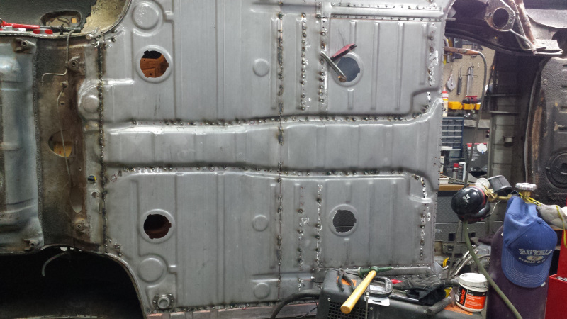

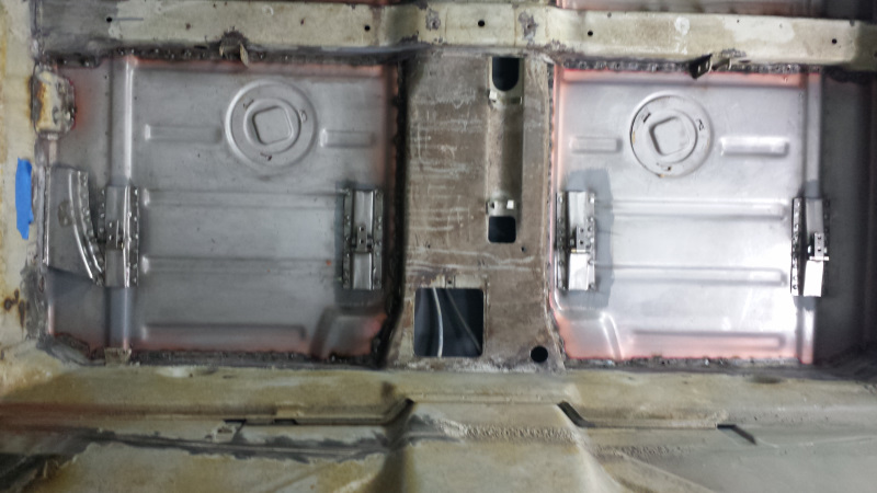

bbrock
post Oct 21 2019, 08:50 PM
Posts: 5,269
Joined: 17-February 17
From: Montana
Member No.: 20,845
The body plugs are important for separating the men from the boys. (IMG:style_emoticons/default/lol-2.gif) Other than that, they are just cosmetic at this point. I think they allowed access for the spot welder during assembly. I did find them handy for clamping the floor during replacement, but I was doing a full floor pan. They are a fair amount of extra work to cut and replicate too. Save your old ones though. Somebody might want them. I had to buy a couple.
(IMG:http://www.914world.com/bbs2/uploads/post-20845-1516648108.jpg)
(IMG:http://www.914world.com/bbs2/uploads/post-20845-1517377961.jpg)
Before ordering sheet metal, I would run boroscope inside those longs to have a look to be sure they look as sound on the inside as outside.

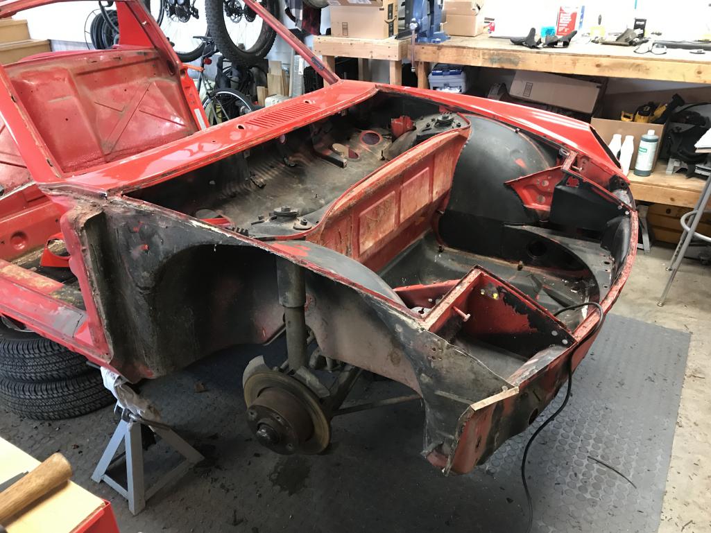

First, I finished cutting loose the front right fender. It is not original (nor was the attachment), but is in good shape (except for a ding on the lower front seam). Now I can access the inner fender.

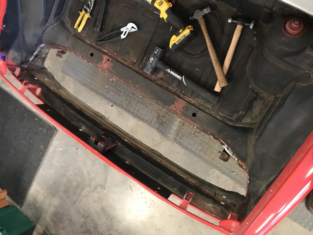

I was waiting for a delivery truck, so decided to make a rough cut out of the rear trunk floor. Still liking the Fein multi tool.

Cleaner cut for the rear trunk floor. Looks like the distance from the rear panel to the transaxle support cross member is short 1/4 inch, compared to the RD replacement panel.

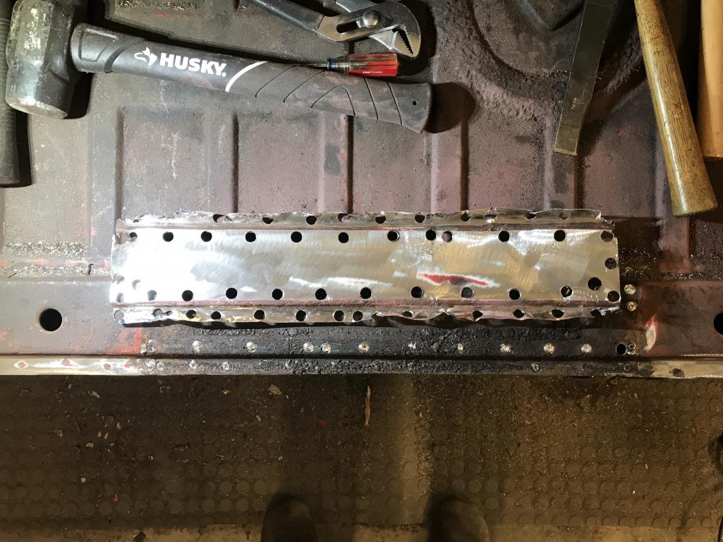

Testing my spot weld drill bit.

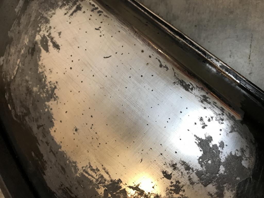

The bumpers, and all trim, were painted black. I wanted see the condition of the chrome underneath, so cleared a patch with paint remover. Looks OK except for the sanding marks!

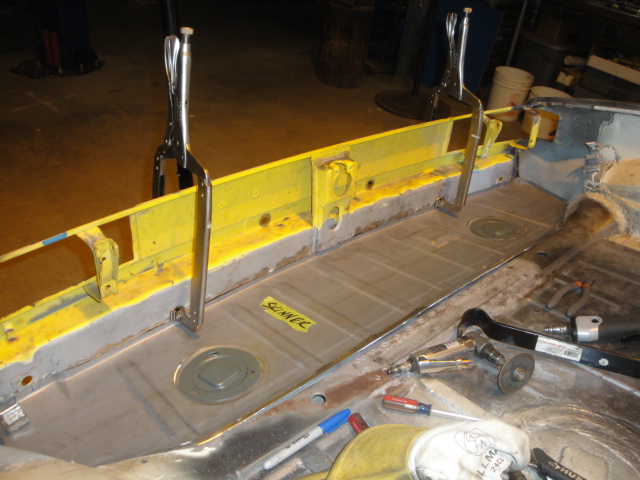

Garland
post Nov 11 2019, 10:37 PM
Restoration Fanatic
Posts: 1,438
Joined: 8-January 04
From: ......Michigan......
Member No.: 1,535

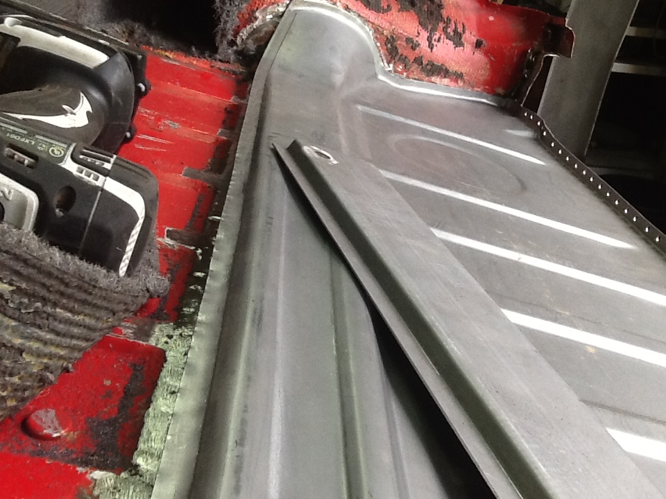

QUOTE(bkrantz @ Nov 4 2019, 10:08 PM) *
Humm. I have the same one, but mine does not have that lip over the cross brace. It just runs out straight. Did you fold it over to make the flange for the spot welds? Did you drill and weld in a nut in the cross brace, or just go with out it?
I bent the lip, and made the flange. I did not add the nut. Just be sure to line it up tight, before you decide where to bend. And that the small center cap fits the width.
Link to:My Build page on the trunk pan

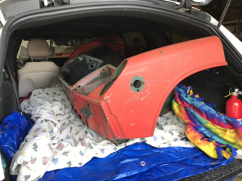

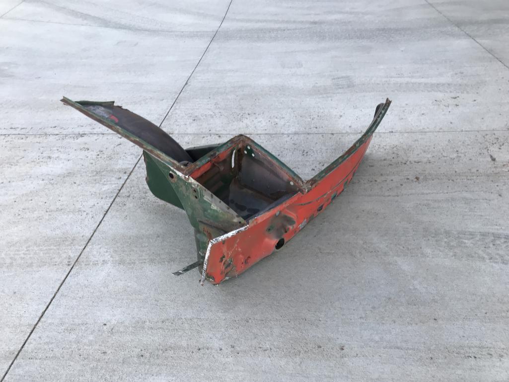

Brought home a donor clip to use to replace my right front corner. Thanks, Steve!

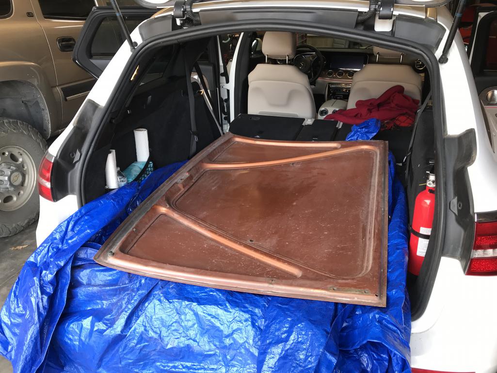

Also a rear trunk lid, straighter than mine and without rust!

Starting surgery on the donor clip.

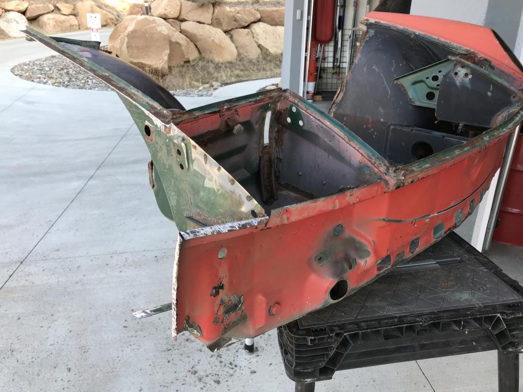

post Nov 17 2019, 10:21 PM
Posts: 8,823
Joined: 3-August 19
From: SW Colorado
Member No.: 23,343
Cut the donor clip down more. This is the largest section I might splice in, but still more thinking to do: what to save on the car (bent up but little rust) and what to splice in (straight but rusty in spots).
