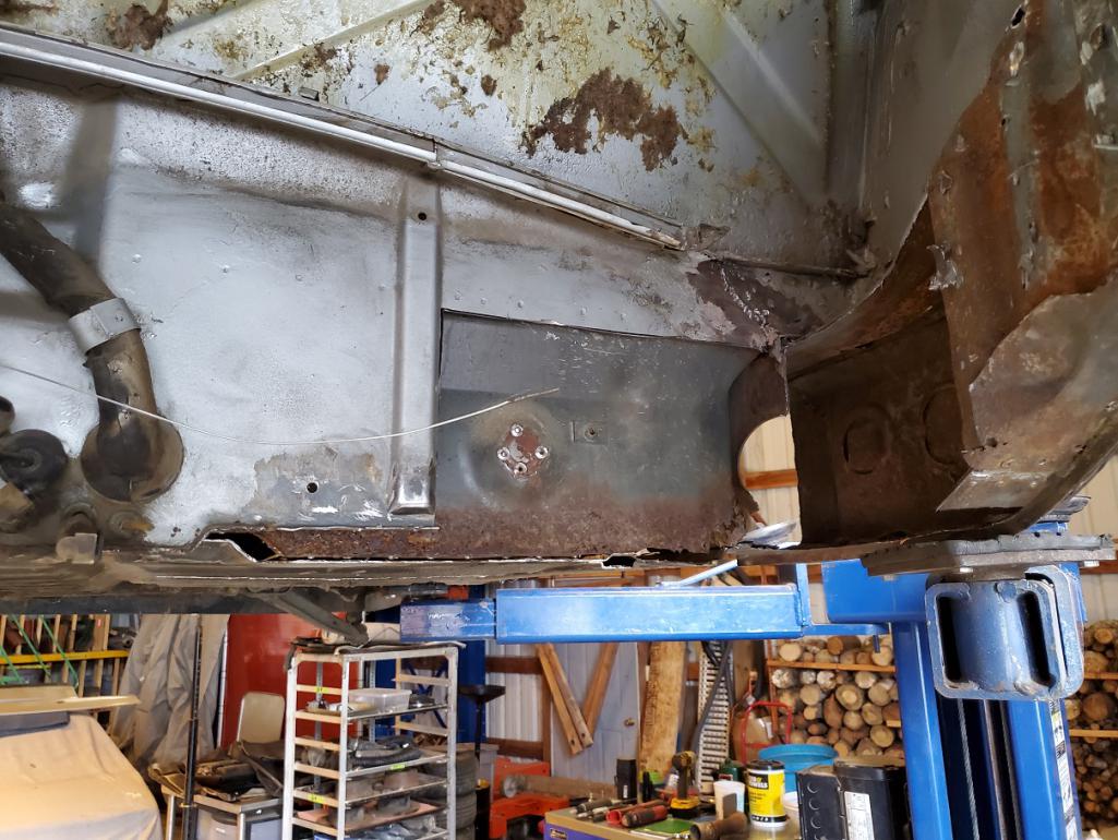

Starting point..
Here's the engine bay after the lie detector work and jack point removed.

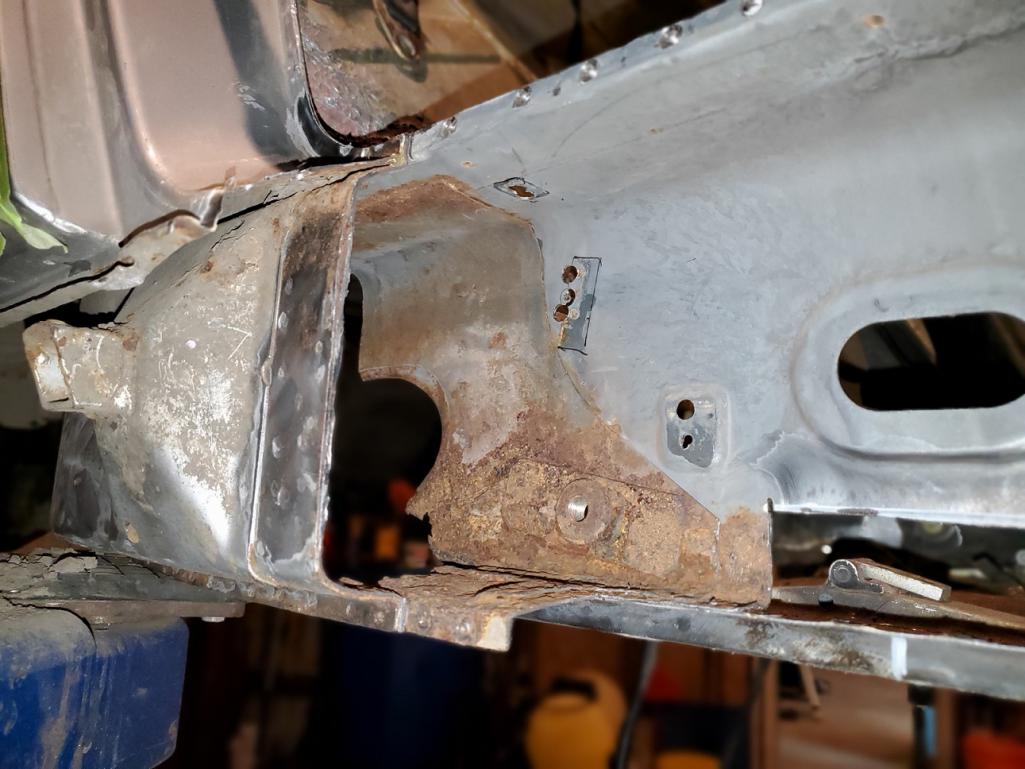

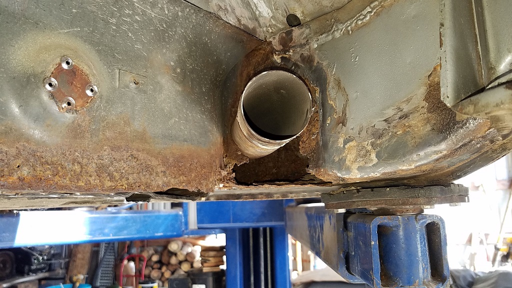

Time to start cutting my way in. But always thinking, how am I going to weld and encapsulate my way out.
I was hoping the damage was isolated to the jack point area. Not to be.
Off comes a portion of the floor. No window leakage damage. Just hell hole damage eating its way up.
Both inner and outer firewalls will need some patching.

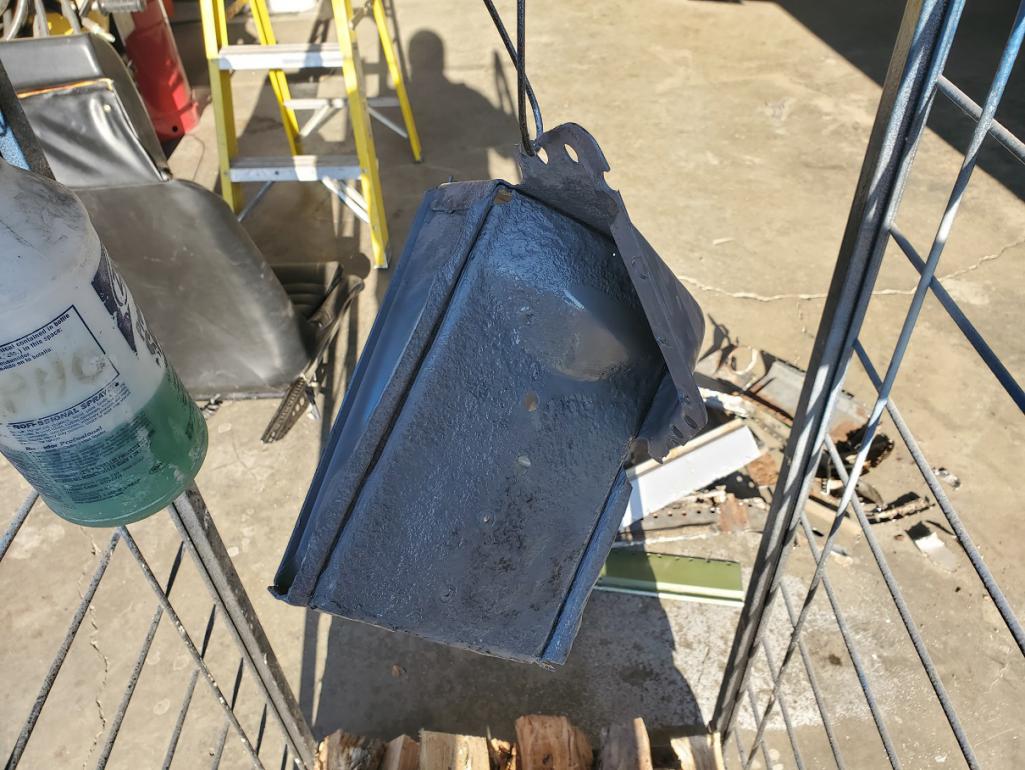

Trimming out the cancer in the engine bay.
After motor mount removed and treated with OSPHO. Ready for cold galvanizing.

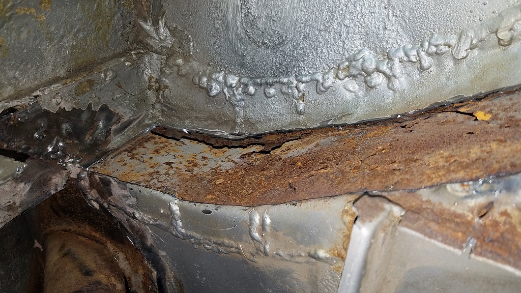

Member No.: 1,608

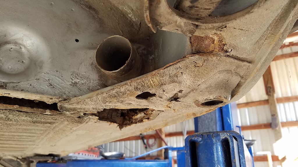

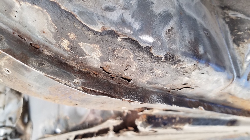

Here's a few shots of some other spots that will need some attention.
Hell hole was patched right over the battery acid rusty metal. 30 years ago.
This is a good shot of the usual battery acid rust damage.
Shows the 2 layers under the hell hole patch.
Here's shot of the damage to the outside of the upper long / wheelhouse piece.

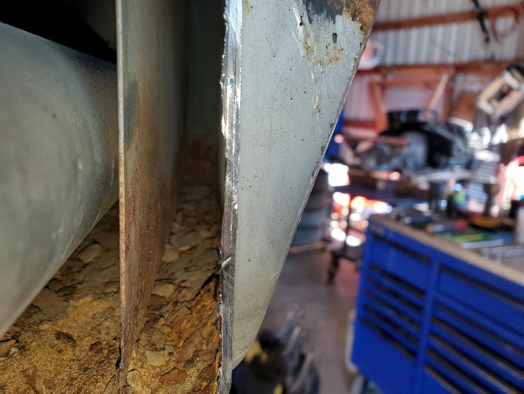

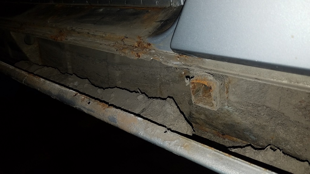

I figured it was about time I check the left rocker to before I submit my sheet metal order.
Packed with a mud/sand combo, but no rust. (IMG:style_emoticons/default/biggrin.gif)

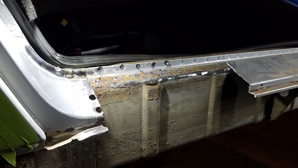

Now it was time to open up the long to see if I could do a partial repair/patch.
Not to be .................
cary
post Nov 25 2019, 10:21 PM
Posts: 3,900
Joined: 26-January 04
From: Sherwood Oregon
Member No.: 1,608

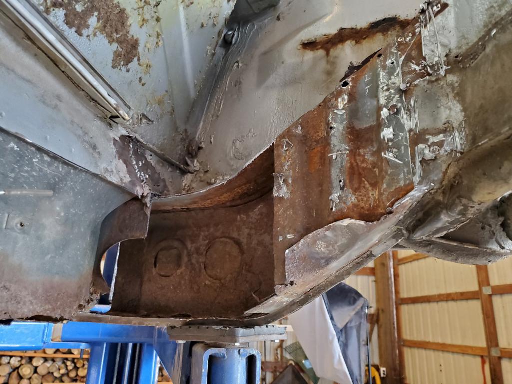

Now its time to get serious. Cutting open the long.
Then it was time to cut the cancer out of the long itself. (IMG:style_emoticons/default/mad.gif)
Using the 2 post lift I need to get the front arm out of the way.
Find my level.
With screw jack, raise the car enough to move the arm.
Took a .125" lift to move the arm.
Then dropped it back to zero.

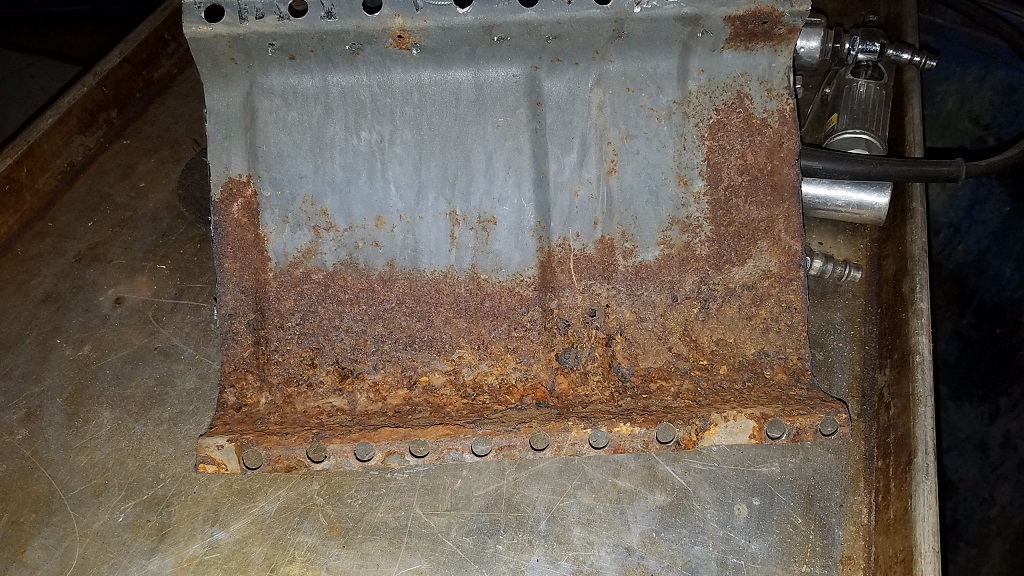

Swung for the fence on the floor pan and hit a home run. Absolutely no degradation on the floor pan under the long.
First a shot of the rusty long up to the edge of the floor pan.
A close up of what I removed.
Spot weld cutter drilling out the floor pan.

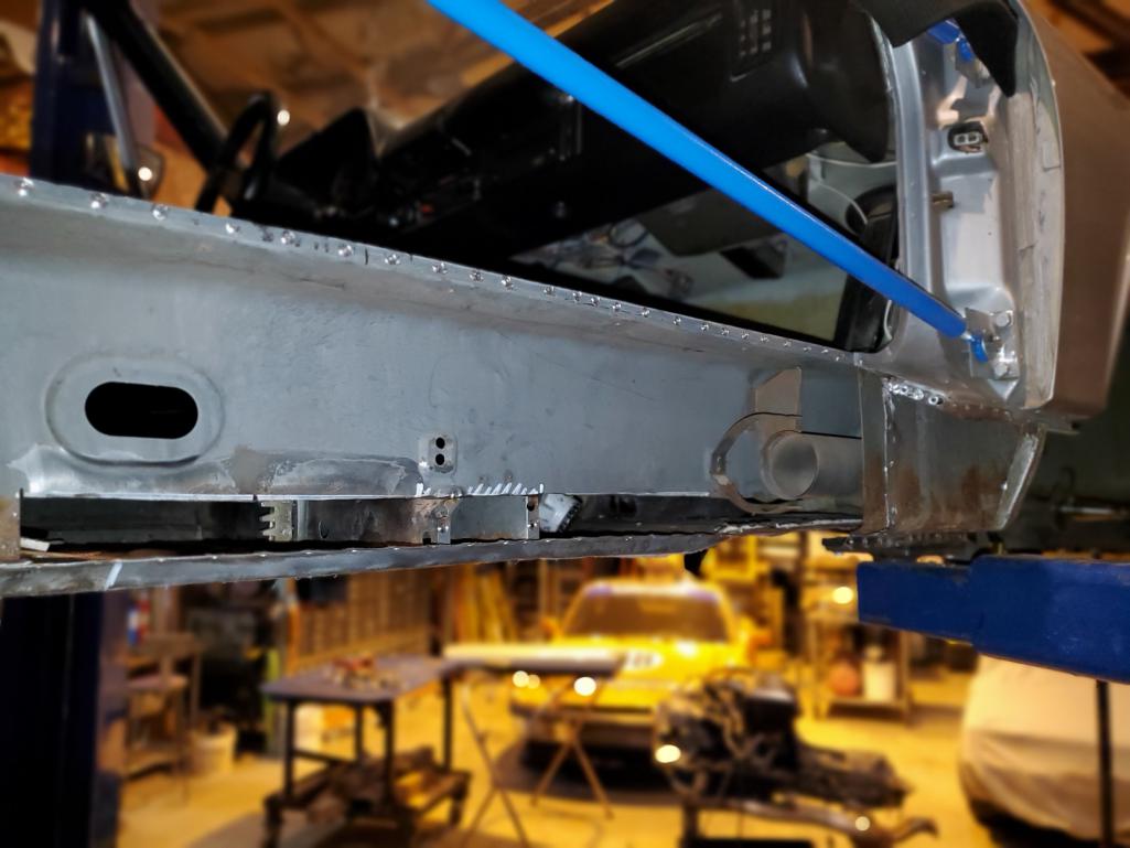

Long trimmed out.
Here's where we sit till the sheet metal arrives. Backbone won't be cut until I have 3 more screw jacks in my way. (IMG:style_emoticons/default/sad.gif)
