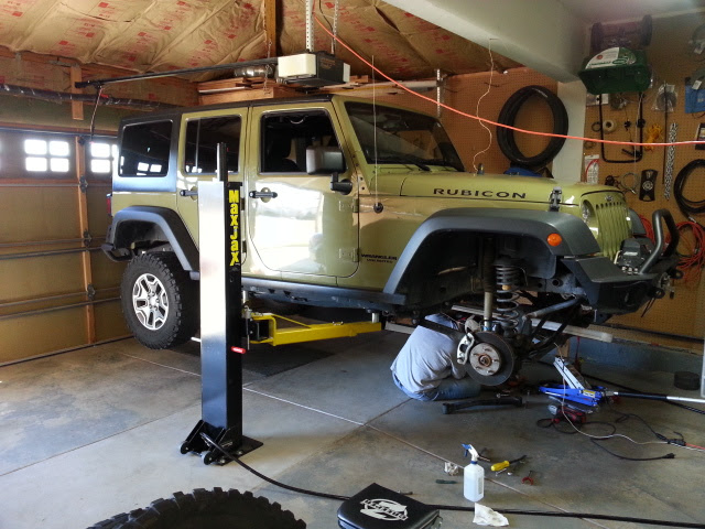

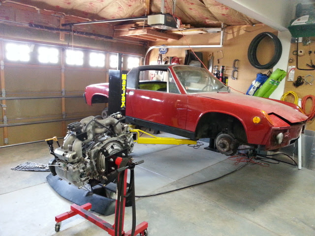

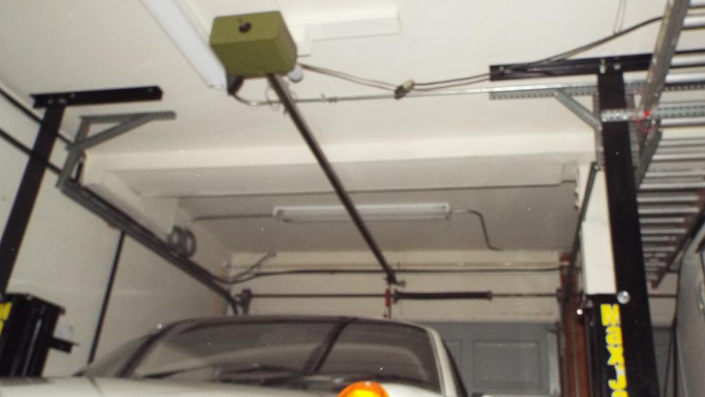

I really like mine. It makes dropping an engine out of the 914 a breeze. I would recommend verifying your concrete floor thickness before ordering one. The floor in my garage was poured to thin, so I had a section cut out and repoured 8" thick. I really like how easy it is to setup and take back down. It only takes about 10 minutes and it doesn't take up a ton of space.
It is to bad you live so far away. I am going to be selling mine. I am moving to Missouri where I am building a 50'x60' shop. I plan on purchasing a full size two post lift and will no longer need my MaxJax
Attached ImageAttached Image
A&P Mech
post Nov 27 2019, 06:31 AM
Posts: 401
Joined: 10-September 13
From: United States
Member No.: 16,371

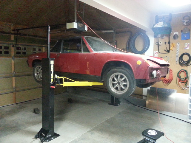

Here is a picture of my car with the lift at the upper lock postion. I believe it is 4 foot?

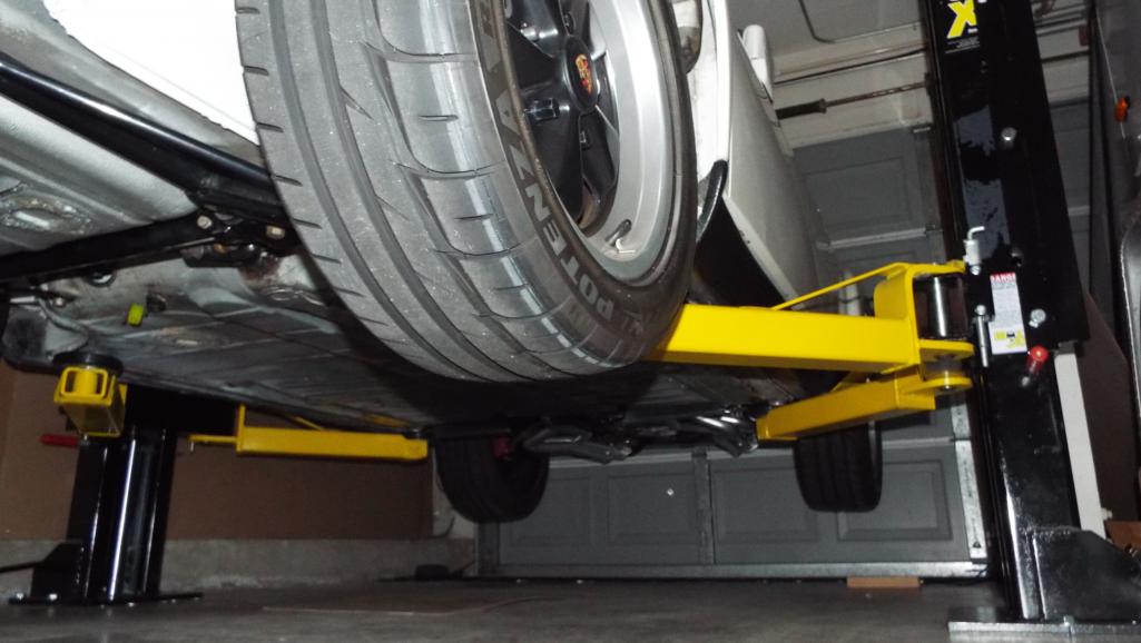

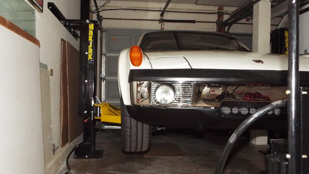

I did, I love it, and made my more permanent. I added structural steel to the ceiling as my 33 year old garage floor was not something I was tilling to trust with those 5 anchors.
Intended to be portable I came to learn that set up was crucial. Originally I thought I would install it on my side drive, just leaving the anchors in place, and putting the posts up when needed, but reading the instructions they want pretty much nats-ass alignment with all kinds of warnings. So I shelved it until I decided on the permanent install. I chose the single car side of my 3 car garage and although tight, it has worked out very very well. I can honestly say it has been a very useful addition and I use it all the time, because I can!
Up in the air
Because I wanted to mount it next to the stem wall, I also added wall attachment on that side as the cement pour for the slab was not done with the stem wall.
I created an "T" beam sorta out of 2" angle iron welded back to back and then tied those into the ceiling joist. Sorry about the blurry pic.
I also took the pump and tank and mounted it to the wall and ditched the cart.
With marks on the floor for car placement I can have my 914 up in the air in minutes.
Because the posts end up right where the door opens, I just back the car in a little further, get out and roll the car forward into position. Also, all these pics were from the install, I now back in all the time, which in my situation makes the getting in and out much easier. I have had my 911 on the lift as well. Love it!
Hope this helps for those considering.

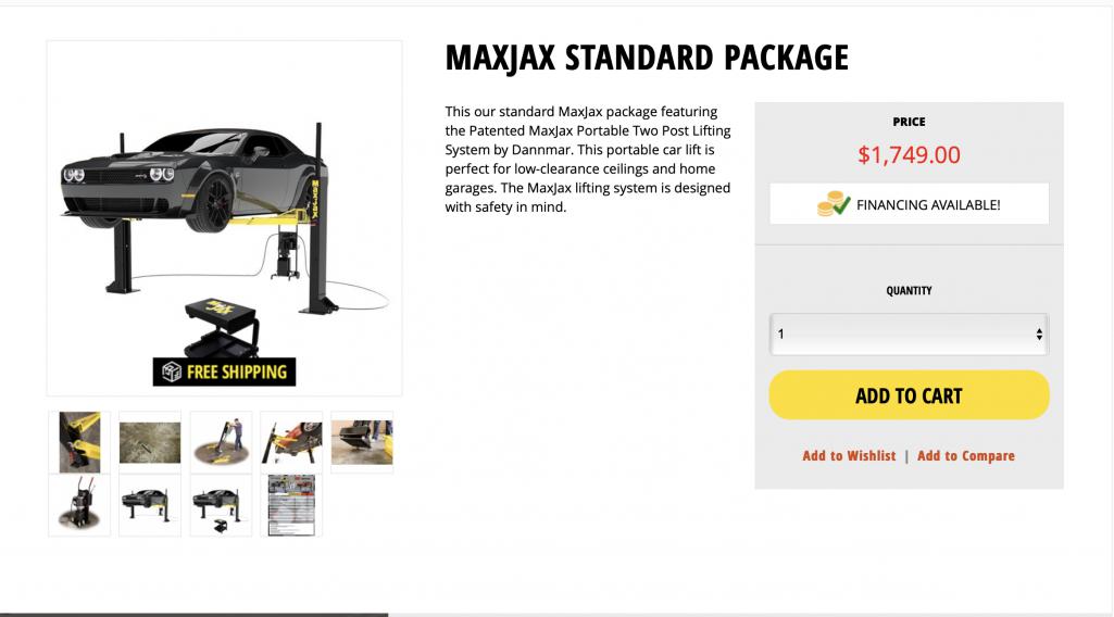

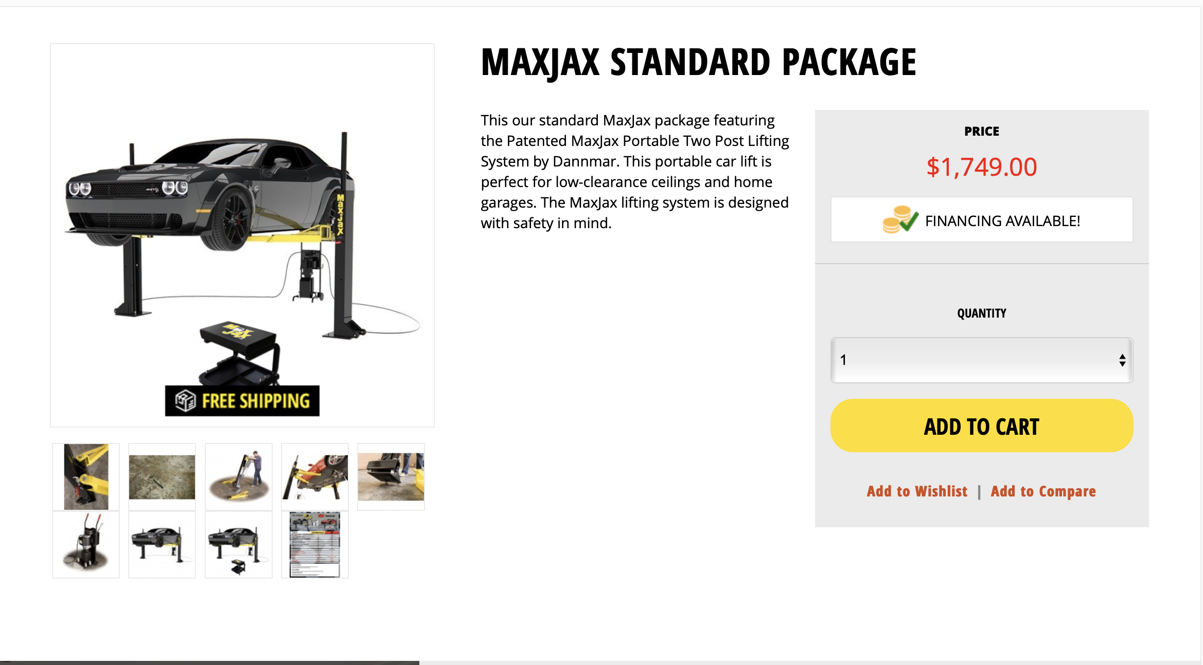

This is the last price I got MaxJack

Pulled the trigger a few minutes ago at 1749 ($18xx was added for lift gate service but shipping was otherwise free.)
