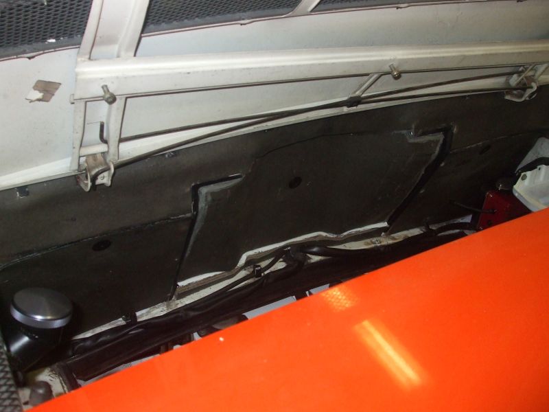

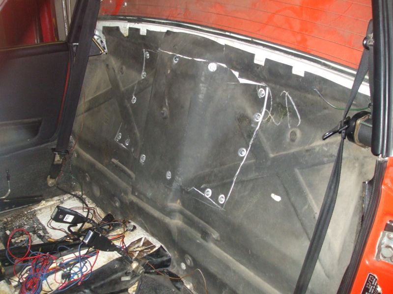

It depends, granted my car has always had a sheltered life, but when I removed the back pad I didn't find a speck of rust. I cut a BFH in my firewall for access to the /6 but when it was done I cut to fit the stock back pad back in place. I installed it a half inch high at the bottom just to be sure water can't be trapped there. I also cut and replaced the inner rubberized tar mat.
I have a weber /6 with a stock 911 banana, my interior noise levels are good, you can carry on a normal conversation with a passenger. I'm keeping the pad.
BTW the "BFH" in this case = Big Fuching Hole
