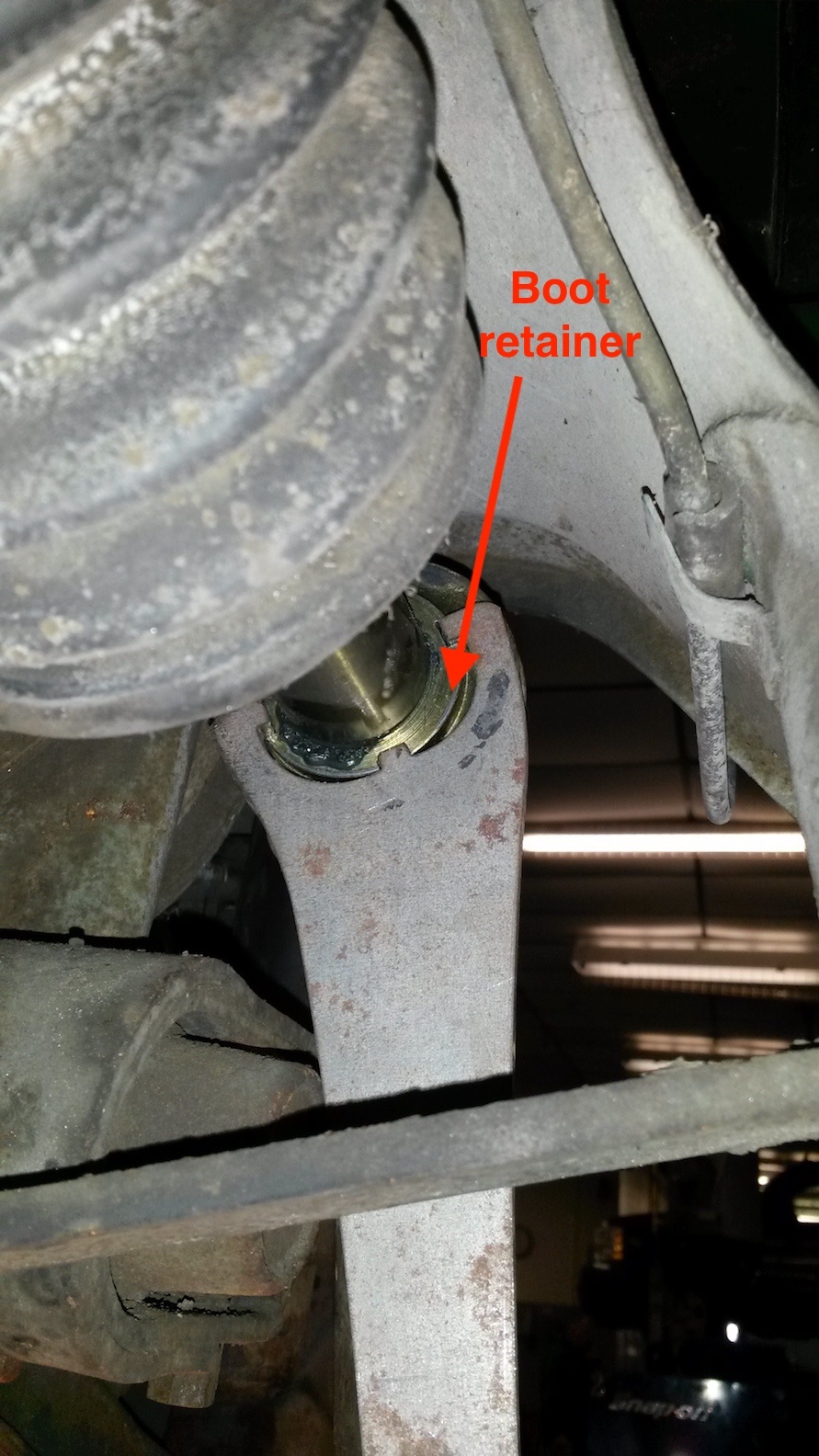

With the tie rod hanging down, I pushed the outer end of the old boot back (towards the center of the car) and off the retainer. Left the spring on the boot for safe keeping. I used the "group buy wrench" to loosen the boot retainer.
Another view...
The wrench fit the boot retainer well and made loosening it easy. Observation: I think retaining the boot is only one function of this piece--given that the boot retainer is threaded and tightened to 51ft-lb (per Haynes, page 99), I think it also serves as a "jam nut" for the tie rod eye bolt. Too bad it wouldn't fit inside the new boot, or I'd have been tempted to reuse it instead of the new spacer.

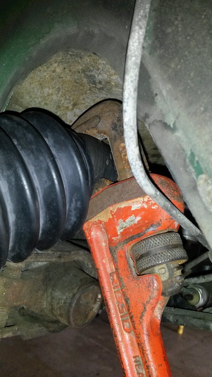

I used a little brake cleaner on a Q-tip to clean out the hole in the end of the rack, put a little thread locker on the threaded end of the new tie rod and screwed it up snug. Then I used the Group Buy wrench to tighten it up:
Haynes (page 99) lists the tightening torque for the eyebolt as 34 ft-lb, so that's what I was shooting for. About the time I thought I was close, I could feel the end of the wrench start to open up... (IMG:style_emoticons/default/dry.gif)
I was really being pretty careful, so I don't think it was a "Bullwinkle" ("Don't know my own strength") moment.
I used the channel lock pliers to make sure the new tie rod was tight.
Lesson learned (again)--have a small pipe wrench on hand for next time.

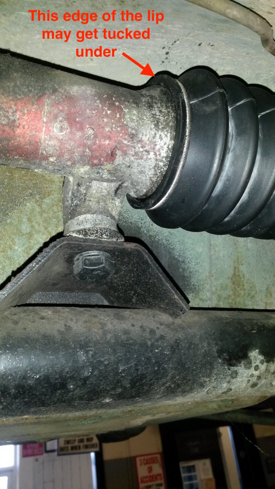

As far as installing the boot, it went easier than I expected. I used glycerin as a lube, both around the outside of the rack housing and the inside of the boot. Highly recommended--glycerin is slicker than deer guts on a doorknob, and it won't harm the boot. I just kind of pushed and twisted/rotated the boot onto the rack housing (a little past where it is supposed to go) and it popped on. That said, I had to pull out on it with a pliers while easing it back down the rack housing a little to free part of the lip that had gotten tucked under. Once it was in place, I was able lift the retaining spring onto the lip with a small screw driver, then roll it on the rest of the way with my thumb (rotating the boot helps as you walk the retaining spring into place).
The outer end of the boot rides on a black rubber collar/disc on the tie rod. Once again, glycerin is your friend--used on the disc and on the inner lip of the boot. I pushed the boot lip onto the top of the disc with my thumb, then worked the rest of the onto the disc by pulling out on the boot with pliers while pushing the lip onto the disc. Sorry, it sounds more confusing than it really is...
That said, it does take some pressure to get the boot in place. On the driver's side, I actually displaced the rubber disc a little; if that happens, just pull it back out the tie rod into the indentation where it belongs (indent is bare metal in this picture).

Use the pipe wrench to tighten it to ~ 43 ft-lbs.
