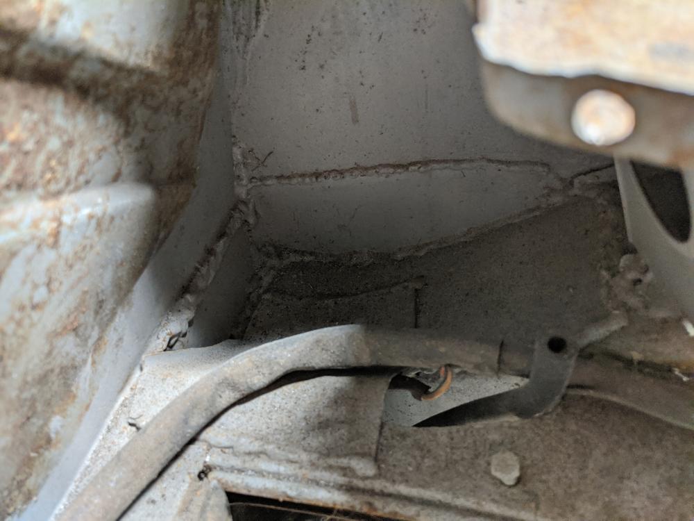

Hell hole looks ok, this is what I welded in a long time ago with rustoleum over the top. I'll likely end up cutting most of this out and replacing it with a cleaner repair piece after I get door braces on. I'm planning on using POR 15 for the trunks, floor pans, and wheel wells. I like fluid film and will probably coat everything inside and out with it when everything is done.
(IMG:http://www.914world.com/bbs2/uploads_offsite/i.imgur.com-23821-1581119599.1.jpg)

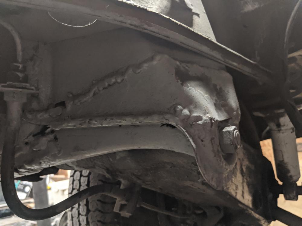

Suspension console was "repaired", but not well. I have the replacement piece to weld in:
(IMG:http://www.914world.com/bbs2/uploads_offsite/i.imgur.com-23821-1581119599.2.jpg)

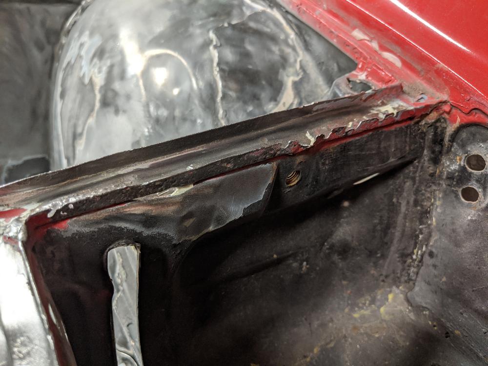

Some of the hood seal channel is rusted out, I'm going to try making some repair sections with 18/20ga steel and a harbor freight bending brake. Fortunately it looks like only one side will need to be replaced in any given place:
(IMG:http://www.914world.com/bbs2/uploads_offsite/i.imgur.com-23821-1581119599.3.jpg)

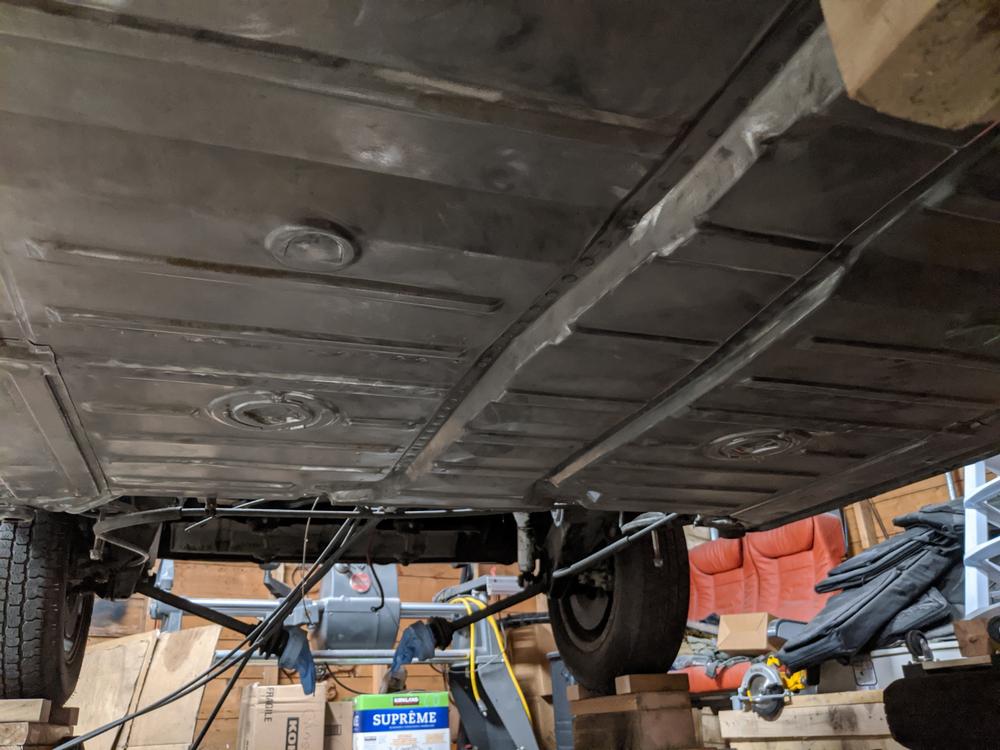

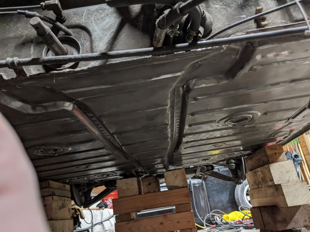

Floors are very solid, you can see my failsafe support in the middle of the two jack point supports:
(IMG:http://www.914world.com/bbs2/uploads_offsite/i.imgur.com-23821-1581119599.4.jpg)
(IMG:http://www.914world.com/bbs2/uploads_offsite/i.imgur.com-23821-1581119600.5.jpg)

If you have the bottom that clean use epoxy paint or get some DuPont Nason black truck paint and a cheap can of urethane catalyst. It's a spray paint so it's a bit thin, but it does go on with a brush OK. It flows out so you can hardly see the brush marks, do 2+ coats.
I'd wash it with some Krud Cutter to keep it from rusting till you get the paint on.
Better than Por-15 IMHO, I've seen and have Por-15 on my bug pan, couple areas came off in a whole sheet. I won't use it again.

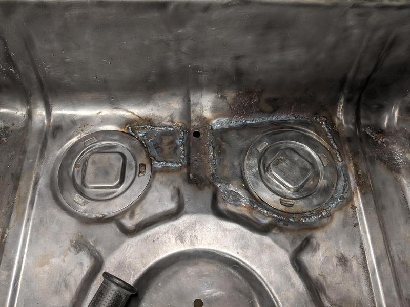

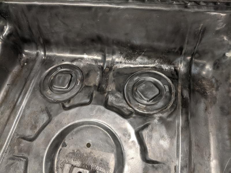

Front trunk patches welded in:
(IMG:http://www.914world.com/bbs2/uploads_offsite/i.imgur.com-23821-1581821437.1.jpg)
Welds ground:
(IMG:http://www.914world.com/bbs2/uploads_offsite/i.imgur.com-23821-1581821437.2.jpg)

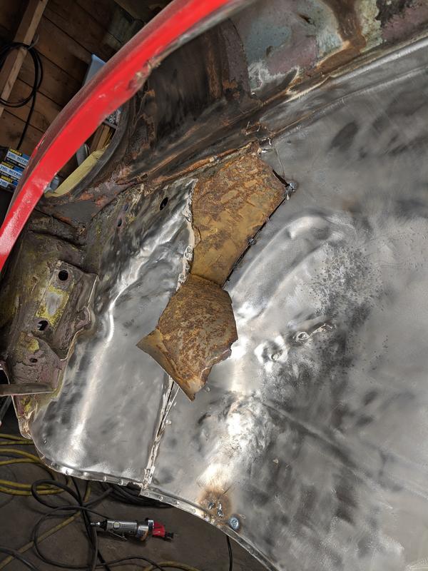

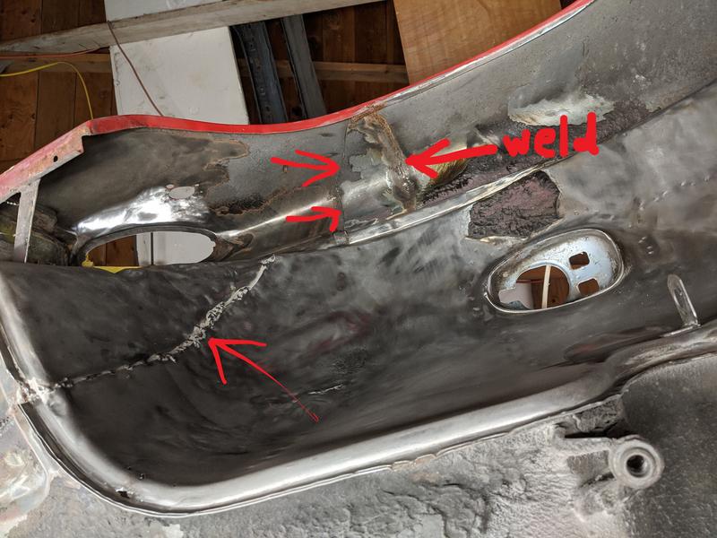

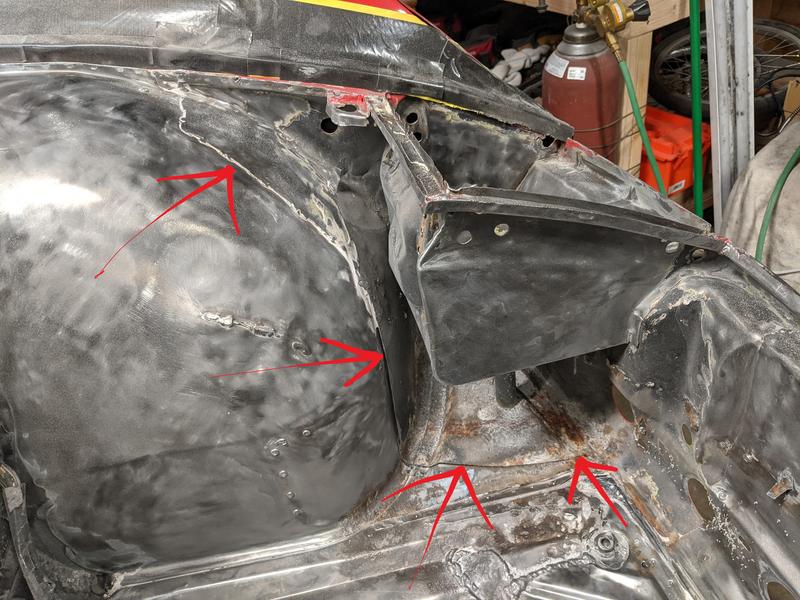

The driver's side front corner was repaired with a welding in section. Unfortunately, the repair was less than perfect and there are large areas of overlap (similar to a lap joint) that are welded on only one side and have rust in the gap. I'm starting the process of cutting through the welds, trimming the overlap, and re-welding with butt joints.
(IMG:http://www.914world.com/bbs2/uploads_offsite/i.imgur.com-23821-1581822473.1.jpg)
(IMG:http://www.914world.com/bbs2/uploads_offsite/i.imgur.com-23821-1581822474.2.jpg)
(IMG:http://www.914world.com/bbs2/uploads_offsite/i.imgur.com-23821-1581822580.1.jpg)
bkrantz

Thanks for the offer, I think I can save this one and preserve the paint job. For the fender portion that is under the paint, I'll just trim the loose end and wire wheel the rust off.
I bought some BAR-RUST 235 epoxy primer and Devthane 379 that will be going over everything under the car and in the trunks.

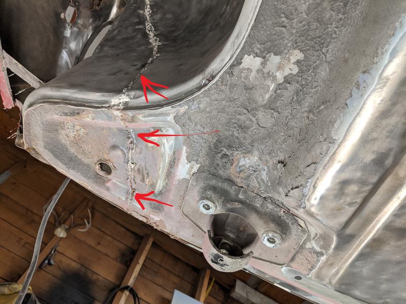

Slow going, but finally got to peel back some of the overlapping bit under the driver's side fender. Lots of dust and rust between the metal.
(IMG:http://www.914world.com/bbs2/uploads_offsite/i.imgur.com-23821-1583123934.1.jpg)
