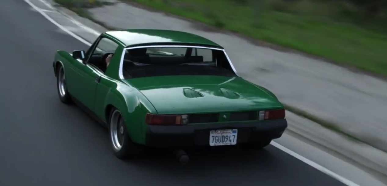

@Mueller check out Tylers installation:
https://flatsixes.com/cars/porsche-914/this...orsche-passion/
- Tony

Good Luck ...he got his claim to with the video....does not respond...I too have a rear mounted oil cooler........
