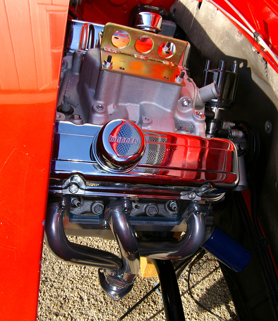

Got the engine & transaxle into the car, bolted up at the back, and ready to fabricate a few minor parts to make the new forward crossmember mate to the body. The forward crossmember was bought from Speedway Motors in Lincoln Nebraska for a grand total of $58 to my door (http://www.speedwaymotors.com/). The crossmember clears the shift linkage just fine. (IMG:http://www.914world.com/bbs2/html/emoticons/mueba.gif)

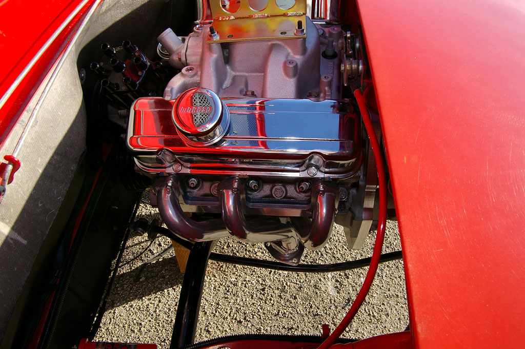

And another

And another

NICE!!! And I don't think I have EVER seen such a clean transmission.. what did you do to it? (IMG:http://www.914world.com/bbs2/html/emoticons/smile.gif)

And another

That is one funny looking carburetor!! (IMG:http://www.914world.com/bbs2/html/emoticons/lol2.gif)

Have you figured out how you'll make the bend off the header to clear the shift bar?

QUOTE (bondo @ Jul 5 2005, 09:06 AM)
Thank you for the compliment.
I covered the input and output shafts, shifter, and vent hole with old socks and ductape then sand blasted it thoroughly using 30 grit silica sand. I tried just about everything else but nothing seemed to get it clean so I went the sandblast route. It worked out great.

QUOTE (914GT @ Jul 5 2005, 09:12 AM)
There's a little more room than it looks like in the photo for the header to clear the linkage. It'll take a tight bend of the exhaust pipe right off the header flange but that shouldn't be to difficult for a good exhaust guy, and we have a pretty good one here in Boise.
Funny Clay... yeah, it's a side-draft 3-barrel.
Nice job Don! Looks damn nice.

How did you end up modifying your front mounting bar to get the engine to sit up higher? Looks like it fits in there real nice. Did you have to cut off the end of the waterpump shaft for any extra clearance at the firewall?
