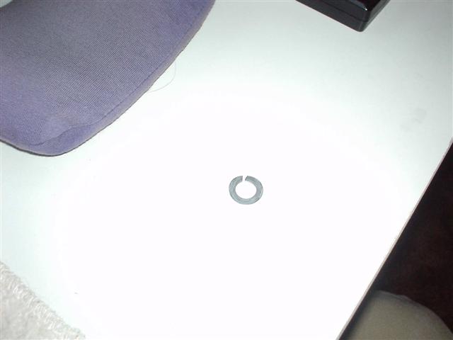

So here's a picture of the problem.
I took the valve covers off, and the #1 rocker assembly was completely loose meaning the valves were not opening on it. I pulled the nuts off and the rocker assembly out, and when counting the pieces noticed i was one washer short. I found it down in the pushrod tube near the lifter and extracted it with a magnet tool.
these little bass turds came from my FLAPS and worried me when i bought them. The guy said they were fine and i believed him. Cheap compared to the hardened german ones i'm used to, and it broke of course.
Any predictions?
a little oil smoke never hurt right?

b.
Sorry, for the scare, it's not a flat cam, it's something simple.
I'am glad it was an easy fix, as I'am sure you are. (IMG:http://www.914world.com/bbs2/html/emoticons/biggrin.gif)
