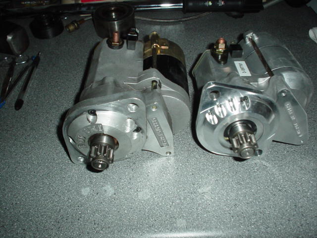

Here's a pic of two IMI starters purchased from the same place. They are clocked different but both worked in my v8 conversion.
I'd try to reclock.
