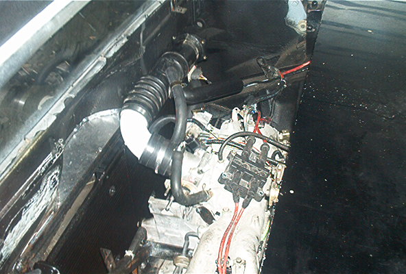

does anyone have some pics of a suby conversion? I have been dying to see one. I have seen some sick motors for the sand, and have been curious if it would work in the rust bucket.

here ya go, engine bay shot

QUOTE (scott thacher @ Jul 6 2005, 05:59 PM)
was there much body mod to do or was it all in the engine bay? .......Now honestly how bad was it to pull off?

no body cutting at all, just removed the engine shelf to clean up and give a little more space. i could do it again in 50 hours or so from scratch

QUOTE (scott thacher @ Jul 6 2005, 06:28 PM)
I may have to start looking in the corners of these little salvage and wrecker yards.......I wanted to run one of the ea82 1.8s in the magic bus. It had a 1.8 rabbit 8v in it now so I may just see if there are ANY performance parts for the sube out there......The ea82's were tough as nail but didn't make much HP. Not enough to justify the conversion, anyway
