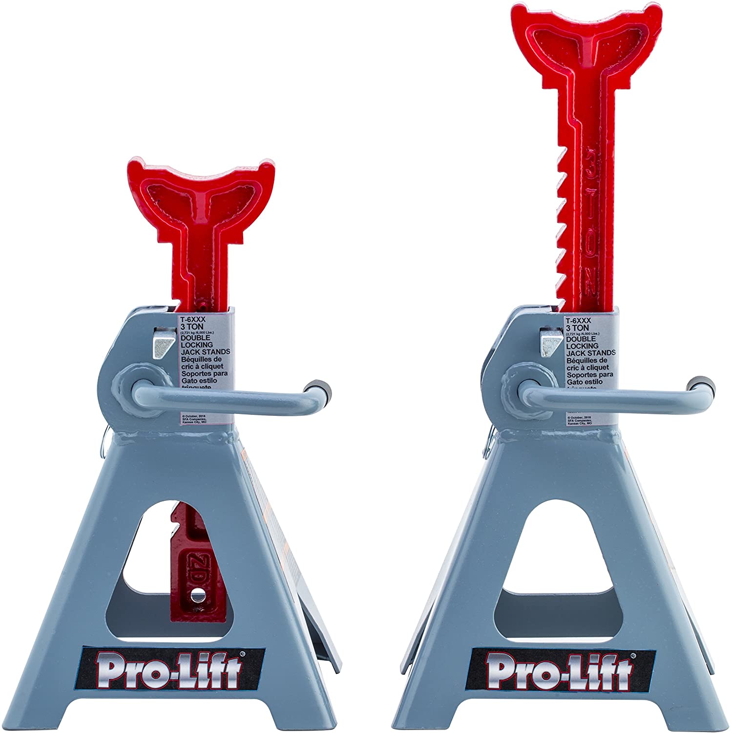

Looks like you can now get hybrid ratchet / pin stands for about the same price. I can only imagine the insurance claims that forced this redesign...
I purchased this exact set after watching a YouTube video of a guy testing the story of a guy dropping his 914 on himself by releasing a non pined stand accidentally with a long screwdriver caught in the release lever. His test proved it possible.
I have a set of Strongway brand jackstands that are the same design. Somebody posted here about them when I started my build a few years ago. I'm glad they did because they are really nice stands. Easy adjustment of a ratchet with the security of a pin. I highly recommend them.

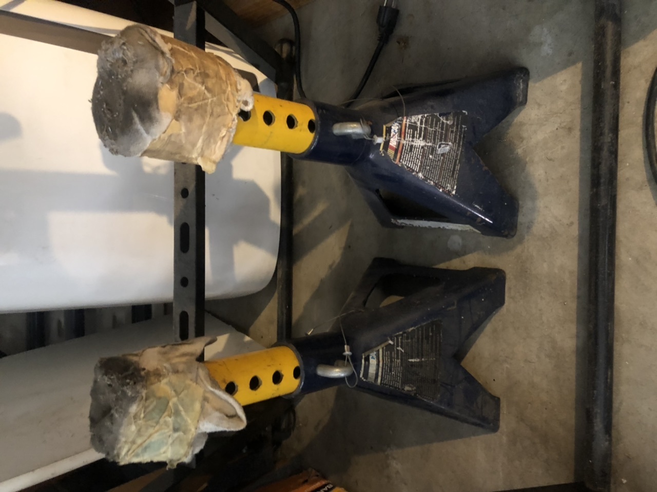

My preference.
https://www.amazon.com/gp/product/B0019JVIP...=UTF8&psc=1
