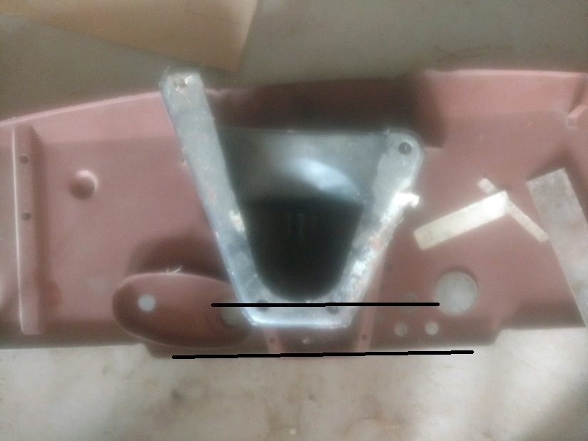

sixnotfour
post Jun 6 2020, 03:03 PM
Posts: 11,449
Joined: 12-September 04
Member No.: 2,744
The real measuring point would be from the floor weld flange to the two bottom holes of the mount.. is 3 inches up from weld flange.
that's my factory piece..not bolted together in photo, yes my crapy photo.
