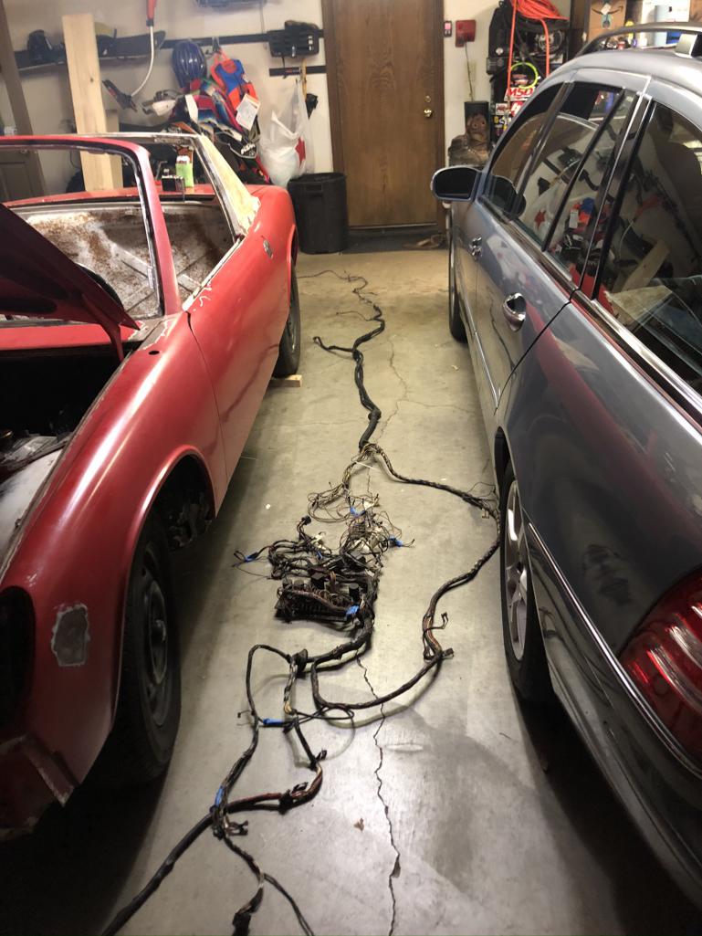

Picked up project car about 2 weeks ago. I'm very excited to get started on this build, I'll try to document and share my progress as I go. I originally created a profile here at 914World back in 2006 when I was in High school, and had bought a 74 914 as my first car for $1200. It was a great first car, I had a lot of fun fixing it up while using it as my daily. When I went off to college, I sold the car, but felt like I had unfinished business to do.
Recently I started lurking here again looking to get back into a project 914 to hopefully take the car where I wanted to, but didn't have the funds, skills, or space to do so.
I posted a WTB ad, and was contacted by a member here who had a good start to a project I plan on finishing (Thanks Montreal914!)
My plan is to build my dream 914 that I absolutely drooled over when I was in High School. I've always loved the GT look, so my plan is to basically create as close to a GT clone as my budget will allow. Steel GT flares, 5-lug Fuch's (or replicas...) and a tastefully somewhat period correct interior. The car I recently purchased did include a freshly rebuilt 2.0 4cyl engine, so I need to make a decision on if I would want to run that engine for a while, and save my pennies to slowly build a 2.2, 2.4 or 2.7 flat 6 then do a swap later down the road.
I'm happy to see the 914 community thriving. Back in 2004 when I first bought the 914, Porsche snobs seemed to turn their nose at them which made them affordable enough for a high-school kid to own one. It seems like the 914 is getting more recognition in the collector community, so I'm happy I picked one up before they become too out of my price range!
I'll post some progress photos tonight and general status of the car tonight after work, but here's a few shots of the day I unloaded it off the trailer.

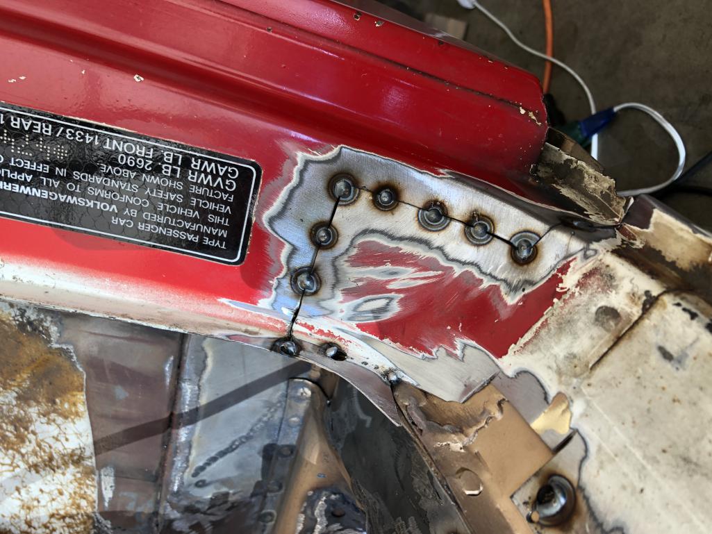

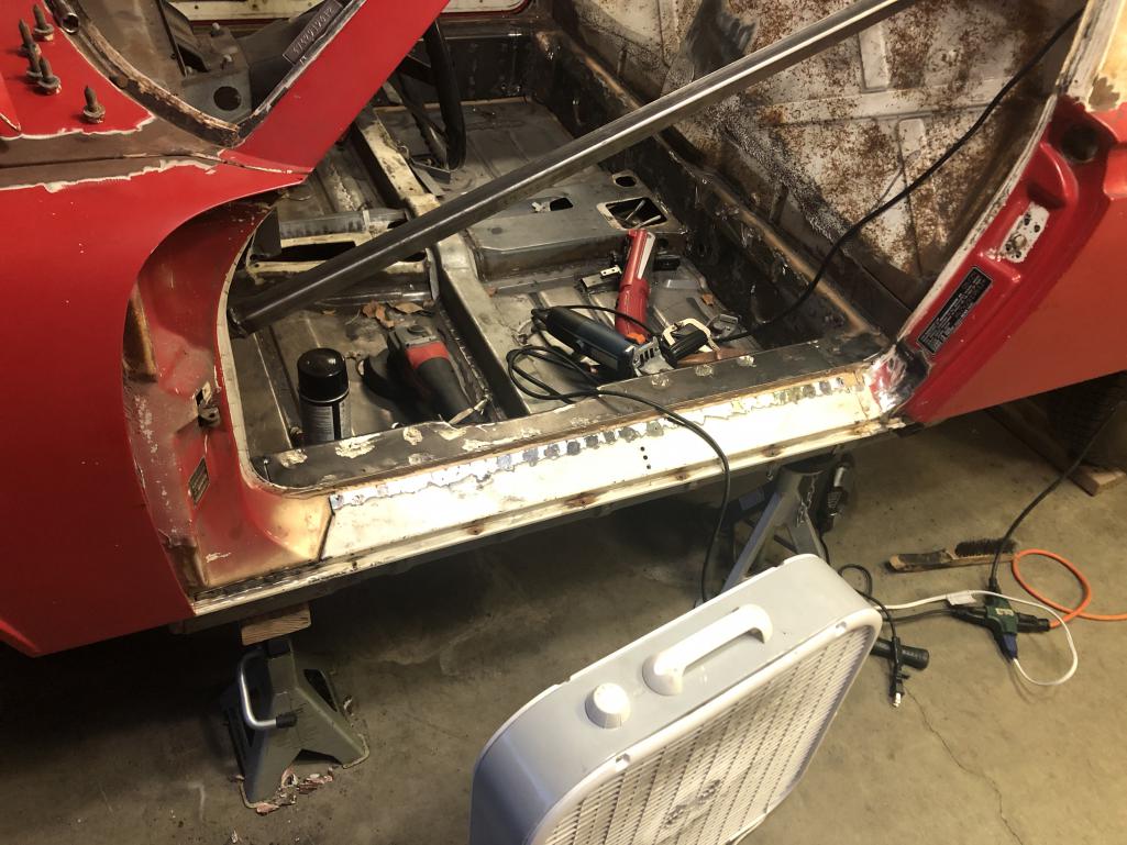

Previous to the last owner, the rear floor pans, hell hole, battery tray, and part of the fire wall were repaired using panels from restoration designs. Which works great for me, because I have some welding experience, but almost none with thin automotive sheet metal. It would have been a brutal learning curve to attempt to fix everything on my own, so I'm happy to report the car is virtually* rust free.
Inner and outer longitudinal stiffening kits were installed before I acquired the car, however the inner kit (Engman?) did tweak the pan to close the gap between the windshield frame and the roll bar by about 1/8" on each side. (Measuring 25" almost dead even on each side currently) So the door gaps are a little off as well.
It looks like this is a know risk of installing this kit, and it looks like a few members here have been able to correct this issue by simply making a few strategic cuts in the stiffening kit, jacking the car then re-welding it back into place.

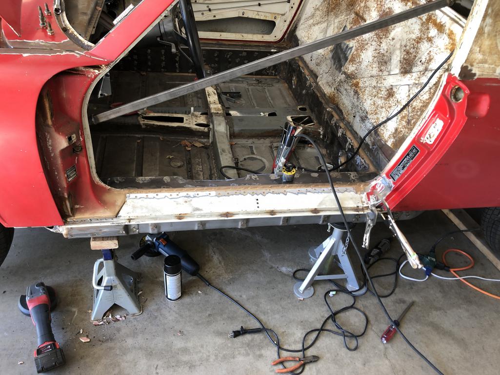

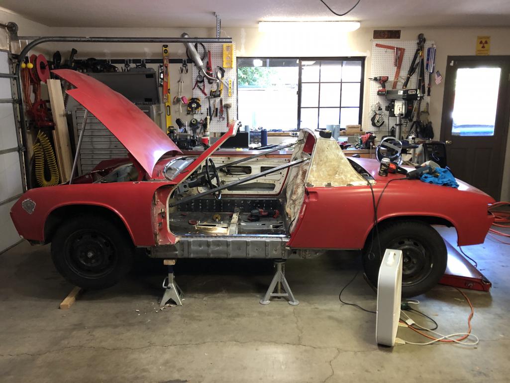

Summer is the busy season for work, so I haven't had much time to work on the car, but I was able to create door braces, and weld back the lower door panels that were removed to install the outer long stiffening kit.

Next move: Steel Flare installation :-)

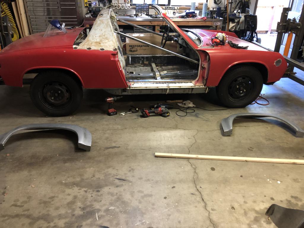

Made some progress on adding the flares. Still a bit of a luddite for finding the best way to share photos here...

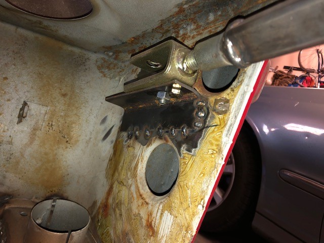

Question and request:
How did you attach the door braces under the dash?
Would you show some pictures of that area.

Thanks for the kind words! I certainly wouldn't mind going back with Light Ivory. I originally picked up a 2.4 "7R" engine, but I found a pretty good deal on a 2.7 engine from a 75 that should kick this thing along just fine.
The PO did the inner and outer stiffening kits, so I never got to see how the original longs looked before they got encased. Judging by the rest of the car, I would imagine they had little notable damage. See below for how I attached the door brace to the front of the car. I made it so it (shouldnt) be difficult to dremel cut the weld tacks then grind flat like it never happened.

Perfect. Just what I needed.
Been thinking of something similar but helps to see it done already.
Thank you!
