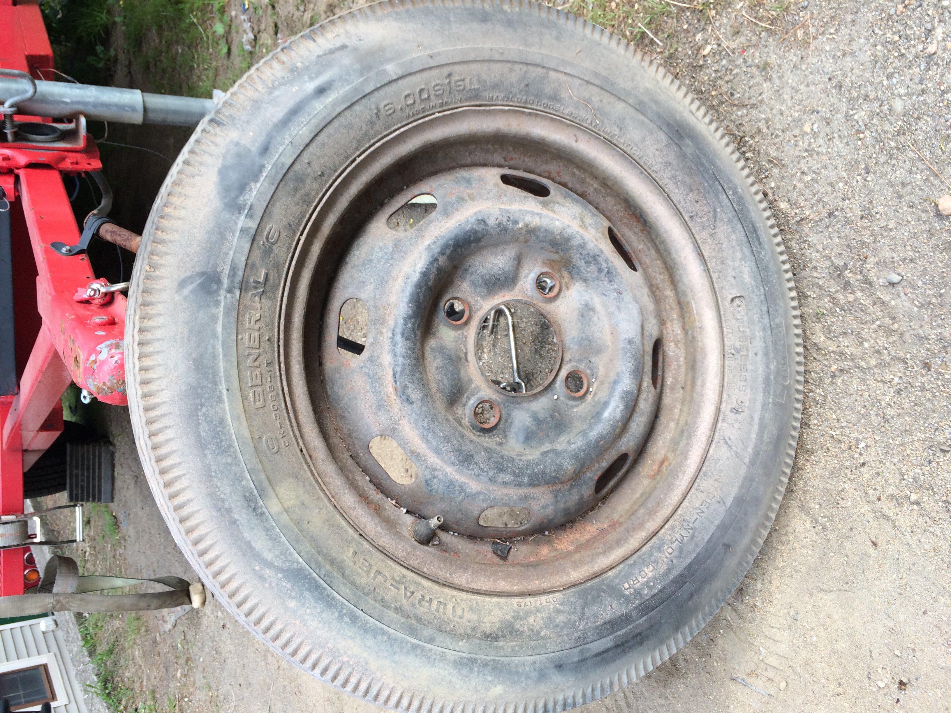

It turns out that the car may have it's original spare tire.
It's a bias-ply Continental in 165R15, and still looks pretty nice on the top side (inside).
It doesn't hold air anymore, so I'm going to replace it with a new tire at some point. However, if some CW would like the tire for a concours display, just pay shipping and I'll send it to you after I get it replaced.

QUOTE(BillC @ Jun 27 2020, 02:27 PM) *
Here is my potential original from a 1972 I just picked up.
