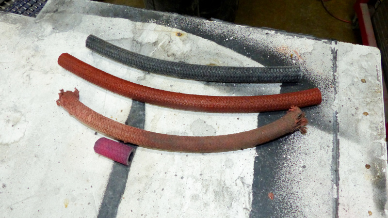

QUOTE(TonyA @ Aug 11 2020, 07:49 AM) *
Maybe i ma crazy but are these available anywhere, or has anyone ever attempted to bleach and dye a hose?

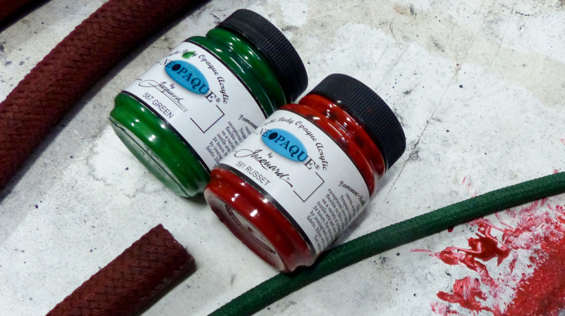

I think I've found an acceptable solution for colored hoses. I posted more details on my build thread here: http://www.914world.com/bbs2/index.php?s=&...t&p=2883669, but thought I'd post a short version here to make it easier to find.
First, I did try bleaching a small scrap of fresh German OEM Continental hose with the idea of re-dying it. Total fail. The bleach dissolved the braiding off the hose so I was left with a bare rubber hose and a bunch of still very black cloth fibers floating around loose.

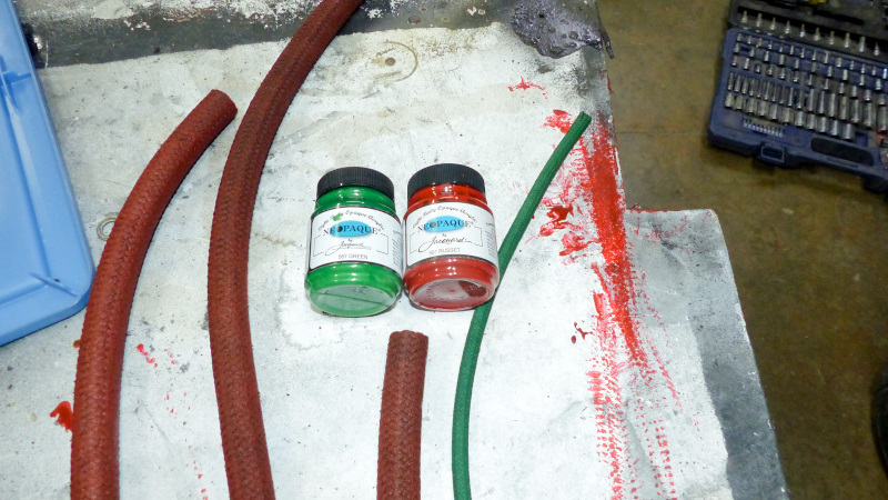

Plan B was this Jaquard Neopaque opaque fabric paint.
(IMG:http://www.914world.com/bbs2/uploads/post-20845-1610913141.jpg)

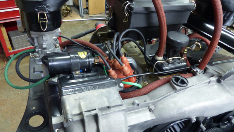

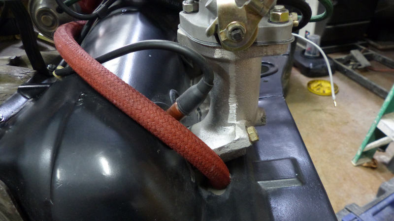

I used Russet and Green. The Russet looks pretty close to what the original red hose might have been. From bottom to top in the below pic is Red (air brushed), original remnant, Russet (sponge brushed), and the unpainted braided hose.
(IMG:http://www.914world.com/bbs2/uploads/post-20845-1610913223.jpg)
I didn't have an original green hose for comparison and suspect this may be a little brighter than original. No doubt the paint could be mixed for a good match if you had a good reference.
(IMG:http://www.914world.com/bbs2/uploads/post-20845-1610913613.jpg)

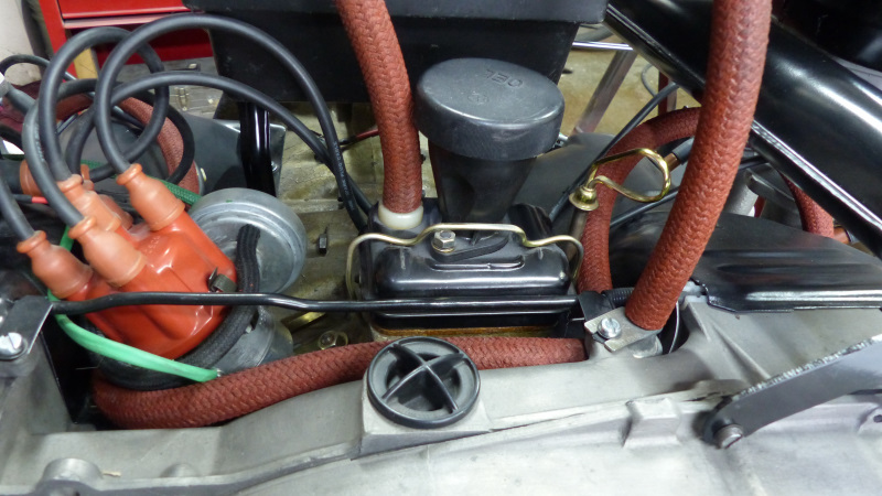

I brushed the hoses with a stiff nylon brush to soften the paint texture a little. It wound up with the feel of hose that has been in the hot engine bay for a couple years on the outside, but still flexible like new hose. A few pics of it installed.
(IMG:http://www.914world.com/bbs2/uploads/post-20845-1610913688.jpg)
(IMG:http://www.914world.com/bbs2/uploads/post-20845-1610913704.jpg)
(IMG:http://www.914world.com/bbs2/uploads/post-20845-1610913728.jpg)

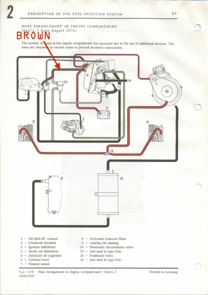

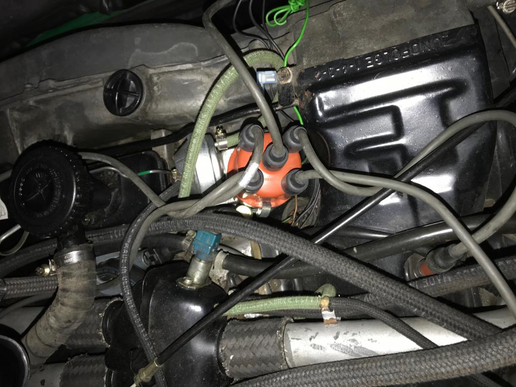

@wonkipop I stand self-corrected; looks like I have two green hoses. The first is off the vacuum cannister (passenger side) going to the throttle body (front side); see photo. The second comes off the T branch into the air plenum; see photo. The first I'm sure of; the second may or may not have been swapped out just because I had that size hose. I've also attached my hose diagram; the first is Line 4, the second is Line 10. This diagram varies slightly from Jeff Bowlsby's and Automobile Atlanta's diagrams; perhaps as Porsche modified things throughout MY 74, probably for emissions, it seems like the hoses and layouts changed.
With this arrangement, "Frogger" has been running flawlessly; if anyone sees obvious error(s), just let me know - always willing to listen to those more expert than me!

wonkipop
post Jan 20 2021, 04:45 PM
Posts: 5,770
Joined: 6-May 20
From: north antarctica
Member No.: 24,231
beaudy starbear.
that info is great.

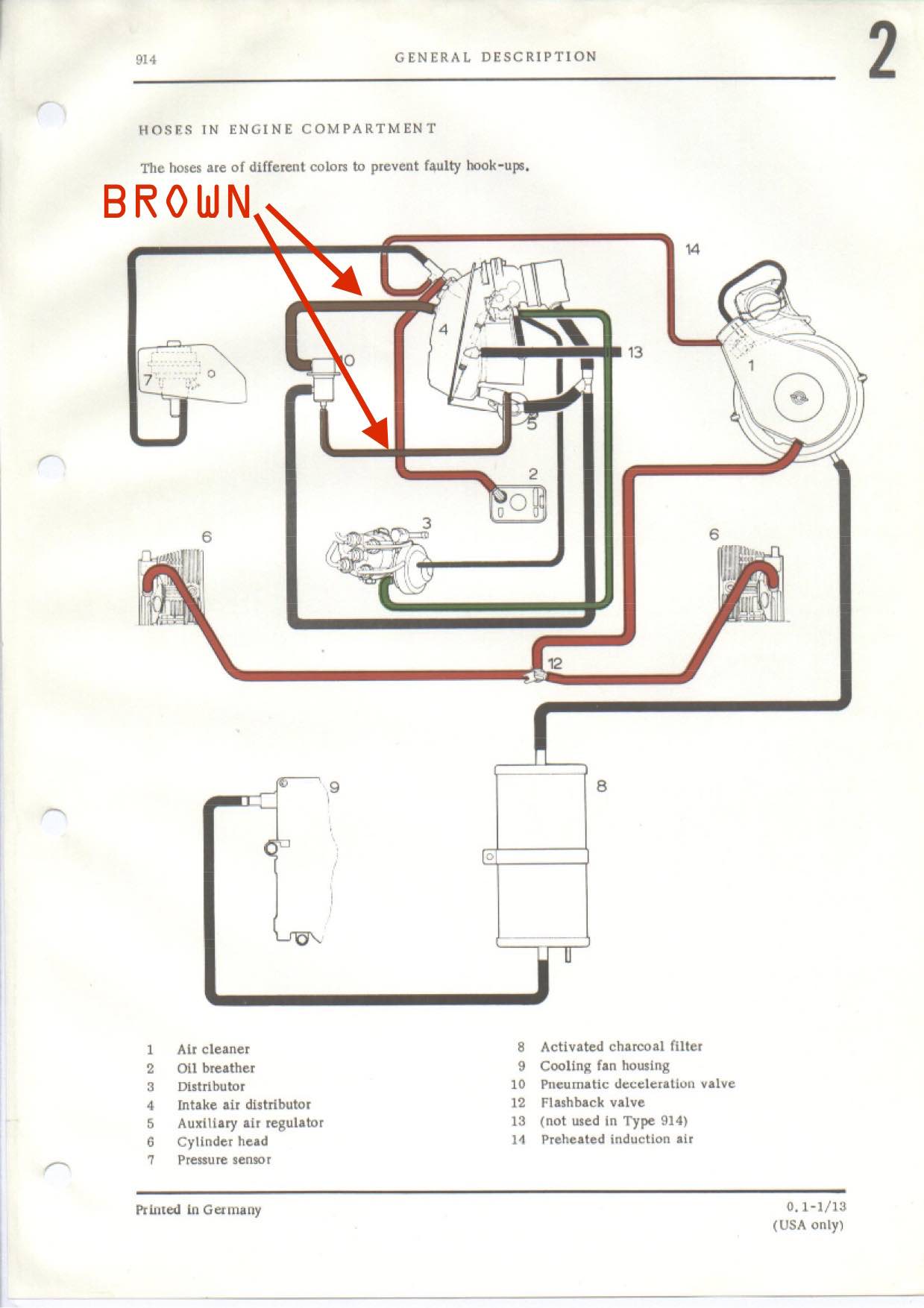

i had an earlier diagram that mr. b made, but it did not match the layout in the car.
even this diagram you have posted shows incorrect (?) layout of hoses to charcoal cannister.
i've never changed the layout on mine and the layout matches the diagram in the emissions warranty that came with the handbook in the car. its about the only place they publish the emissions hose diagrams!?
the fan hose #1 enters the charcoal cannister from the lhs and the air cleaner hose #2 enters the charcoal cannister from the rhs along with the fuel tank vapor line #3.
i believe they changed the design of the charcoal cannister, possibly about the time they moved it into the engine bay on the 1.8. i've studied a lot of images of 1.8 engine bays in various states and those images agree with that layout too. my char. cannister is on the rear wall of the engine bay.
i have the green line out of the distributor on the rhs which then ducks under the intake plenum and heads off to the throttle body. its the only original line left on car now.
the other line was black out of the opposite side of dis. i checked with what came out of car. black too, but of course they could have been changed.
the decel valve lines were black as well, not green like yours. and have been replaced black. but mine could have been replaced at some point too.
i have got an interesting one though and i will post some images up later when i photograph the bits. and it will be around the decel valve. i think i had a red hose there or a brown hose. but its hard to tell. that hose was not like the others.
also the decel valve was floating around and not fixed or clipped. i will put that info up later. all of which point to maybe the decel valve having been replaced and a colored hose put in by a dealer or shop? and they never remounted the decel valve correctly?

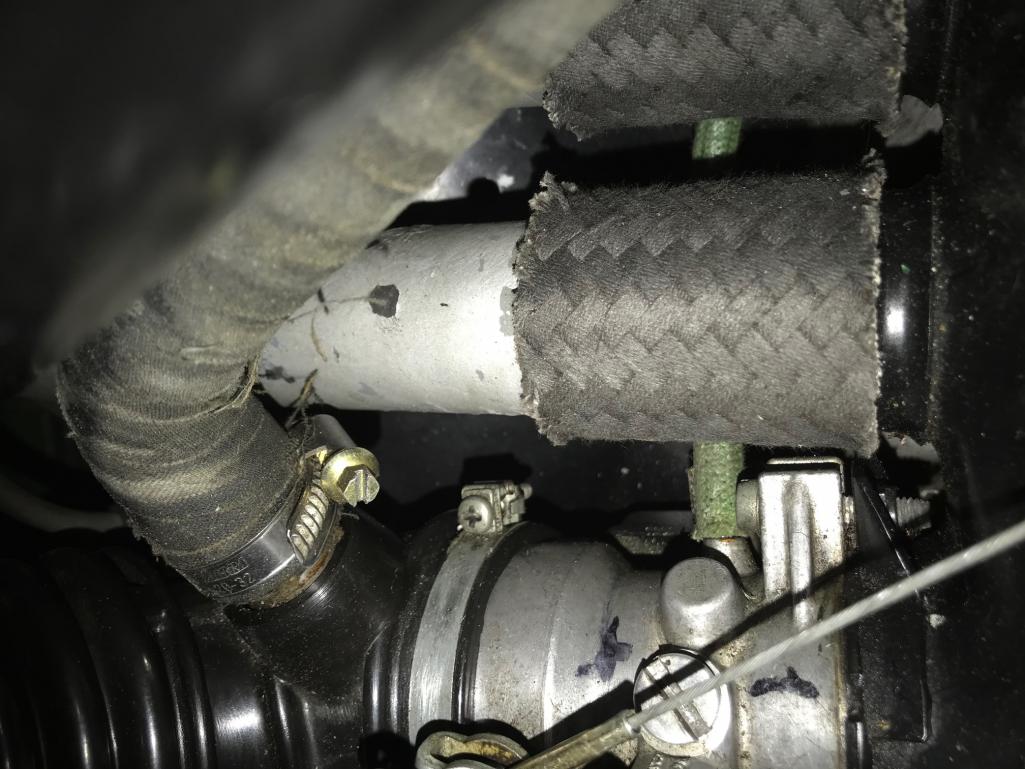

@wonkipop You are so correct! The charcoal cannister lines in my car don't match the diagram; Line 1 goes to the air cleaner and Line 2 goes to the fan shroud. So, the question is, is the diagram wrong or is my setup wrong? Looked in the user manual (original) and didn't see the aforementioned emissions warranty diagram - could you post a pic?
Fortunately, I don't think it makes much difference in operation as the cannister isn't directional (opened and replaced the charcoal a few months ago), but would like to have it physically correct. If it makes a difference, my VIN ends in 9760; body produced Nov 73, car assembled April or May 74.
Thanks! SB

QUOTE(StarBear @ Jan 20 2021, 11:41 AM) *
Hope this helps!
Awe crap! Looks like I painted the wrong vacuum hose green. I colored the advance line rather than the retard. Anyone know which hose was green for 73 2.0L D-Jet? Your pics also confirm that the green paint I used is too bright. I might need to try mixing in some white for a better match.
It would be cool if colored kits were available again but with the method I used, it is just a $10 bottle of paint and a cheap sponge brush. Super easy DIY project.

i'm going to start a new topic on 1.8 hoses starbear as i don't want to hijack this one about how to get those beautiful colors back for all those folks with D Jet.
But as a last note here, for all the guys with D Jet, I think there is one more color besides red green and black if you really want to go after original.
there appears to be a deep brown color shown in the circuit diagrams in the factory manual.
(i've answered your question in the new thread starbear, i believe your car is correct and your emission engineering analysis).
