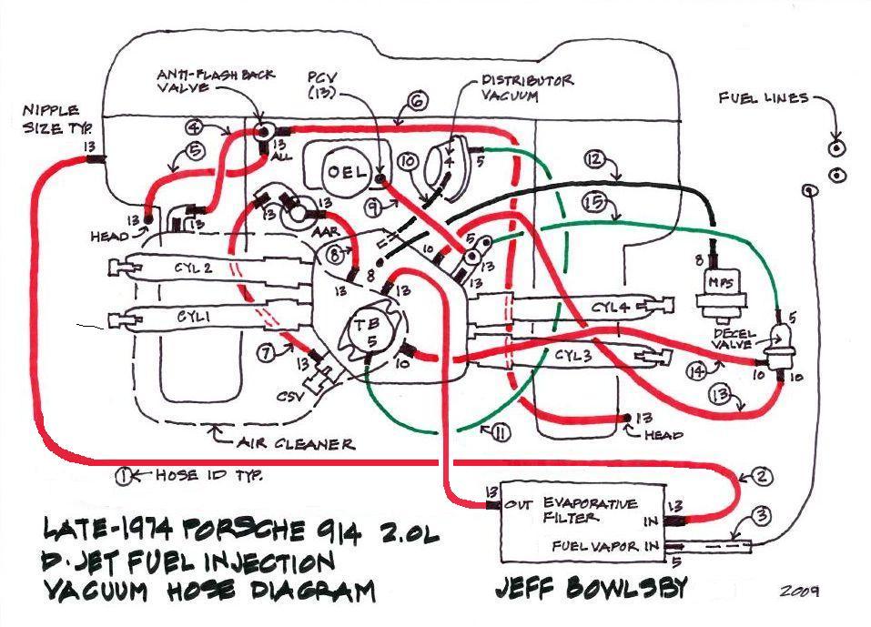

I have a '73 2.0 with stock d-jet, and have struggled for years with idle issues that I suspected were related to the NLA OEM PCV valve. I've finally come up with a solution that fixed the various problems and wanted to share here in the hopes that it may help somebody else down the line.
My engine is now 2056cc with a Webcam 73 cam. But, my idle problems plagued me even when the engine was previously stock. The original PCV had worn so that it flowed more air than it should when "open", and was sticky as well, causing inconsistent airflow. I tried to purchase a replacement, but had no luck both here and via the usual online vendors. I also tried cleaning the one I had several times, but to no avail.
Before anybody shouts "vacuum leaks", I thought the same for a long time. But, I've now completely rebuilt the engine and have replaced every hose, tested every component by pulling vacuums, and finally did a smoke test to confirm that there are no vac leaks. It was the old PCV valve along.
The problems that the old valve caused were:
1) It flowed too much air to get the idle speed below about 1500 rpm without very retarded idle timing helped by vacuum retard from the distributor. (I have a 123Ignition distributor, and one must choose between vacuum retard at idle (e.g. with profile "A"), or vacuum advance at light load (e.g. with profile "1")). For anyone interested, details on the 123 issues can be found here:
http://www.914world.com/bbs2/index.php?act...=2&t=347291
2) The inconsistent flow thru the PCV caused the idle to be correspondingly inconsistent regardless of what other adjustments were made to timing, idle screw, air-fuel mix, etc. Sometimes it would idle high, sometimes it would idle low.
From @pbanders excellent resource:
https://members.rennlist.com/pbanders/PCV.htm
"Porsche used a PCV valve on some 1.7L and 2.0L D-Jetronic engines, mostly in the 1973 and 1974 models. Early 1.7L and late (1975 and 1976) 2.0L engines did not have a PCV valve, and the crankcase breather on the oil filler was connected to the air box."
Indeed, I experimented with connecting the PCV valve to the airbox as above, and it did "fix" my idle problems. But, I didn't want to sacrifice the crankcase scavenging that a properly operating and plumbed PCV would provide.
The solution I finally came up with (again taking a cue from pbanders), was to adapt a modern, readily available PCV valve to the car. This provides apparently similar airflow as stock at high engine loads (low vacuum), and lower airflow than stock at idle (high vacuum). If you try this, you'll likely need to adjust the idle screw on the throttle body to compensate for the reduced flow.
The components I used are as follows:
PCV Valve: Microgard PCV 279 (cross for FRAM FV279) which is a generic valve for a 1990 Toyota Corolla
Grommet: dormanproducts.com p/n 42057 PCV Grommet (cross for Toyota 90480-18180)
The grommet fits the hole perfectly in the 914 breather box. The nipple on the valve is around 11mm diameter, which is a bit too small for the 13mm PCV hose (or elbow) on the 914. I currently just have the nipple on the valve wrapped with electrical tape to size it up to 13mm, but I plan to fit a proper adapter to size down the 13mm hose and connect directly to the valve. I suppose I could also fit the original elbow, but plan to just leave the hose exiting the valve vertically.
Here are the relevant pics:
I hope that somebody may find this useful. Comments are welcome and appreciated.

do you still have the hose on the pvc going to air box?
btw i have a 75 2.0 and have never had the pvc per stock, but would like to put this in place, just making sure hose is hooked up correctly for correct result
Not_A_Six
post Aug 12 2020, 07:33 PM
Posts: 110
Joined: 28-November 18
From: North Idaho
Member No.: 22,682
QUOTE(DRPHIL914 @ Aug 12 2020, 05:57 PM) *
No, I just had it connected to the airbox temporarily as an experiment. It's correctly (for '73) plumbed to the plenum per Jeff Bowlsby's diagram ( @JeffBowlsby ). That was sort of the whole point of this exercise. Plumbing the PCV valve to the airbox along with the hoses from the heads via the anti-flashback valve sort of defeats the whole operation of the PCV system. Though, I think that may be what Porsche did on later model years (maybe your '75...), likely due to limitations of the primitive PCV valves of the day (I.e., too much flow at idle to get reasonable flow at higher load.) The link to pbanders' page in the OP describes the details.
If you try this, please post back and let us know how it worked for you.

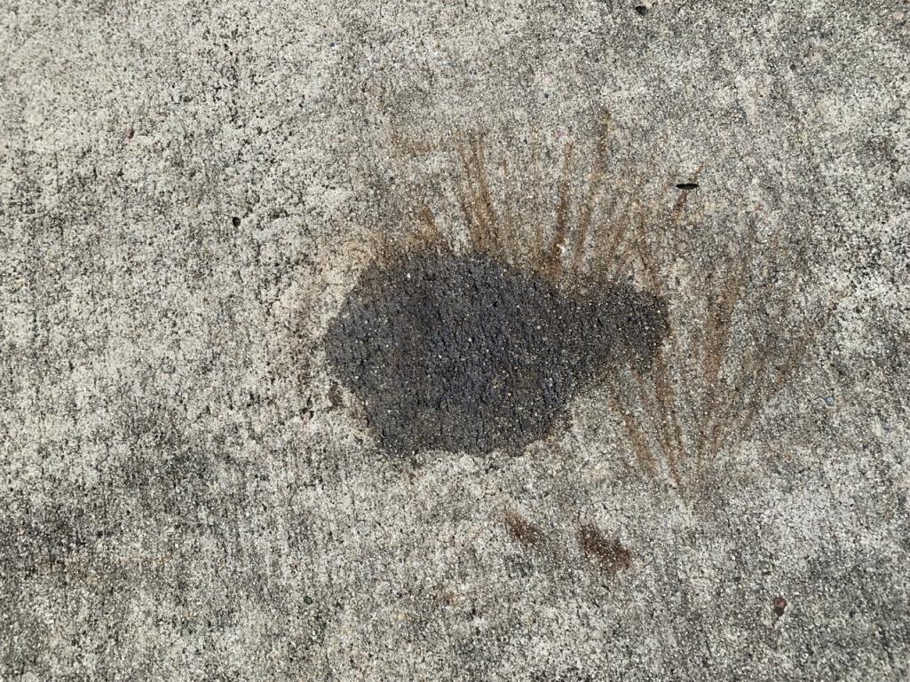

first test result: option#4- immediate pressure issue, idle and big oil leak. removed pvc and put it back to no pvc all other things same, normal perfect idle, have to burn off some oil now.
Phil

BTW that was a big puddle before i soaked it up, and FAST! way too much positive crank case pressure! so i geuss thats a big no for me- back to stock '75 set up.

QUOTE(DRPHIL914 @ Aug 18 2020, 05:53 AM) *
Hmmm...
Sorry it didn't work for you.
Like I said earlier, I'm not sure what the plumbing on a '75 is supposed to be like. And, I don't know how your particular car was plumbed, or what you've changed to add the PCV. (IMG:style_emoticons/default/confused24.gif)
Out of curiosity, where was it leaking? Valve covers? Under what conditions? (I'm guessing WOT if it was an excess pressure problem...) Can you post a pic of the plumbing?
If the anti-flashback valve is plumbed right (to both heads and the airbox), crankcase pressure shouldn't exceed atmospheric pressure. That's the first placed that I'd look if you still want to experiment.
EDIT: If it was leaking at idle, there might be another possibility: The PCV valve should slightly *reduce* idle crankcase pressure over your prior setup. So, under normal operation, it may slightly change the way that the valve covers mate with the heads. If your leak was at the valve covers, it might just be a gasket problem that was masked before. Or, your heads or valve covers might be warped a little. (IMG:style_emoticons/default/idea.gif)
Usual disclaimers apply: YMMV. Enter At Your Own Risk. Good luck.

of course all disclaimers understood,
2 things, but the biggest issue is i had not put the anti flashback valve in like the 73-74 have it shown, the 75’s just put the hose to the air box, - so i might try again but putting all hoses and flash back valve in place exactly as your diagram. leaks were not from the valve covers those are tight , so i have to look closer , might be push rod tube seal but i can tell you that before this try my motor was leak free, no leaks - i re torques the heads etc and put all new seals in 2 years ago and had been zero leaks . so i am also i tersted to see where the leak was. but after putting back to stock, no leak again.

Was it leaking at idle, wide-open-throttle, or something else?
Pushrod tubes is interesting. I imagine that it might leak there under both over- and under-pressure scenarios... (IMG:style_emoticons/default/idea.gif)

Sorry to hear that this caused a leak. It's always at the weakest sealing point. Hopefully, it's not a difficult fix.
There must be a reason that the manufacturer didn't engineer an pcv valve into this system. May be better left alone.
porschetub
post Aug 18 2020, 03:42 PM
Posts: 5,205
Joined: 25-July 15
From: New Zealand
Member No.: 18,995
Interesting (IMG:style_emoticons/default/idea.gif) ,maybe that valve is designed to operate @ a different pressure and not matched the engine perhaps (IMG:style_emoticons/default/confused24.gif) would be hard to know unless you had a stock one to test against,IMO they need to be working @ the same range.
Maybe further experimentation would yield a good result ?
