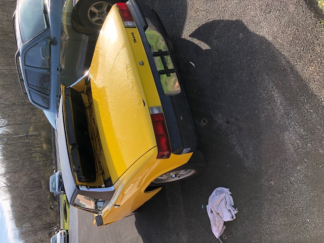

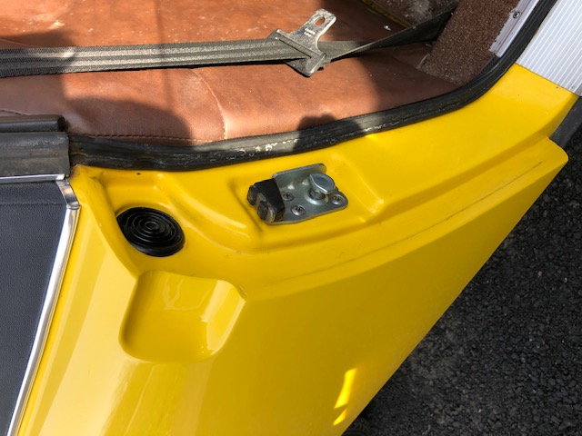

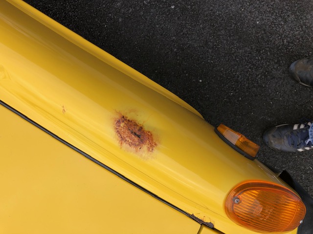

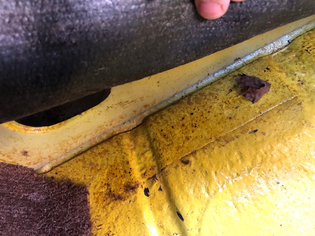

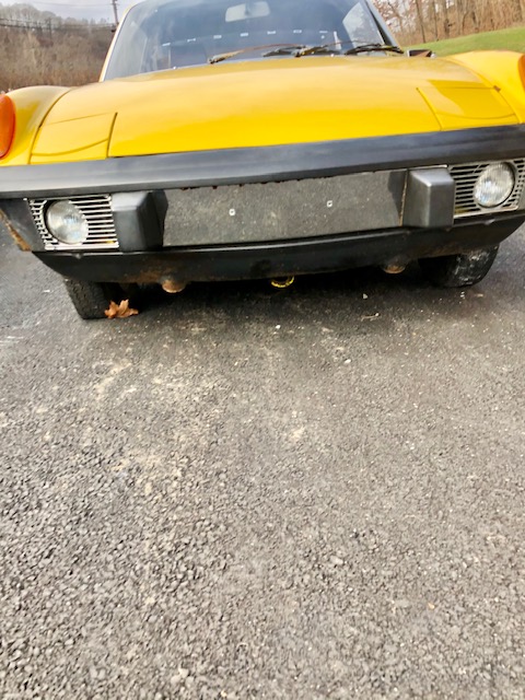

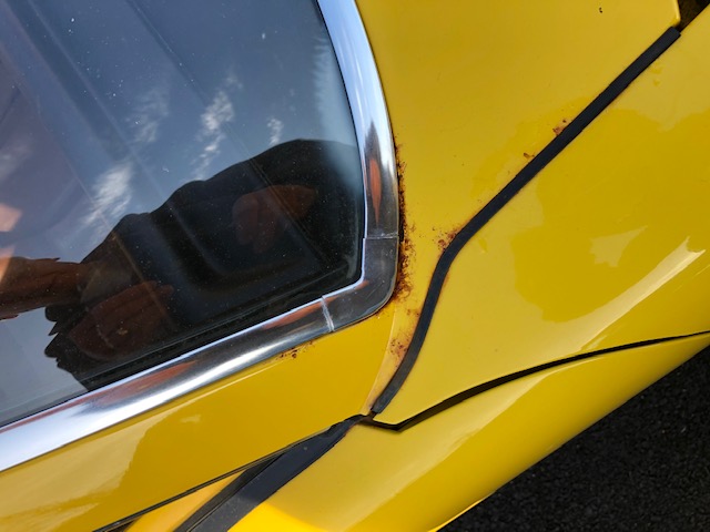

Attached some pix. There's some good and some bad. All of the wheel wells are uniform black and well covered with rust proofing. Was this done by PO as preventive measure or hiding something???
There are places where it is near perfect and other spots you have to ask how does that happen??? Could be someone started to clean it up, got part way and gave up.
Tried to roll the car in gear with plugs out. Someone put on the E brake recently. Rear brakes are locked up. No surprise. Its been rainy and cool here for weeks and the car is outside.
Engine is still unknown but I have made some contacts that will sell a rebuilt 1.7 for about a $1000.
Offered the guy $4k. He is considering. Thanks for all of the input from everyone.
