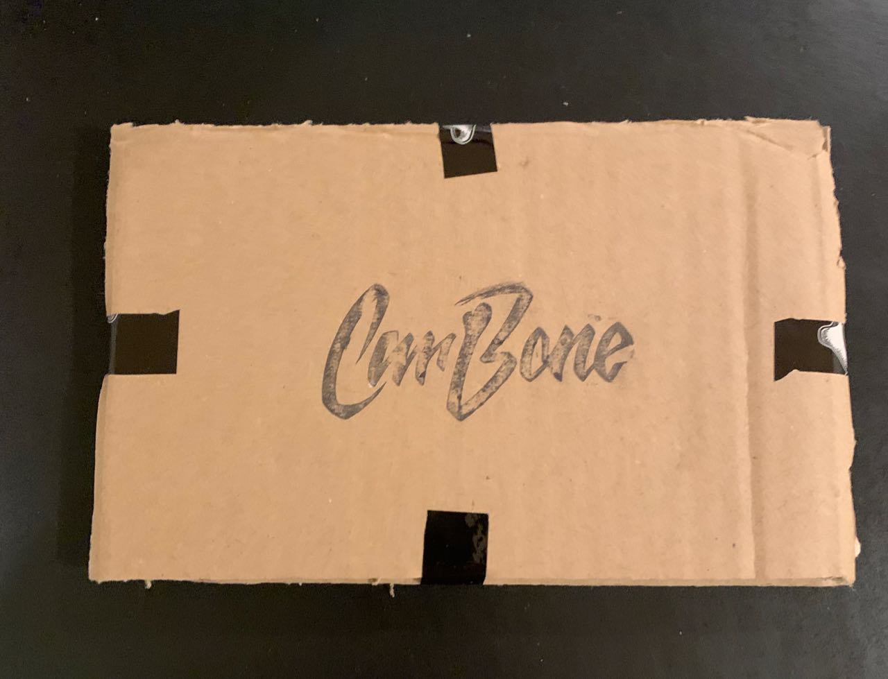

OK, Very satisfied with Car-Bone all the way around. I ordered it on November 25th and received it on December 1st. That's crazy, right?
My question, to anyone who has actually installed one of these Compliance stickers, is how do I do this? Can I use the soapy water and squeegee method? Or is it a remove the backing and stick it in place and pray you get it straight method?
Look how well it came packaged too:
plutothepointer

QUOTE(Cairo94507 @ Dec 2 2020, 04:24 PM) *
looks perfectly original
