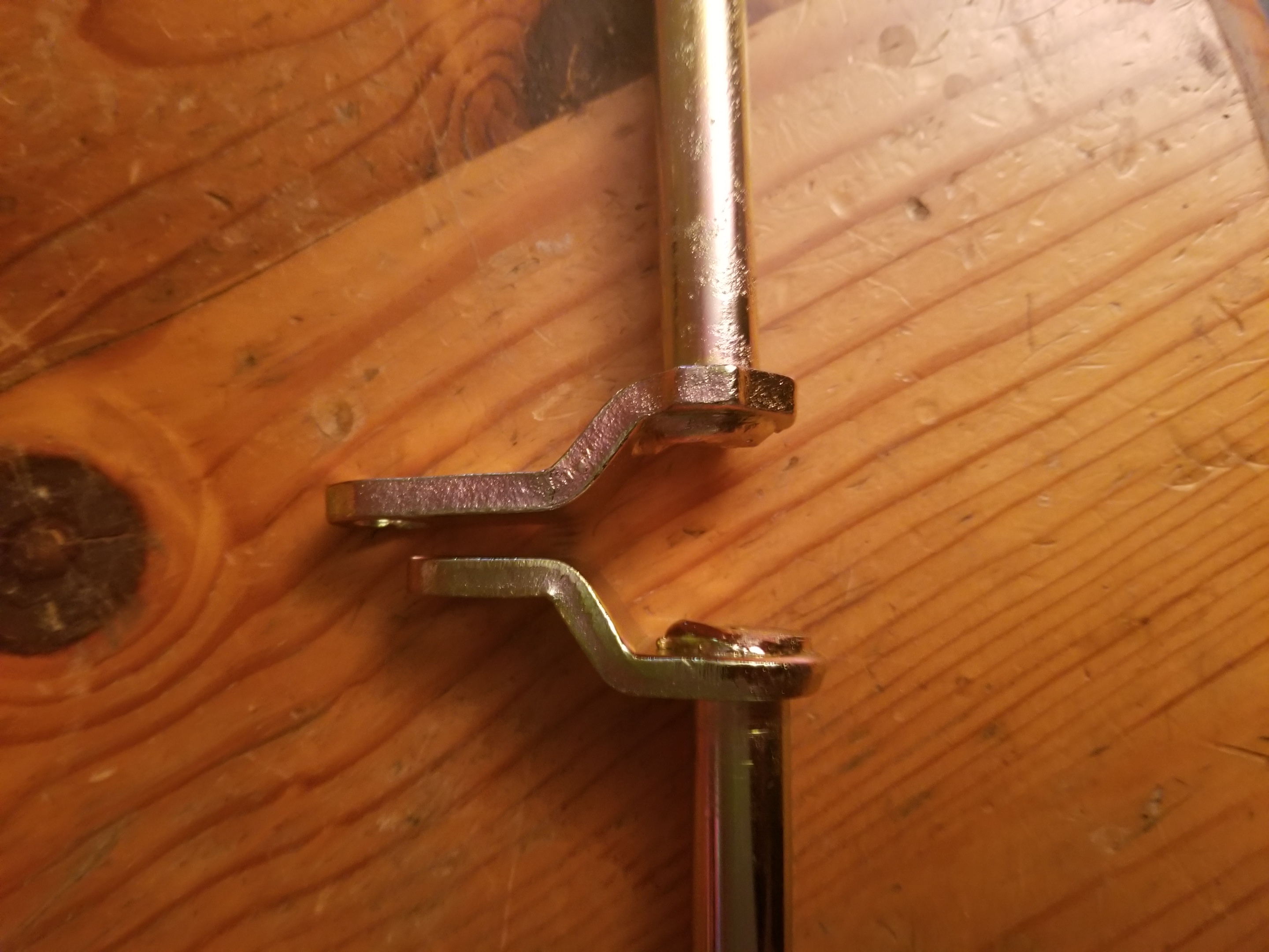

@HalfMoon
A later 911 clutch arm in the pedal may be adaptable to accomplish that. It has a taller arm but requires more offset to not interfere with the accelerator cable.

@HalfMoon
This . Shorten one of the other levers. Much simpler. Plus, why? Are you bang shifting your 914?

@HalfMoon
Interesting idea!
Thanks for that.
