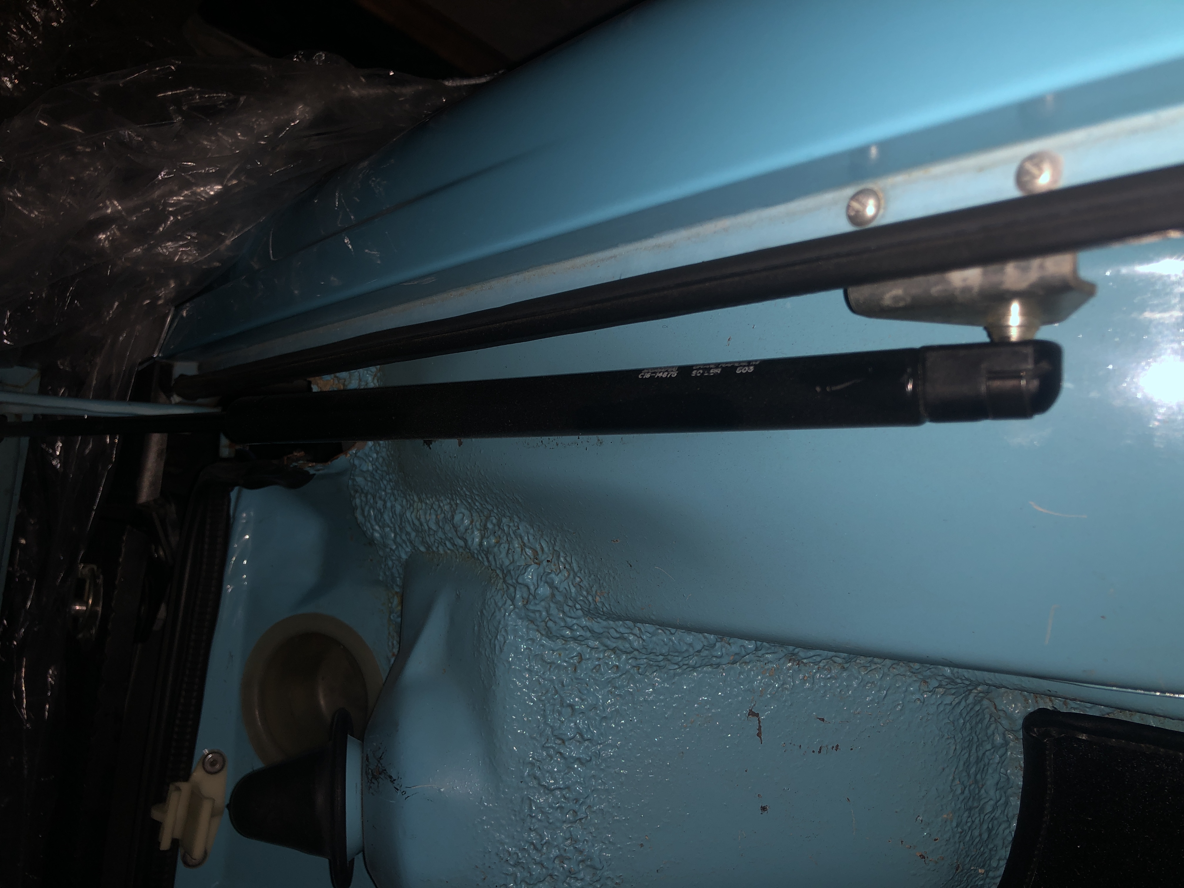

Robarabian
post Dec 29 2020, 09:48 PM
914 A Roo
Posts: 745
Joined: 11-February 19
From: Simi Valley, Kalifornia
Member No.: 22,865
@ri914 see photos. They allow for top storage. Attached Image

QUOTE(Robarabian @ Dec 29 2020, 10:48 PM) *
Thank you to everyone on the suggestions. Having cut through the trunk rods with a grinder wheel I can agree they can be dangerous.
I order a set from Camp. looking forward to the install.
