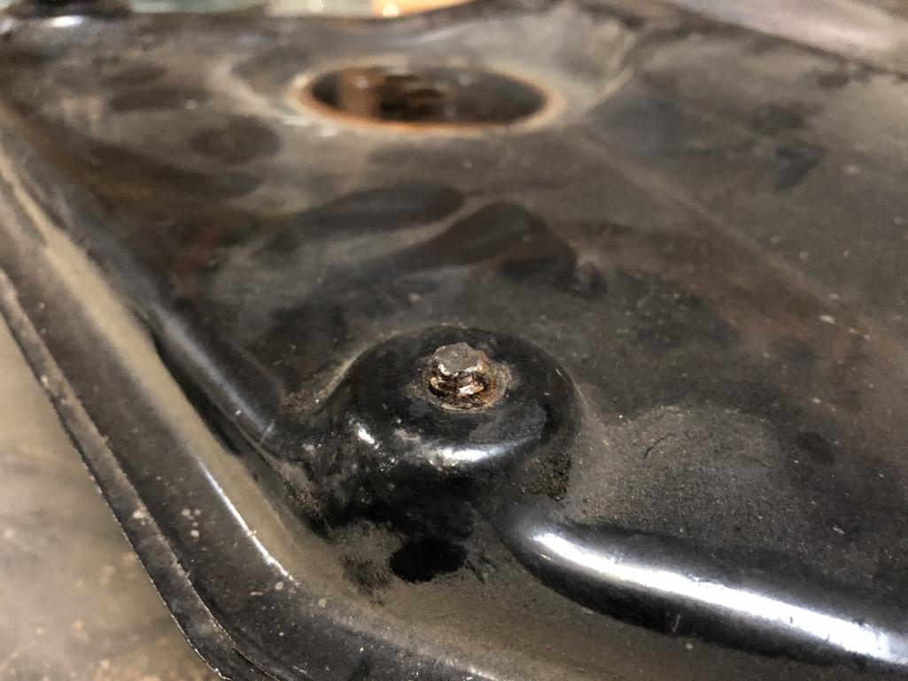

i had to pull the oil tank out of my 914 to address a leak, and one of the mounting studs on the tank broke when i went to remove the nut. it broke about a 1/4" off of the tank.
quick google search last night didn't yield any good intel, what am i looking at to replace that stud?...

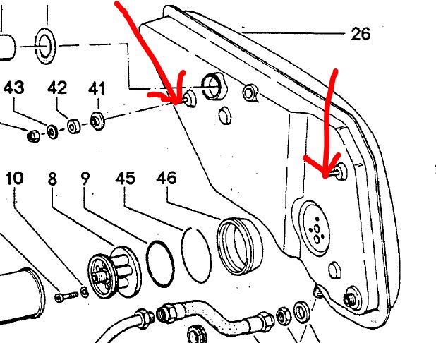

you're talking about this in the drawing below...correct?
if so may need to weld another one on....
how much is left on the tank
take a picture and we can see what to address

yes, the stud on the right hand side of that diagram is the one that broke. there is only 1/4" or so left on the tank.
i can feel the back of the other stud and it feels almost like it's pressed in from the back side...

If there's enough thread, you might be able to use a stud extender. Might have to put an extra washer or two on the engine bay side. But it would be an easy fix if it's possible.

yeah, there isn't enough of the stud left, and the threads are jacked anyhow.
i'll likely have another welded on?...

You could try to cut the old one flush at the base and then drill and tap the hole for a new stud. Being carful not to drill thru into the tank.

I've fixed this problem before on 911 tanks. You'll need to carefully grind the broken stud flush to the the tank and clean the area to bare metal.
The only proper way to re-attached a stud to metal this thin is to carefully braze a new stud on and it will be as strong as the original
The tank is too thin for electric welding in my opinion even TIG is a challenge due to the vast differences in material thickness.
Also getting rid of all the oil or rust contamination for a proper electric weld is near impossible, brazing is much more tolerant in that regard.

Thats a tricky spot for sure.. that stud is brazed with a flange from the inside..That will be a tricky repair. A couple ways to go about it.. I think the best way would be to drill and tap then insert a stud and weld or brake in place. That will ensure proper centering.
