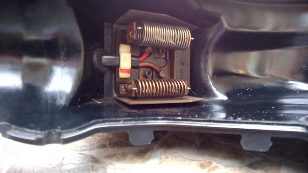

@bbrock recently tore into his resistor pack. I can't seem to find the thread at the moment.
There are two wire coil resistors. They control Low and medium. High is wired w/o a resistor to motor per Haynes (white wire) . There is also a bi-metallic thermal cut out switch per the Haynes schematic. The resistors and thermal cutout switches can be verified with DMM.

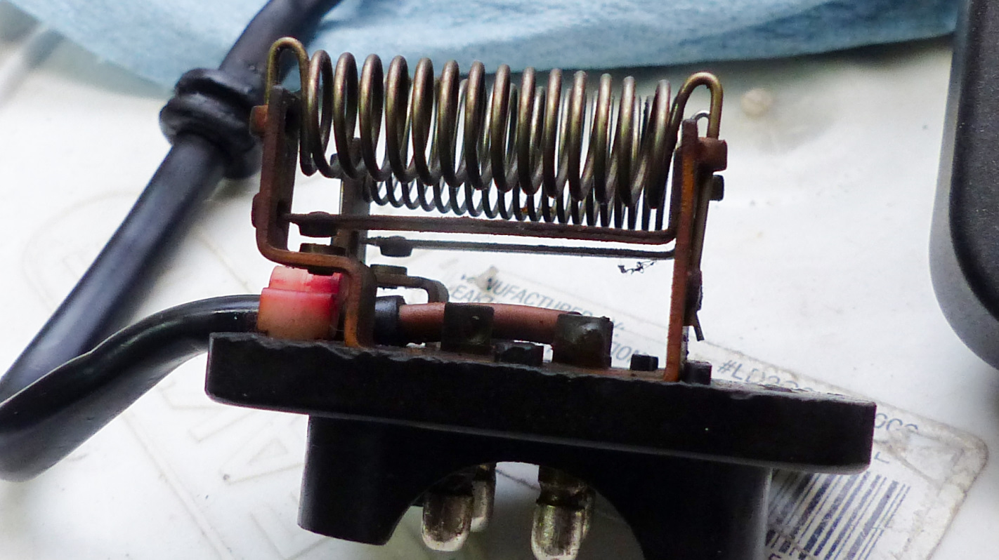

So I found the resistor pack. And I found my old photos. Looking at the resistor pack I acquired I can now see values on there that I never noticed before. There are two resistors. The one on top is 2.5 ohms and the one in bottom is .75 ohms. So there are three settings. I'm assuming high speed runs through neither resistor, medium through one (maybe the .75 ohm resistor), and low through both for 3.25 ohms of resistance. Probably 50 watt at least.
Edit: And to Superhawk's point, when I managed to get my motor spinning, I never really fully rebuilt it, so it probably wasn't spinning as freely as is should. That means more power draw through that resistor at low speed than it was designed for, and (IMG:style_emoticons/default/blowup.gif)

Here is the detail on the bi-metallic switch BELOW the resistor.
@bbrock problem was only two speeds. Fully acknowlege this is different than your problem but it does detail how the switches are physcially built if you wish to document this thoroughly.

Ahhh...ok, that filled in at least some of the missing pieces for me. I think I have a better idea how this thing works.
Amazing how complicated it is and how much engineering went in to this little bugger.

@DRPHIL914 Thank you for the kind words regarding the rebuild of my (IMG:style_emoticons/default/stromberg.gif)!
Just for clarity, it isn't a spring per se. It is basically a wire wound resistor without a housing just suspended in air. The resistive coil is exposed to air flow and is air cooled (like the engine). Pretty neat huh?
If the coils were touching one another, resistance would decrease. If it breaks or goes Poof and opens up, now you have infinite resistance. Either of these scenarios can be checked with a DMM.
In @BeatNavy 's case, if he had a stalled motor (or very slow spinning motor), the low speed resistive element probably got too hot both from too much current draw (from the stalled motor) and lack of cooling from no airflow and then the smoke got out. (IMG:style_emoticons/default/hissyfit.gif)
Not so simple to repair but not impossible in concept.
The resistive wire is a special alloy designed both for stable resistance per unit of length as well as good thermal properties (doesn't melt easily, stable resistance at various temperatures, etc.).
Here is the Wiki on what it could be.
https://en.wikipedia.org/wiki/Resistance_wire
Nichrome and Magnanin are the most common.
Much easier to find a donor and replace if it turns out to be a resistor.
If I had to McGyver something, I'd start looking at toasters for their resistive elements but that would take some real trial and error to understand if it could even be done. (IMG:style_emoticons/default/huh.gif) (IMG:style_emoticons/default/sheeplove.gif) More seriously speaking, I'd start looking to other more readily avilable domestic blower motors to see if I could find a similar wire resistive element and would cobble that. Alternatively, you could replace the resistor with say 12 gauge copper wire (zero ohms resistance) and you would esentially have two HIGH speeds. Or I guess, you could just bend the bi-metallic switch contact to be closed all the time. Same result - bypasses the resistor. That was what caused @bbrock 's problem.
With a little math we could roll (i.e. wind) our own. (IMG:style_emoticons/default/smoke.gif)
https://www.amazon.com/Nichrome-80-Gauge-Re...F9N7AHK43ZF4CP8
Many thanks to Brent for photographing and documenting that bugger!

QUOTE(Superhawk996 @ Jan 21 2021, 06:01 PM) *
QUOTE(DRPHIL914 @ Jan 21 2021, 05:34 PM) *
I wonder if the spring in essence is your resistor but is broken and we know the needed value, should be able to rebuild that i would think right?
thanks for explanation, it’s fascinating, it is “cool” , and actually amazing how they worked all that out.
all fast would be better than none at all , i need to test mine this weekend so i know what i am looking at.
