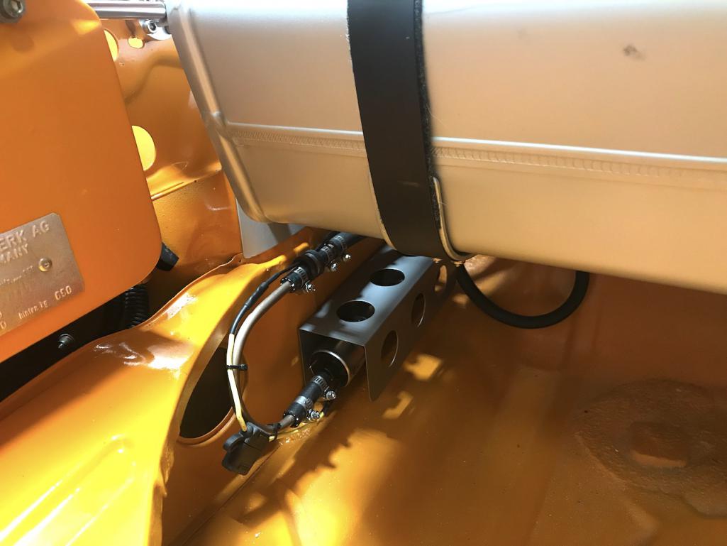

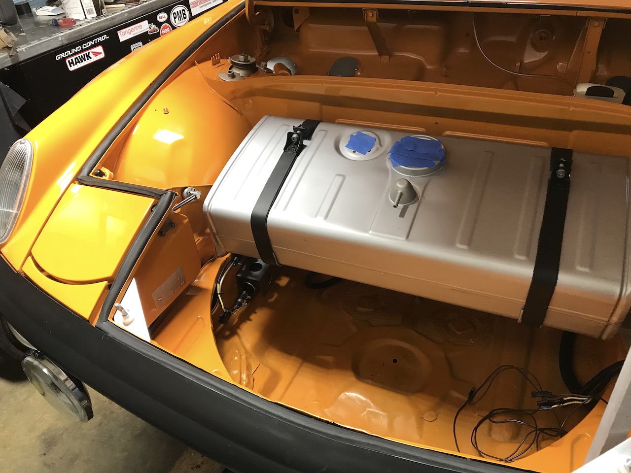

What do you all think of this location for mounting my new pump in the front?
Besides space, I have some other goals:
1. Avoiding mounting on any sheet metal shared with the passenger compartment.
2. As much protection as possible.
3. Short fuel line runs between the tank, filter, pump, and hard lines.
4. Access to the lines without pulling the tank.
5. Access to the pump without pulling the tank.
My proposed location probably does not satisfy goal 5 (maybe), but otherwise I like it.

I think if you take a look at the later model cars, there is a cut out of the front wall at the tank, with a stock cover that may suit your needs better.
I mounted mine in the front trunk on the passenger side to provide simple access to change filter elements.

I do know about the stock 75-76 location on the left side, but I prefer not to cut an access hole in the bulkhead. With my proposed location, I might be able to remove the pump through the existing big round hole.

Based upon my multiple locations, and my big hands, I could not get the pump out of that hole.
I would agree that under the car near the rack is a better choice.
Volvo had a similar pump under the p1800 and it lasts about 30 years...
I believe there is plenty of room near the rack for both the pump and a smaller inlet filter.
Put the other filter in the engine bay.

I always move them to either one of the 2 locations that the factory/dealer moved them to. Either the stock 75+ location by cutting the front bulk head on the driver side and using the factory blister/cover, or behind the steering rack cover under the car on the passenger side. The location you have it in the picture looks like it would be extremely difficult or impossible to fully access once the tank is in.

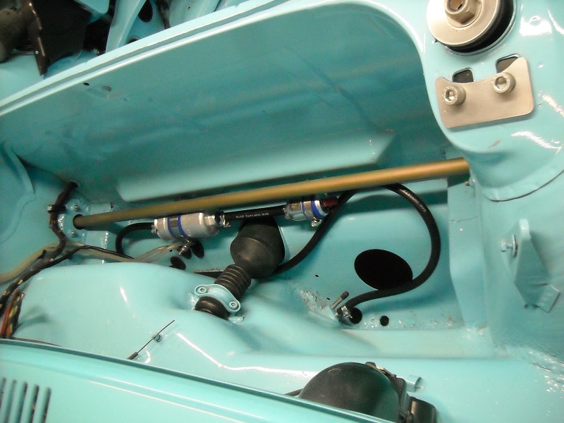

Same goals, up front, good access to pump and filter. Best, MarkAttached Image Attached Image

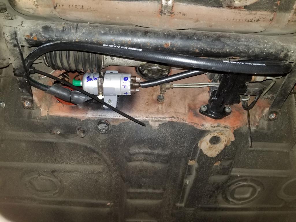

I found there was plenty enough room to mount pump under steering rack cover in my 73, plus 2 filters. I damaged 2 filter socks trying to install in tank, so a filter before and after the pump makes more sense to me. Also placed a filter in engine compartment before injector rail, easy access to cheap filters is better than a plugged injector. (IMG:style_emoticons/default/aktion035.gif)

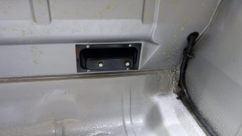

bbrock
post Jan 25 2021, 02:10 PM
Posts: 5,269
Joined: 17-February 17
From: Montana
Member No.: 20,845
QUOTE(Shivers @ Jan 25 2021, 08:58 AM) *
Could one of you guy's post a few pics for us interested in reproducing the 75-76 fuel pump access opening and plate. A measurement of the opening would be awesome. Thank you.

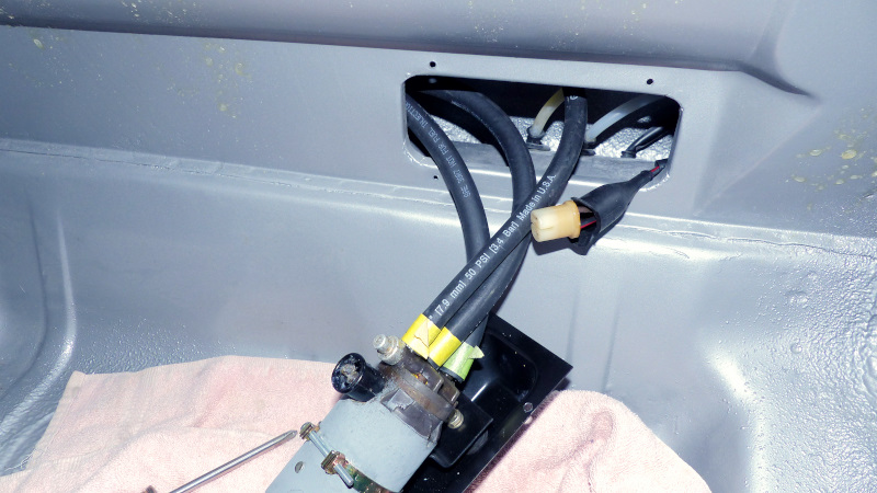

The opening is approximately 6.5" x 2.5" but it is best to have a 75-76 blister cover in hand to make a template. I just test mounted my pump in my retrofit opening yesterday. Pics below and here's a link to my process for cutting the opening. http://www.914world.com/bbs2/index.php?s=&...t&p=2652159
And if I were the OP, I'd do as others have suggested and put it in the steering rack area the same as the factory specified for pump relocation per recall. That's where mine was when I bought my car and it worked find in that location.
