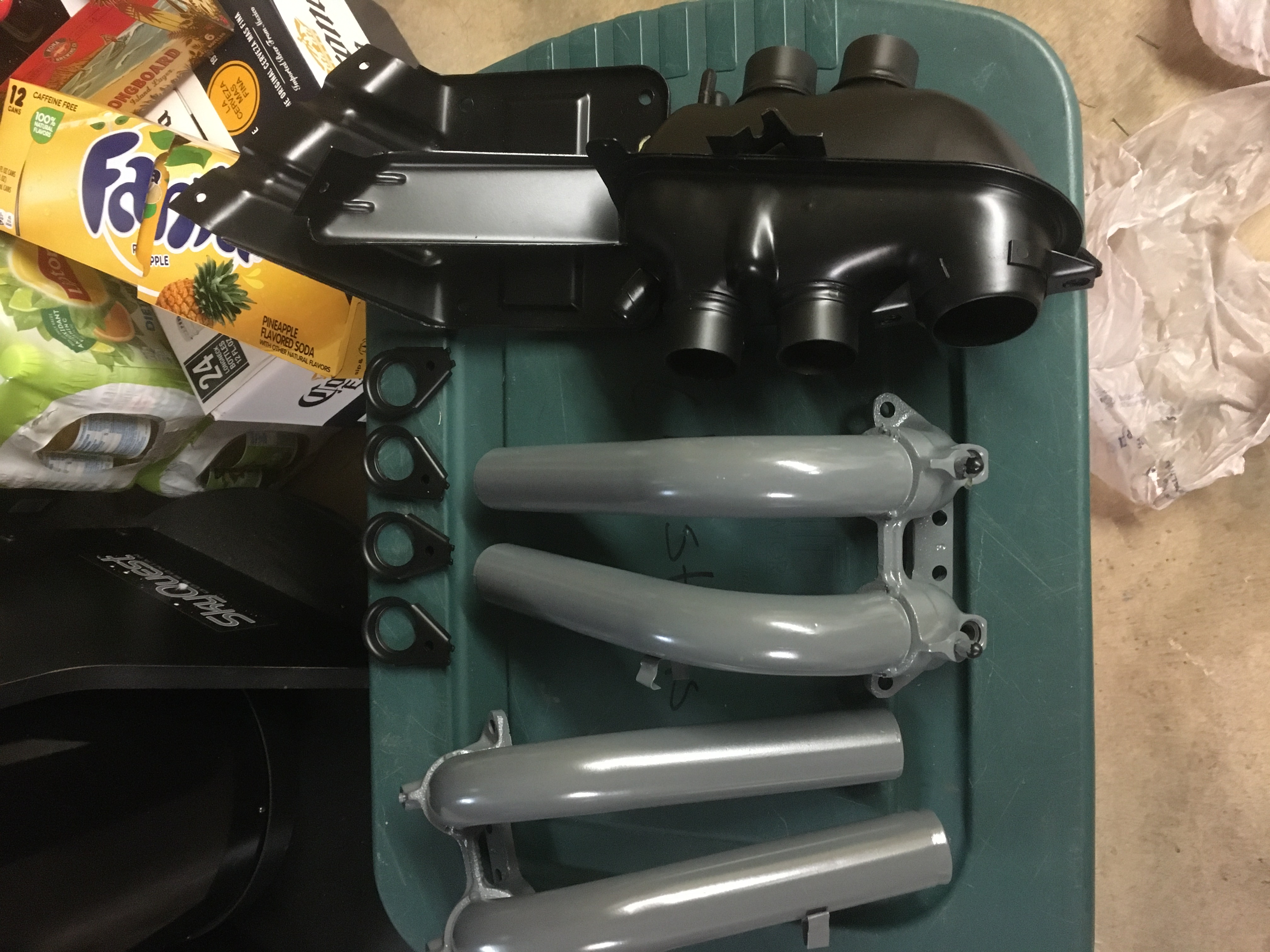

shane
post Jan 25 2021, 04:42 PM
Posts: 355
Joined: 12-February 13
Member No.: 15,518
QUOTE(914werke @ Jan 25 2021, 09:17 AM) *
Thanks
shane
post Jan 25 2021, 04:45 PM
Posts: 355
Member No.: 15,518

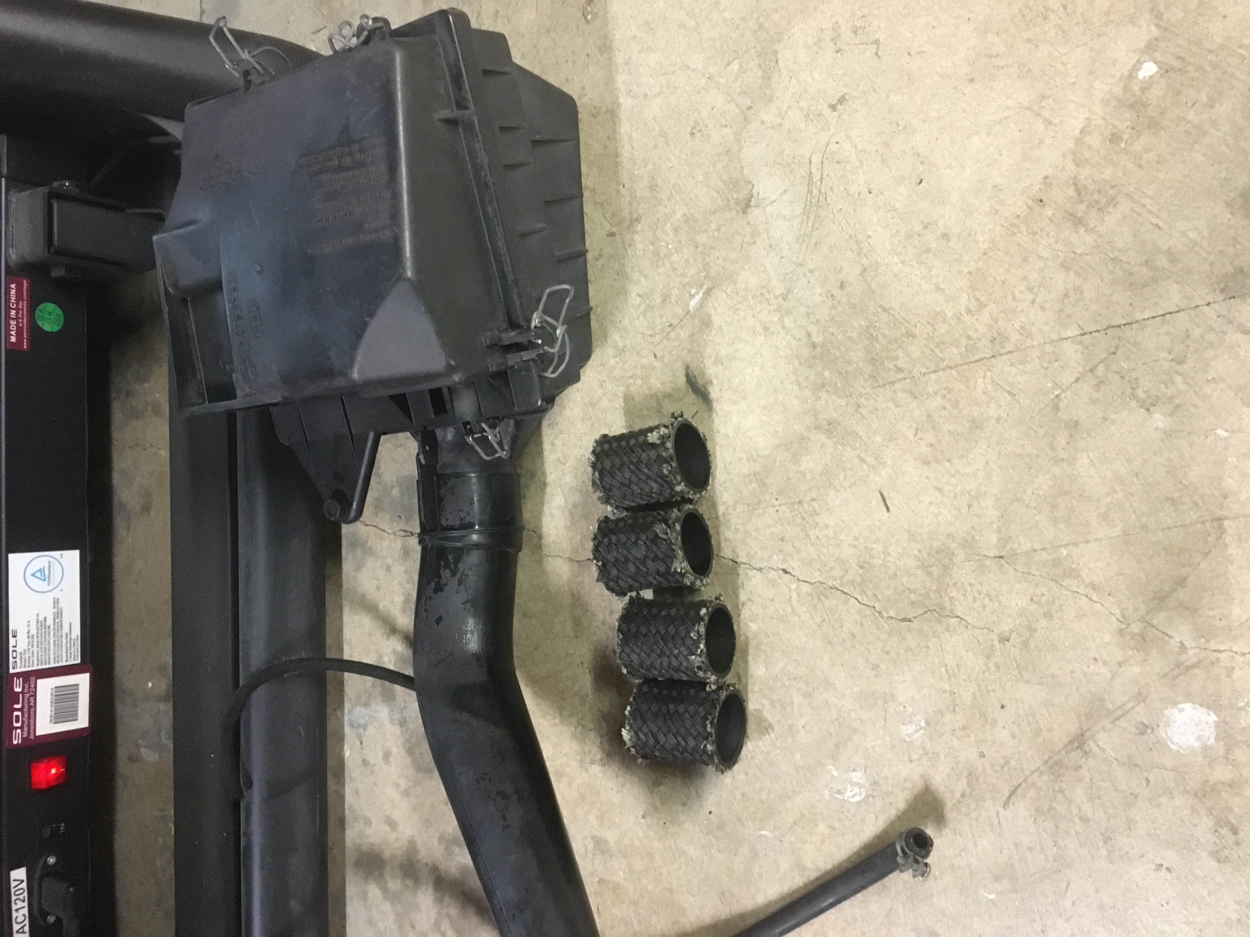

QUOTE(ClayPerrine @ Jan 25 2021, 09:15 AM) *
QUOTE(shane @ Jan 25 2021, 07:54 AM) *
The PO had a single carb on when I bought my 74’ 1.8 914 and said he had uneven idle problems with the L-jet injection so he preceded to remove all components and box everything up. So now I’m feeling I want to reinstall the injection and put it back to stock. I have some mechanical ability and patience, though I was never able to get that gas smelling carb to run right. Was looking for someone I could pay for a few hours to kinda orientate me on the location of the box of injection parts I have and give me thoughts on what parts I might be missing and how difficult and expensive it will be to put everything back. I’m in Puyallup WA south hill area, Thanks In advance
I can help. If you post pictures of what you have, I can help you figure out what you are missing.
Clay
Attached ImageAttached Image
shane
post Jan 25 2021, 04:47 PM
Posts: 355
Member No.: 15,518
Attached Image and a decent fuel injection harness

Might be something as simple as cracks in the back of the snorkel. L-jet can barely tolerate any vacuum leaks so that’s likely a big part of it. Have the injectors checked out and rebuilt if necessary (probably, because they’ve been dry for so long) then go through all the seals and replace them. Make sure the vane operates freely in the AFM.
It’s not a complicated system, and this site is a great resource.
Good luck (IMG:style_emoticons/default/beerchug.gif)

Thanks, how complete is my collection at first glance? Trying to figure out what I might be starting and will need right from the beginning. Thanks

Looks like you have all the major parts of Ljet.

At first glance looks to be pretty complete. I dont see a FI wiring loom, thermo-time sensor or specific Oil fill neck

Go with the L Jet. When correct it is so smooth and starts off the key even if not run for a month or two.
You look as though you have all the bits. I can’t make out the dual relay but I suspect it is still there.
Check the action of the throttle body. They have a tendency to stick in the closed position but can be re worked by one of our vendor members - the thread is titled “Throttle Body re machining”. His work is top shelf
Good luck

Does look very complete, the dual relay is present. Sometimes the part most damaged during removal is the harness, old wiring don’t like getting wanked around. So maybe a new harness from @jeffbolsby is in order, not cheap but will no doubt ensure many years of trouble free performance.
It really isn’t a complicated system. Just be methodical with the replacing. David’s throttle body suggestion is also very good. Make sure your CHT sensor is good. Move your fuel pump to the front trunk.
Have fun! (IMG:style_emoticons/default/beerchug.gif)
