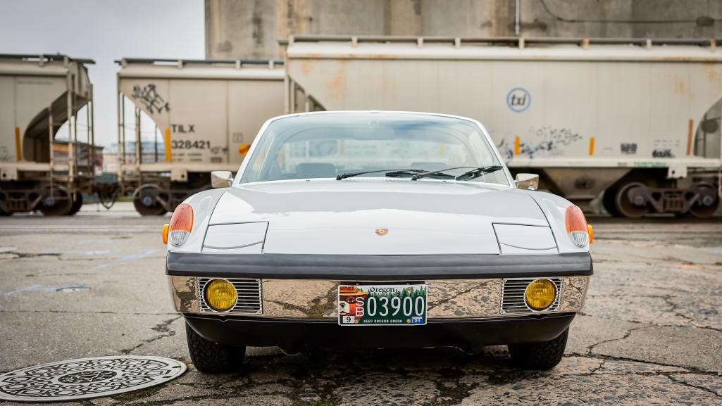

It's been a few months since I installed my PMB Performance 914-6 GT front hood prop rod.
Thought I'd share as it's a very slick replica of the original and a "must have" in my mind for those that have lightweight hoods.
Here's the installed product in my car:

The best thing about quality fiberglass hoods (like Getty) is that you can't tell by looking if they are fiberglass or steel.

The gaps and alignment were that good. Very little modification to the lids was necessary.
