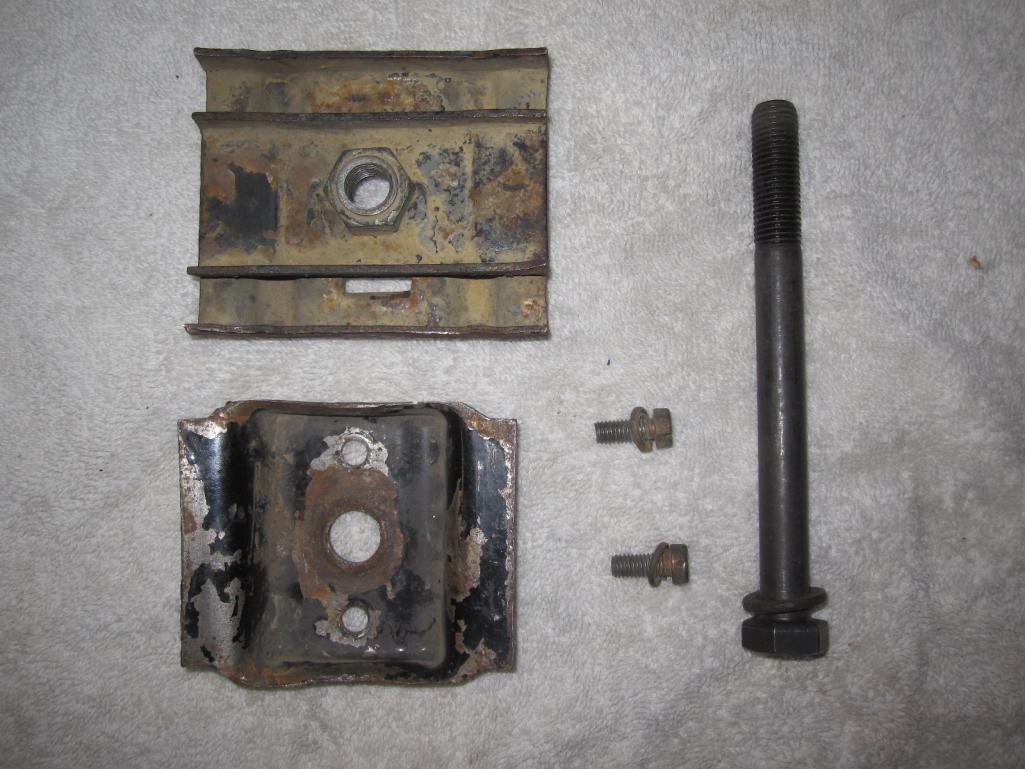

any chance of seeing a few pics 'as received'..... before install ?

Are these other parts necessery / provided / available ?
Requires a high strength bolt too. ( 10.9 , 112mm shouldred shaft, 12 x 1.5 )

QUOTE(rgalla9146 @ Feb 15 2021, 11:03 PM) *
yes

The skill for fabricating the chassis part and the engine part is obvious.
Are the two plates to complete the set too much to ask ?
Am I foolish for asking ?
I think mcmark/maddog used and adaptor with the wevo mount because a couple years ago, the oem mounts were not being made, at least not at reasonable pricing. Now uro and porsche have the mounts available as low as $120. It looks like it would be pretty easy to reproduce the two mount plates and like superhawk, I'd like to use the oem rubber mount.
Those plates would be awesome. If I had samples I would have. Bunch made.
